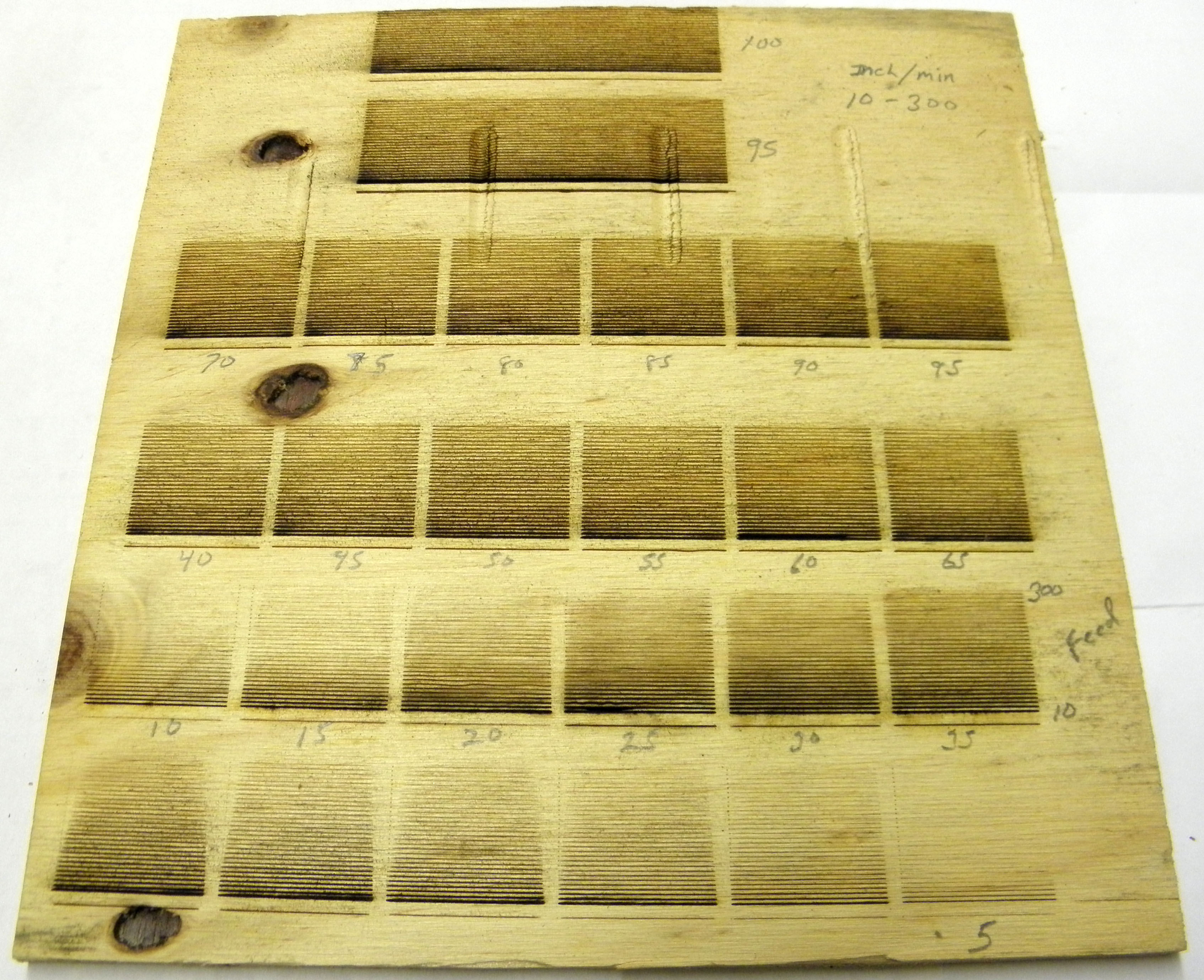

Here is a photo of my recent test of power and feeds on a Luan plywood board.
I started off at 5% power output with each line being 10" to 300" per minute @10" feed change per line
1" long the top two are 3" long.
Minimum on my K40 was set to 52 and max 100, I still need to build a boost circuit to get to the 5+ volts.
So only really getting about 80% out of the tube for power at this time.
This was a good way for me to test the physical results, the K40 ma meter and the Oscilloscope (showing PWM output).
Once I found my minimum (52) in my case that takes out the coning shape you see in the bottom row (notice the length of lines truncated as the feed increased)
I incrementally increase power for each test block sequence.
Then use a single edge razor blade to gauge depths.
My intentions are to write a routine to do this for each material I might want to use.

Re: Laser Stories Board

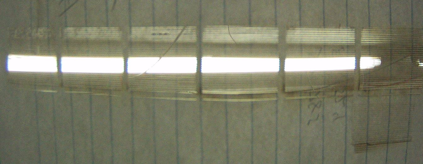

Here is a photo of me showing the results through a piece if note paper I tested on. (looking at a florescent lamp)

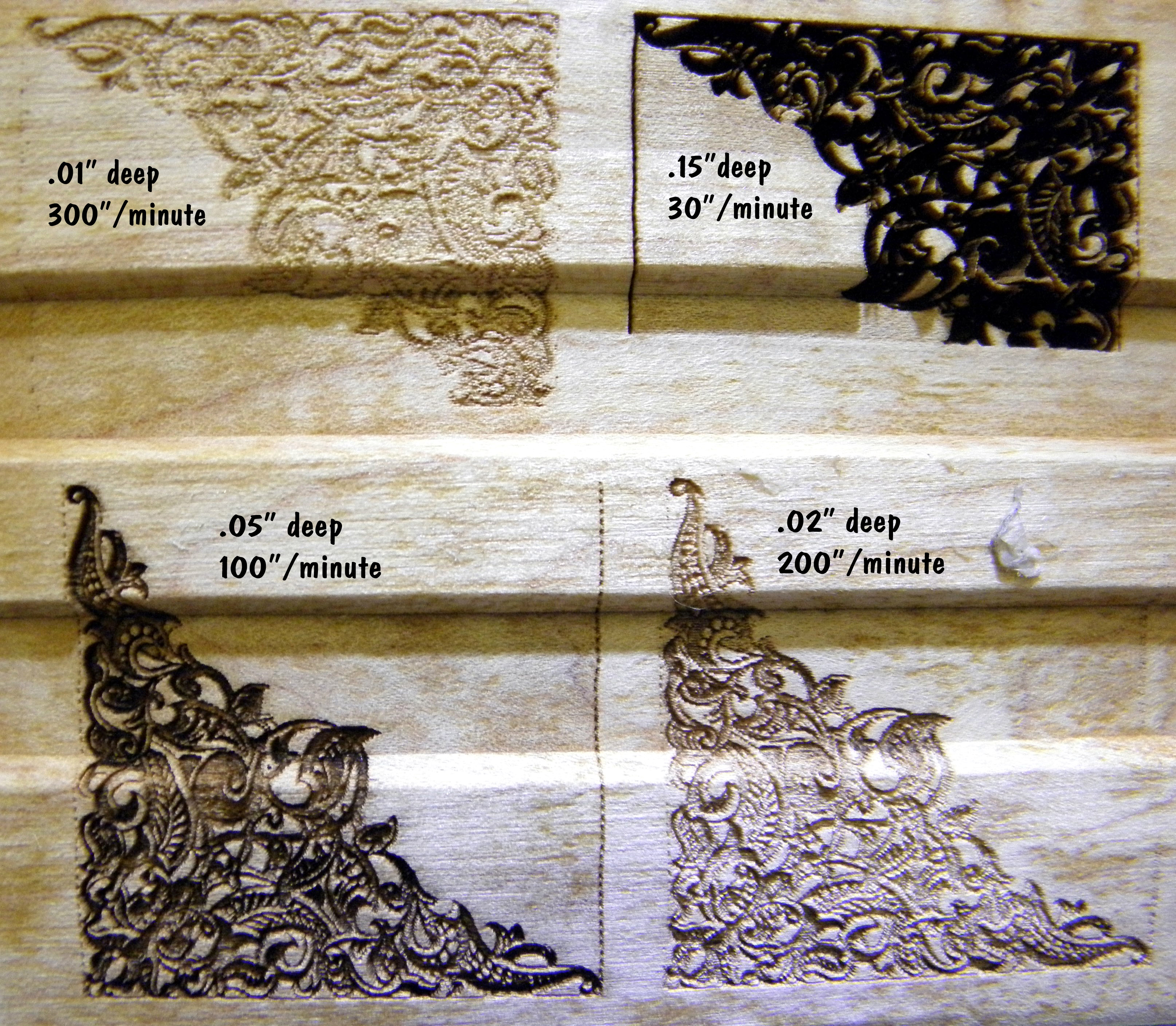

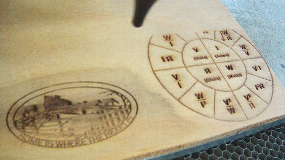

Couple of raster burn tests
and then a poor photo of a vector burn

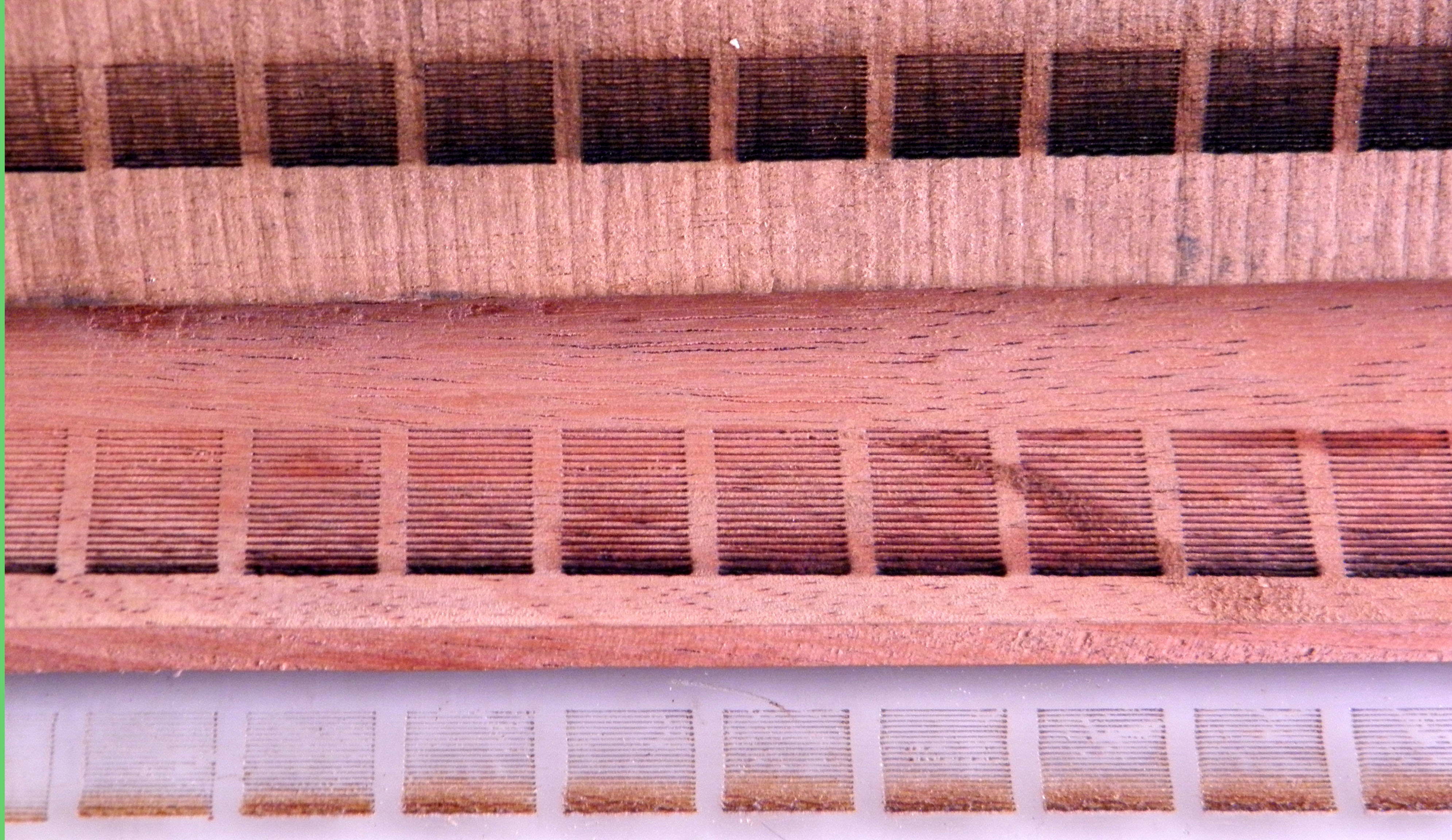

My Initial "Walnut, Teak and Lexan" test with the following script in the MultiLine-MDI fold
from left to right; 10% to 100% power
bottom to top; feed 10 to 200 inches per min.
and an On/Off Mcode script calls for my air assist.
Code: Select all
m3 (start pulse engine)
g20 (set for imperial)
M103 (air blow on)
x=0.4;y=0;z=0;a=0;f=0;p=0;
for( j = 0; j < 10; j+=1 )
p+=10;
GlobalSet("LaserMaxPower",p);
block("MotionStill");
for( k = 0; k < 20; k+=1 )
f+=10;
GlobalSet("Feedrate",f);
Engine.FeedTo(x,y,z,a);
y+=0.03;
x2=(x-0.4);
print("feed= "+f);
Engine.RapidTo(x2,y,z,a);
x+=.5;f=0;y=0;
print("power= "+p + "\t\t x= "+x+"\t\t x2= "+x2);
Engine.RapidTo(x-.4,y,z,a);
m105 (air blow off)
g0x0y0
m30

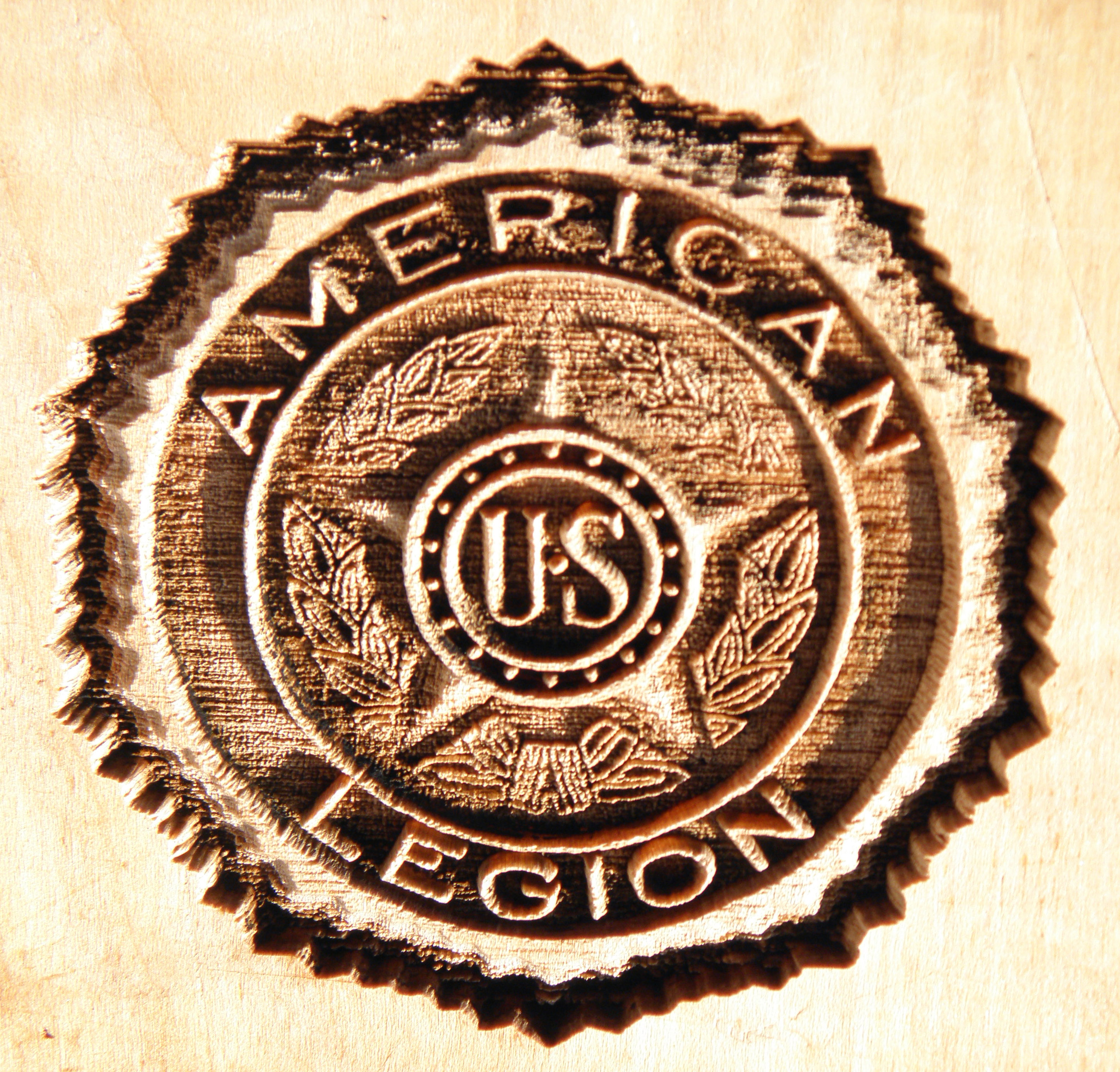

200"/min 90% power
46min 95max
3 passes step down of .03" each pass
3" diameter in Hard Maple
best i can measure on the outside edges is 0.171" deep (so my overall burn was more than i calculated for)
more testing till i find the sweet spots.
total time: I estimate at just over an hour total (I was so impressed, forgot to check timer)
Image was from an ArtCam file I created years ago and cut on my router as a 16" diameter and gift.
46min 95max

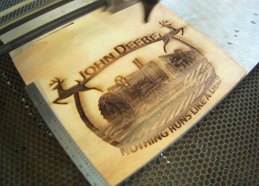

Here is a straight one pass burn.
Augment converted from a color .png file originally a huge tif file that I clipped an area from.
about 5" wide
80% 200"/min
about 5" wide
80% 200"/min

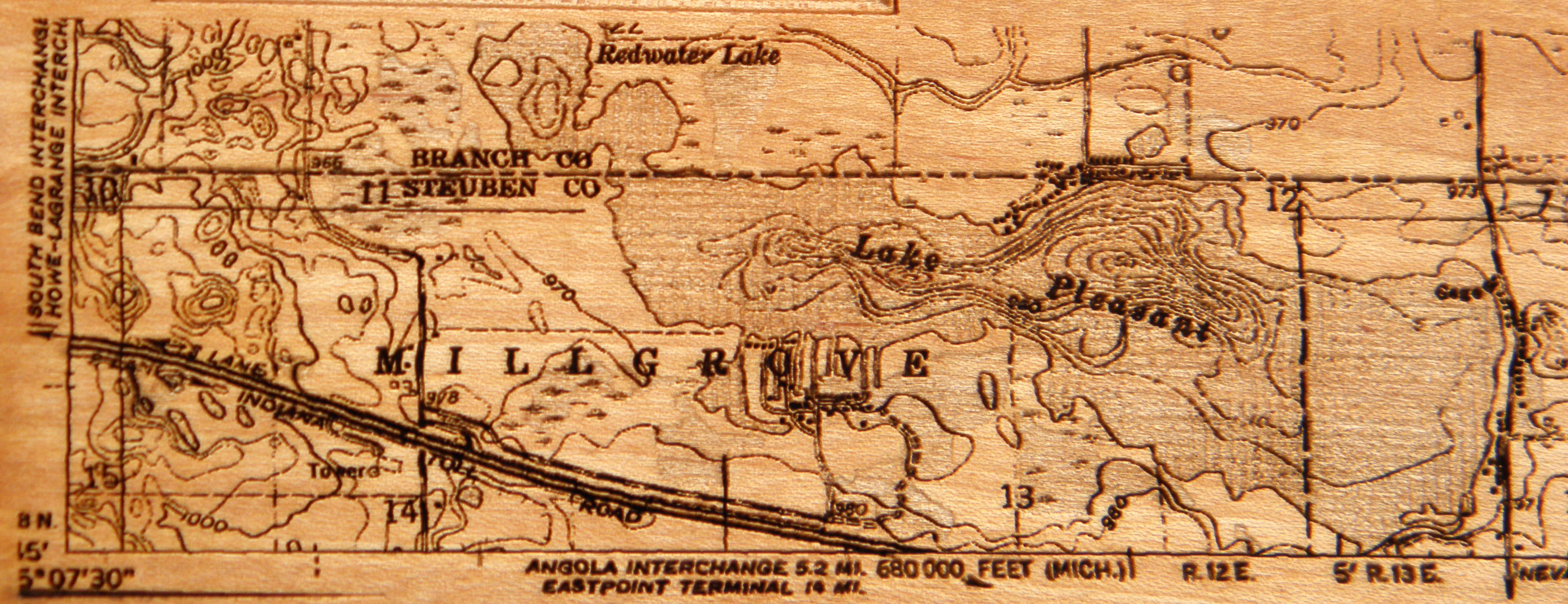

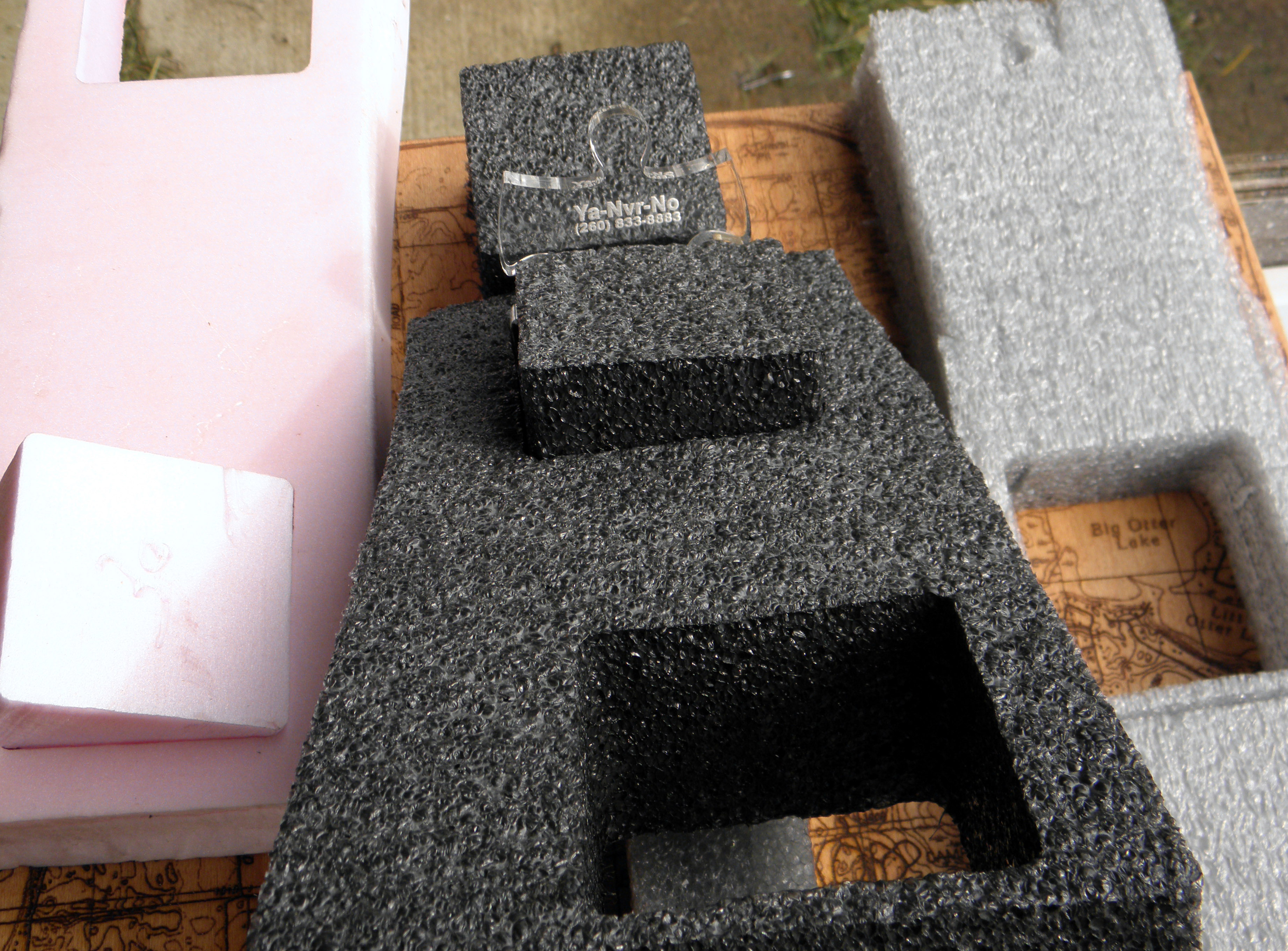

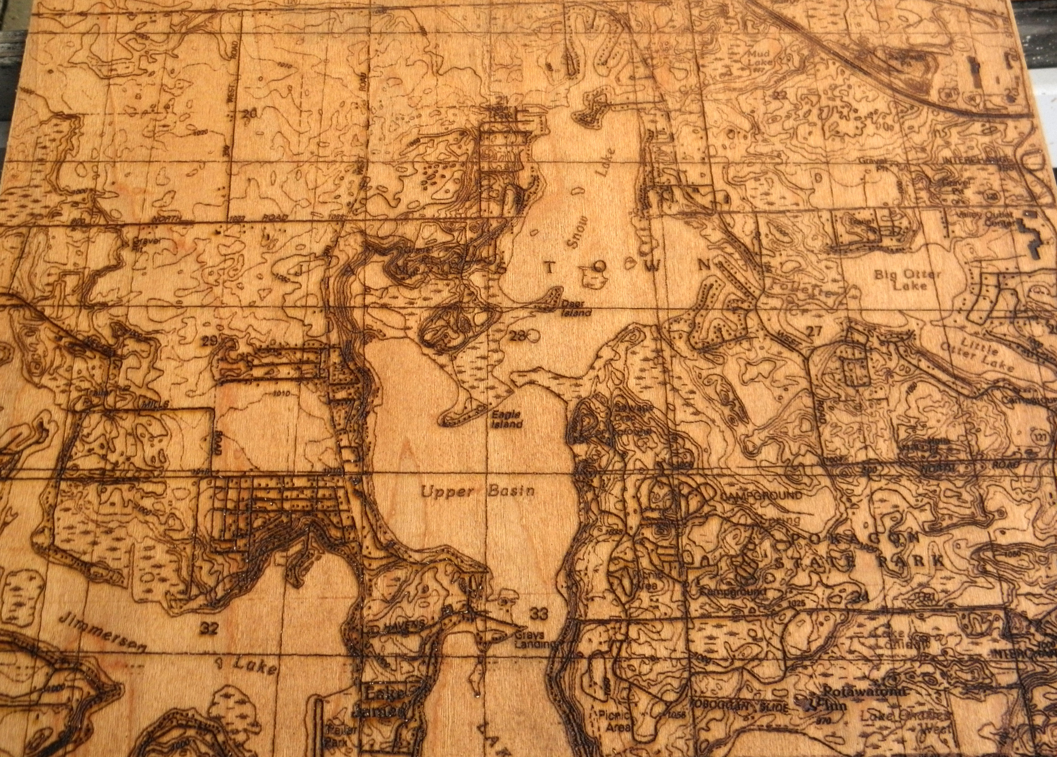

16" x 13" map
testing on clear acrylic, mirrored image from back .008" deep
and then test burning thru three different foams, the black is 55mm thick.
Very impressive!
Is it possible to cut that deep with the K40 in foam?
Always wanted to do that for making boxes with foam for tools or presents.
On my K80 I only have a focal depth of approx. 3-5mm, I think the lens has 2" focal lens.
But I have seen descriptions that the laser makes some kind of self focusing in deep cuts (in the cut gases) and it seems to work when cutting acrylic - it is possible to cut 10mm acrylic with little kerf, but 55mm foam...

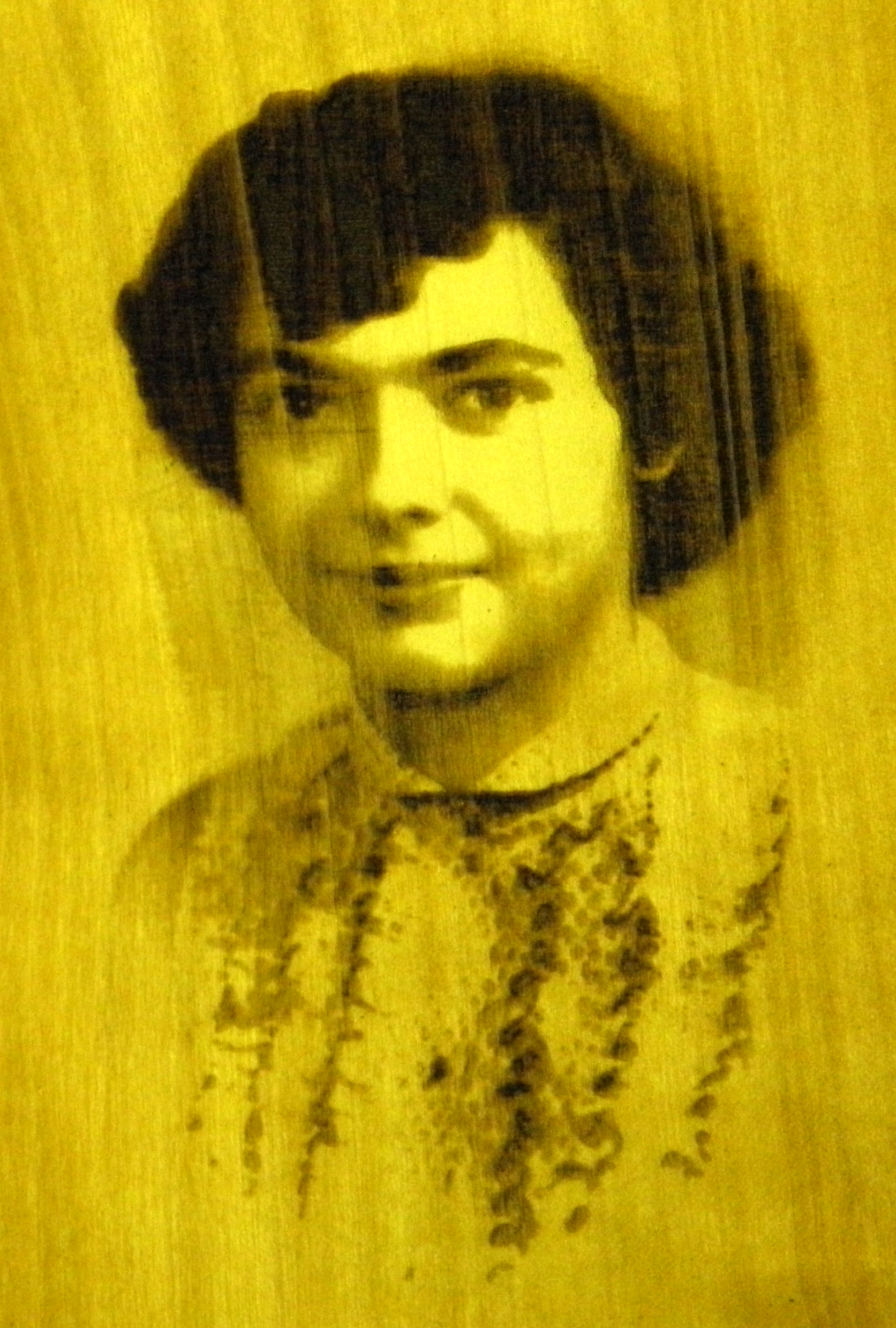

was asked if i could burn an old photo image, so I tired it on a piece of veneer, wiped a little fruit wood stain around most of it.

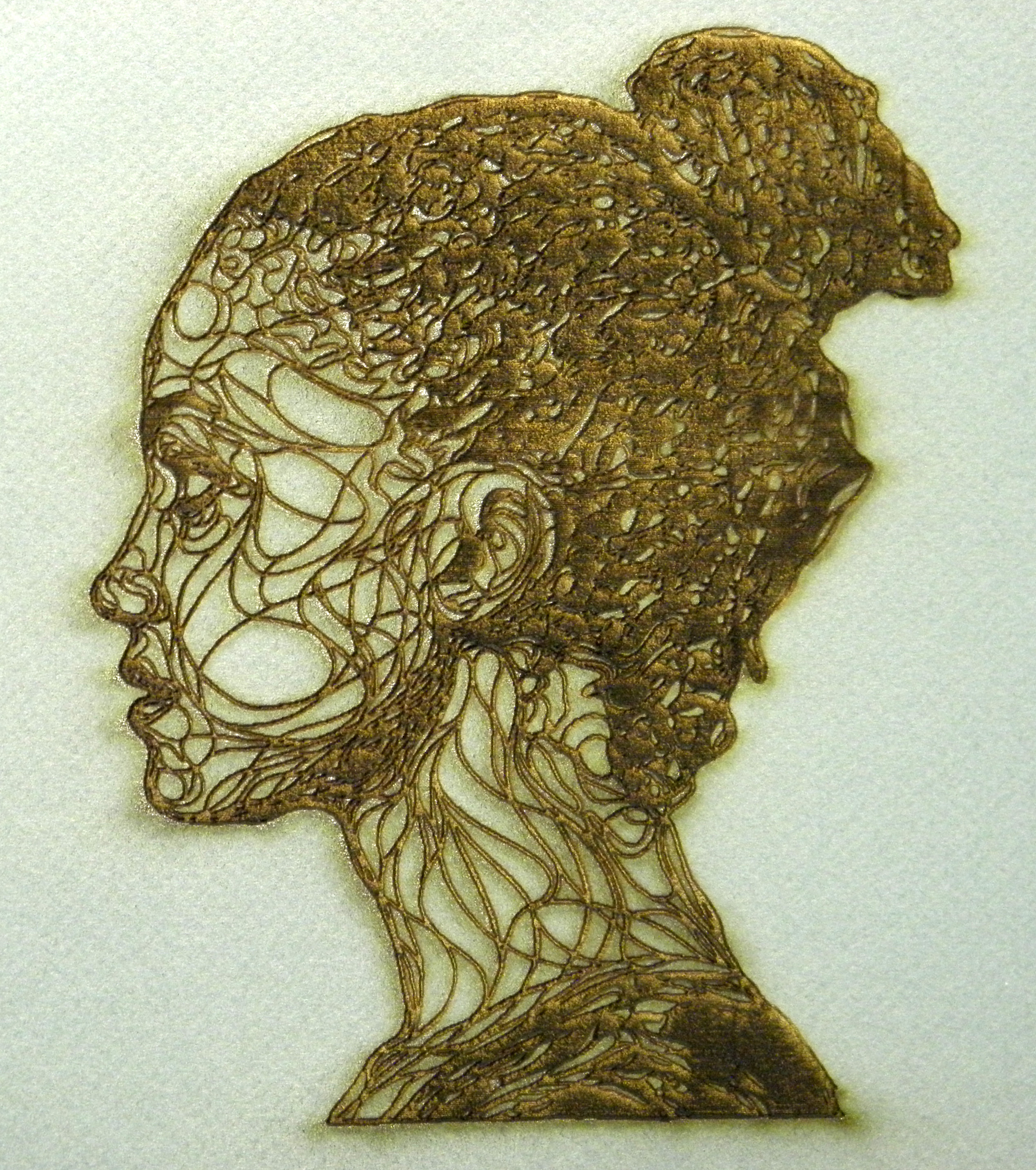

the string art gal was an image I found on the net, altered to a high contrast, then an augment invert, burning on matte board.
Real nice - looks like the photo is printed onto the wood.
