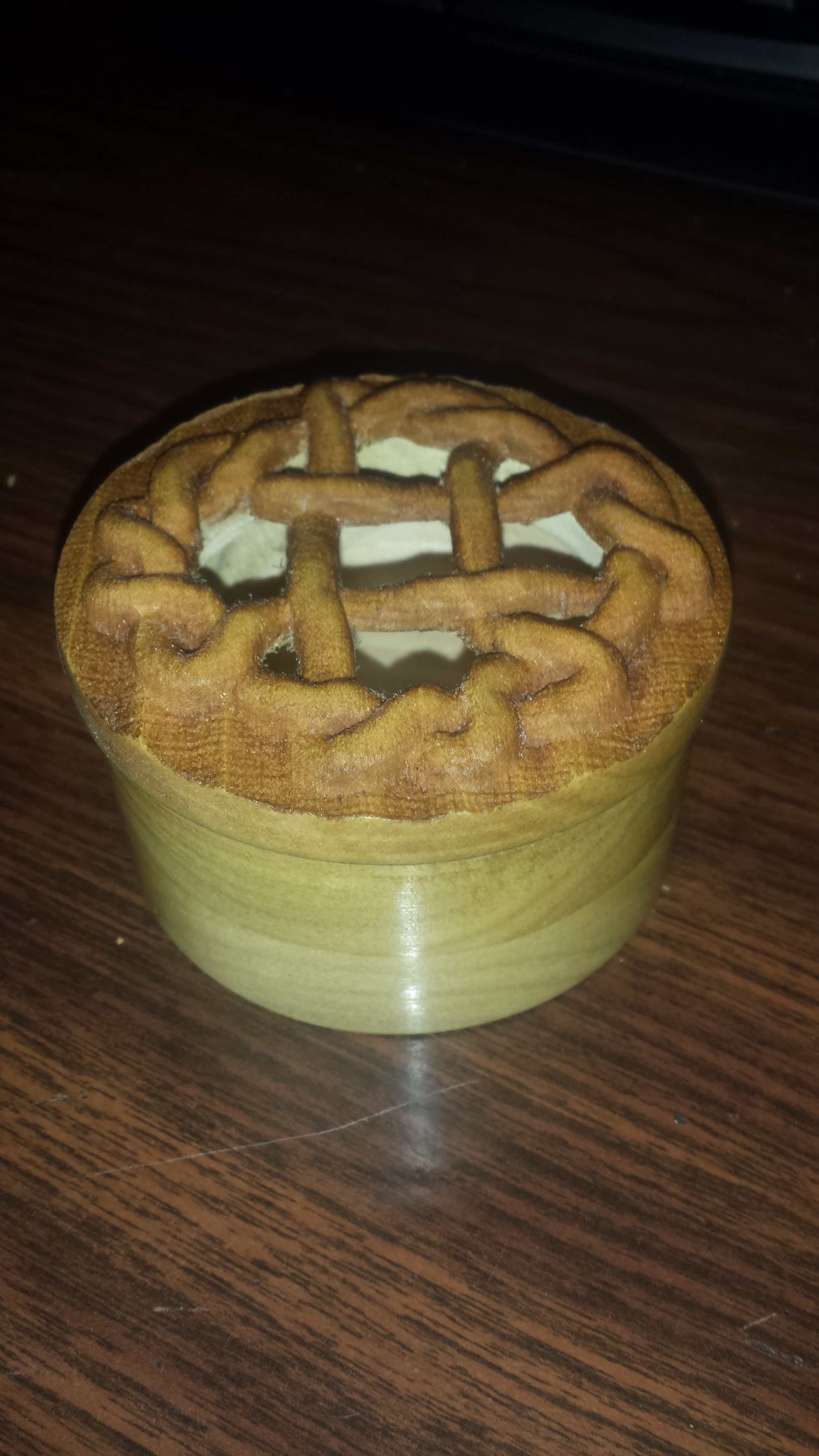

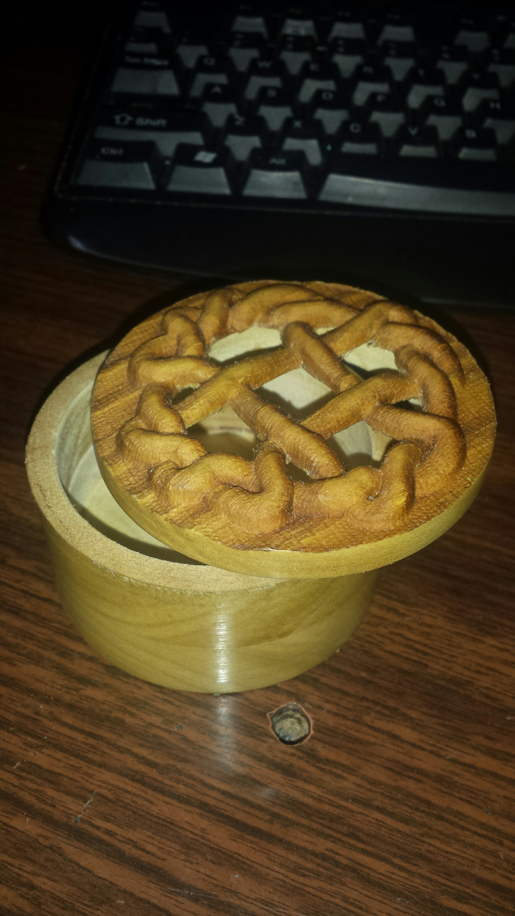

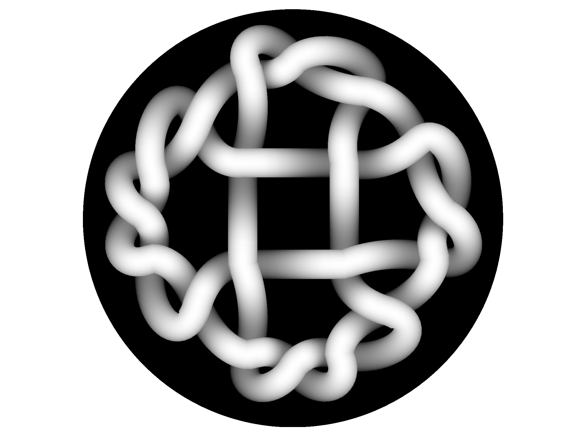

Heres an example celtic fill of a circle I used for making a pinbox this week
as a test of the 3d functions. GreyScale and Celtic output from Vexx, 3d carved in
hardwood by Auggie. Celtic fill should be released in a week or two if anyone
wants to play with such things.

Excellent work.
That pie crust looks almost too good to eat ;D

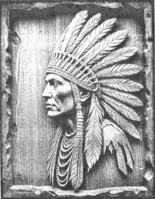

I have spent the last 15 or so years working with CO2 lasers and recently decided to try, as they have improved considerably in recent times, a cheap, Chinese, UV, diode laser. Although the laser is only 5 Watts in true output power it incorporates 4 diodes with an optical system that parallels the 4 rectangular beams into a square pattern which can then be focussed to a spot size of less than 0.08mm. (square with slightly rounded corners). This produces a power density not that far short of a 40 Watt, CO2 laser although the difference in wavelength has a differing effect on some materials.
I have never had the same degree of success as Art when it comes to actual 3D laser engraving but was surprised by how the illusion of 3D can be created.
I lasered this image yesterday on a piece of scrap MDF and when cropped (to emphasize the border / frame) although the work is completely flat the illusion of 3D can, in my opinion, be clearly demonstrated.
OK, this work is not perfect as I altered the laser output power a few times during the scanning process but with a bit of practice, hopefully, I can improve.
Perhaps other laser users may wish to share their experience of grayscale laser engraving ?

Wow, that is very 3d. Well done.
I have an advantage when I do 3d, as Auggie will do it in several layers, raising the Z on each layer.
This keeps the focal spot on plane which is why mine are a bit more defined. It basically see's each
grey color as a layer to be shot. ( OR if one says 10 layers, each 25 grey levels becomes one layer of
exposure. Auggie , on each layer, will shoot at 100% on grey scales lower then the current layer, and 0%
on grey scales above the current layer. This accumulation of depth is a great help in 3d and makes the
laser power less important as depth is an accumulation, rather than a single density shot. I dont know
is whatever your using can do that, I've only seen Auggie do it, but if you can divide your image into say
10 images , each with only that one layers grey ( and previous layers grey output set to zero, with future
layers set to 100% and the table Z rising on each layer , you'll find the 3d punches out better. A 40 watt
can then simulate a hundred watt ( or higher ) more easily.. for engraving 3d anyway..
Nice work though, looks like good depth..
