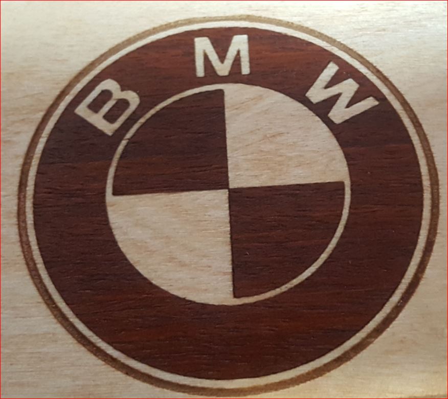

Hi;
Here's the result of a few inlay test examples we come up with over the last few weeks, results are pretty good in my opinion. Thought I'd share with everyone to see.

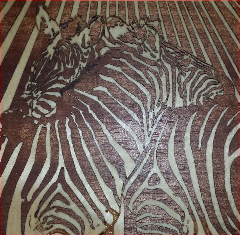

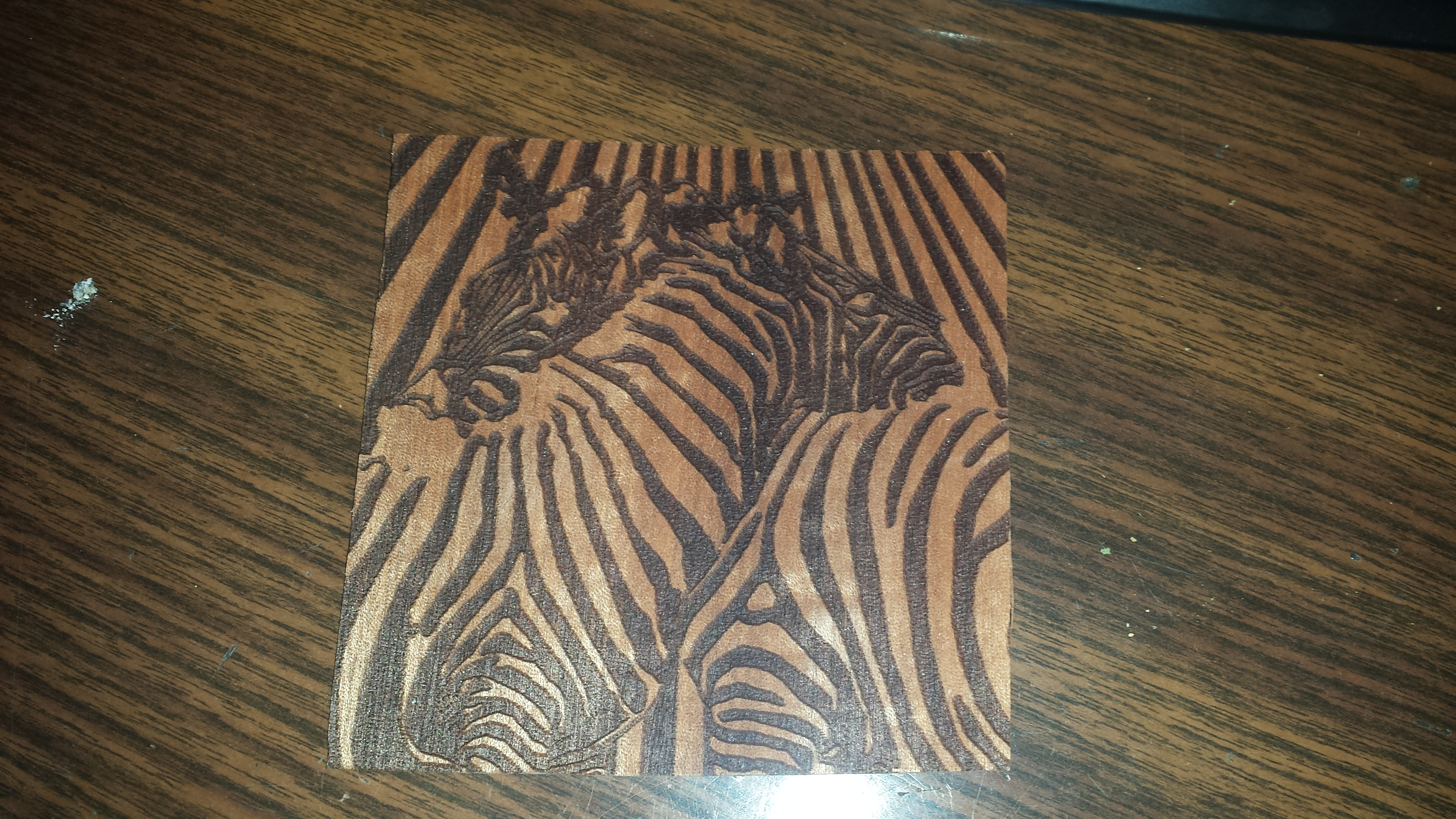

Re: Inlay done with Auggie, Vexx and Gearotic CAD
Mike:
  Before you get the idea we dealt with tweezers and lots of parts, heres how the Zebra was made.
1) Engrave B&W photo of zebras into wood. 12 minutes.
2) Flip and reverse image and burn into a piece if 1mm veneer to 3/4mm deep ( picture shows result).
3) Apply glue and push veneer into wood. Let dry.
4) Sand away 1/4mm of veneer.
