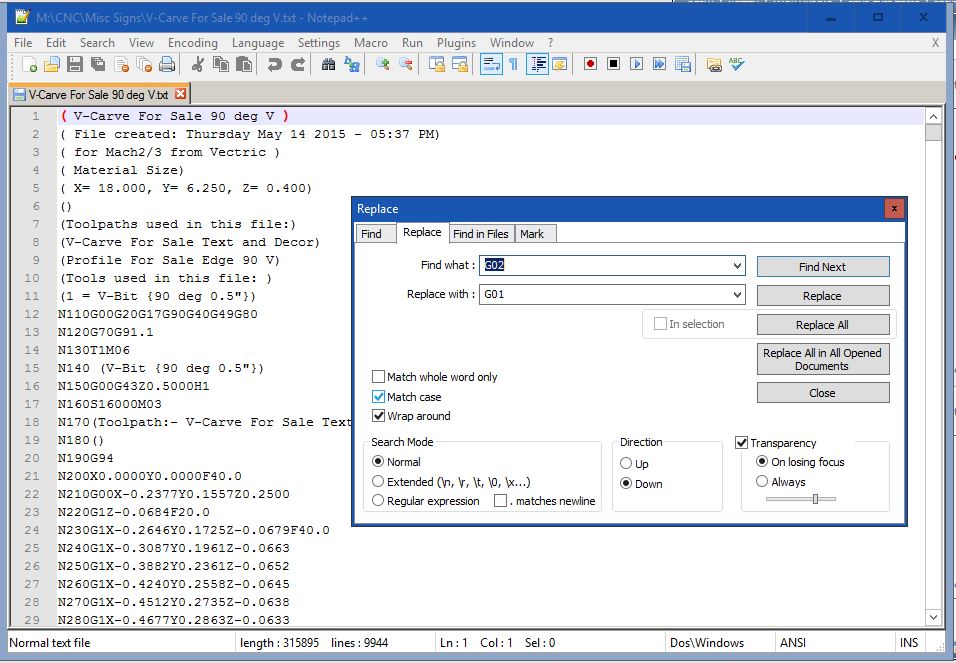

You could load the G-code into Notepad++ and use the find and replace command.
Mark
Re: G02,G03 convert to G01
I dont think that would be practical in this case. A single G3 would require up to hundreds of G1's to replace it
depending on arc length, and resolution of arc segmentation..
  Not a trivial task IMO, something that CAN be done, but hard to add as a command.
