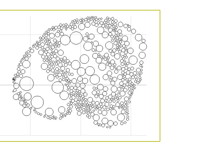

Well, the flourishes work quite well at the moment, but as Yanvrno noted, ( the only guy to have tested them) ,
you just nvrno what your gonna get. You enter a fertilizer for bushiness, and a motif for shape, but the motif is a
control reall yof the outside boundry sizes in a circle packing algorithm, the shapes do get intuitive when you get used to them,
but I wondered.. what if you could point to a photograph to set the motif.
SO Im experimenting with it.. this , for example is th ebasis graph from a photo of a dog.. needs work, but it shows
perhaps photos could set a quick motif for a vines tendencies....
Re: Script+Pokeys
Just so everyone knows what the original image was, turned out pretty good I thought.
Re: Script+Pokeys
you can see what it is
