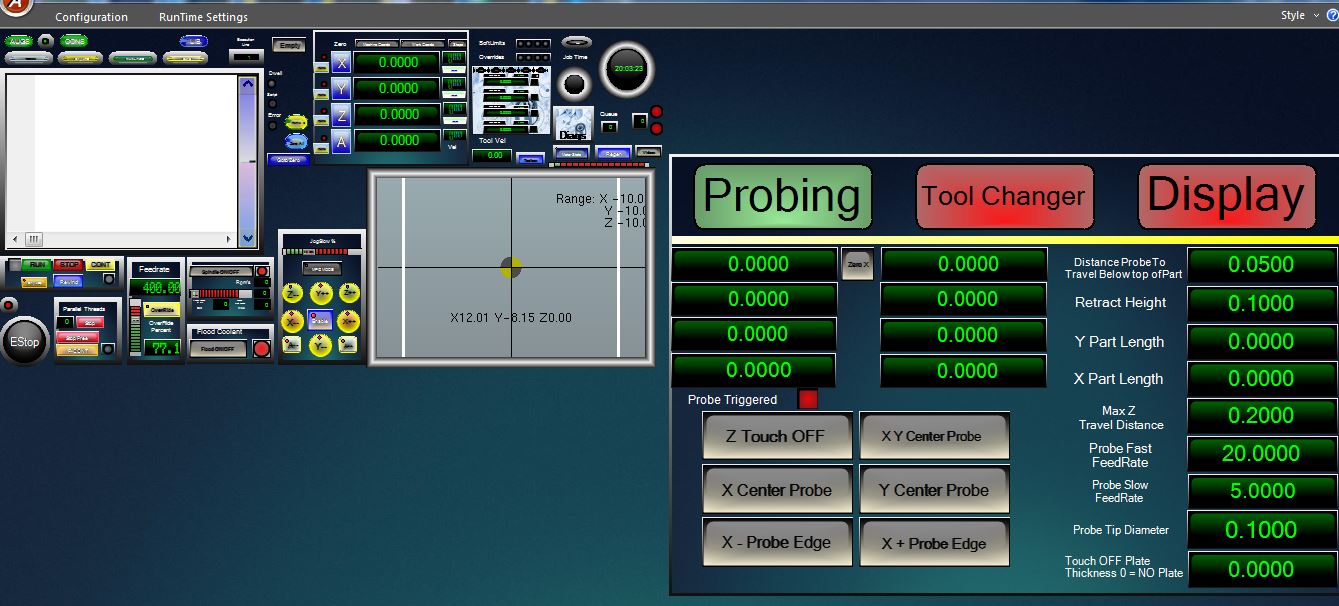

I find formatting the text box shape, size and using \n for line feeds (splits long text lines up) is the biggest control of font size conditions.
Wished the fonts fit the text box a little tighter too, but I've learned ways around it. Sometimes makes it hard with the overlapping during creation and edits, but that's the challenge.
Photo shows how I used your probing panel for an alternative look.
couple of your panels back for you to see.

ordering a new one today, so won't know if the spindle in auggie works till I get the new one bummer.
I made a completely new spindle panel and I ended up with the same results, if I set it up as resizable it looks good on that screen just not on the main screen..
and I and assuming that the text resize doesn't work right now in the fonts ?.
Thanks gary
I tested the motor and I am getting a good ohm reading so I am going with its the controller...
Thanks gary
