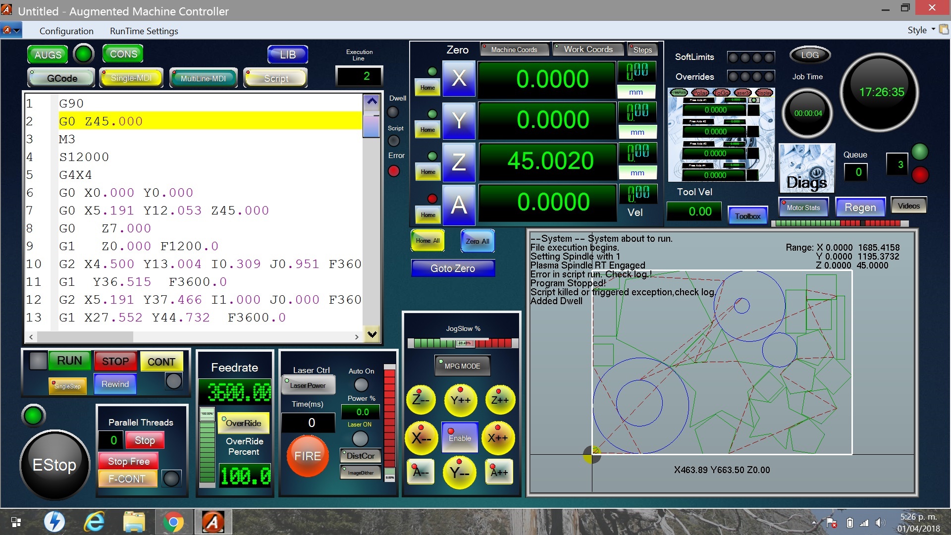

yes sir, I have it activated but when I load the code g and start doing the movement, it locks up when it finds the M3 code. and create a new script only with the option to turn on and off plasma with relay # 3 and it does not work either. Here I leave you the scrip that you wrote and the error that appears when the machine finds the M3

yes sir I did the test and the relay is turned on with: Pokeys1.SetRelay (3,1); and it shuts down with Pokeys1.SetRelay (3,0); .
When I run the G code when I reach the M3, the program turns on the N (3) relay and the system locks and the error LED on the screen turns on. Annex image of the error.

Re: Script/GCode interface
it looks like the G4 X command is the error
G4 is a pause/dwell command followed by a P time value there are some controllers that use an X just not sure Auggie does

As YaNvrNo pointed out the G04X line is an error.
G04 is a dwell but doesnt use X, remove that line and see if the error goes away..

yes sir thank you very much, indeed the error was the code G4. edit it and it works
