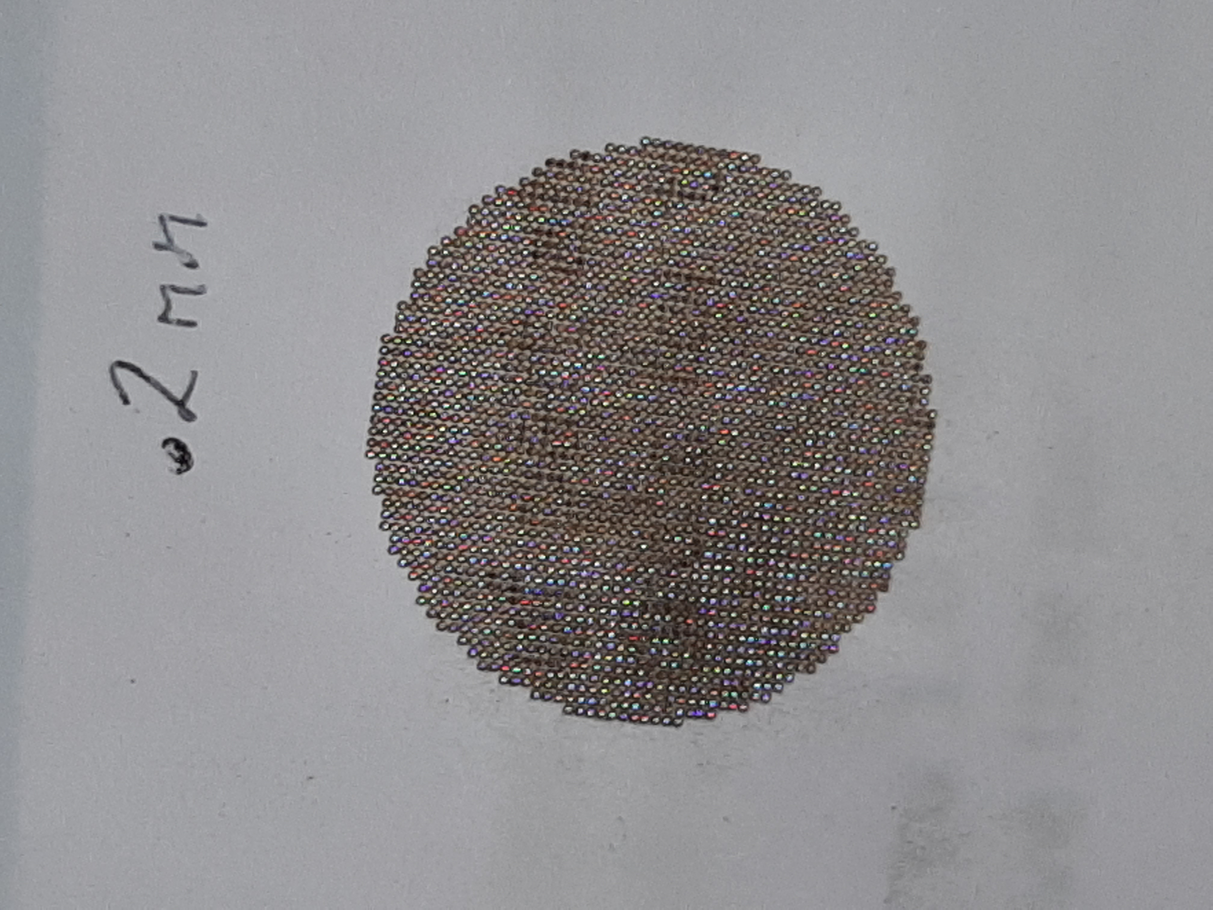

>> read some stuff on the laser's but i'm thinking it would be way to much money for a hobby at last one that can cut metal.
It would be. We who play with lasers generally cut paper or wood. While 3d engraving is fun
with lasers, Im playing with hole sizes in materials as experiments. Here is a photo of one of yesterdays tests
in a piece of normal paper. This has about 2000 holes I think.. not really sure, each is .2mm in diam. The colors
are because the paper is standing against my monitor screen as the photo is taken. It took about 8 minutes I think
to do all the holes. ( In auggie a laser hole is drilled by a modified G04 "G04P.01R95" which means laser a hole
at 10ms long at 95% power. ), I have a PWM reformatter on mine which then reduces the power to a setting
at the laser, these holes were done at 10% power. ) There is a secret module in vexx that produces Gcode for laser
drilling any matrix of holes at any power and time length in any shape and drills them in an order that allows previous
holes to cool down by drilling the furthest next hole next. :)

Hard to see the holes really small. but cool.
The only real thing I could see myself doing with a laser is engraving, could put one of them together cheep enough for plastic or wood, but also running out of room in a two car garage, with two mills a lathe 2 3d printers and all kinds of tools or toys.. wife would not be happy can't park her car in there, anymore stuff may not be able to walk though it ;D
