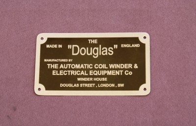

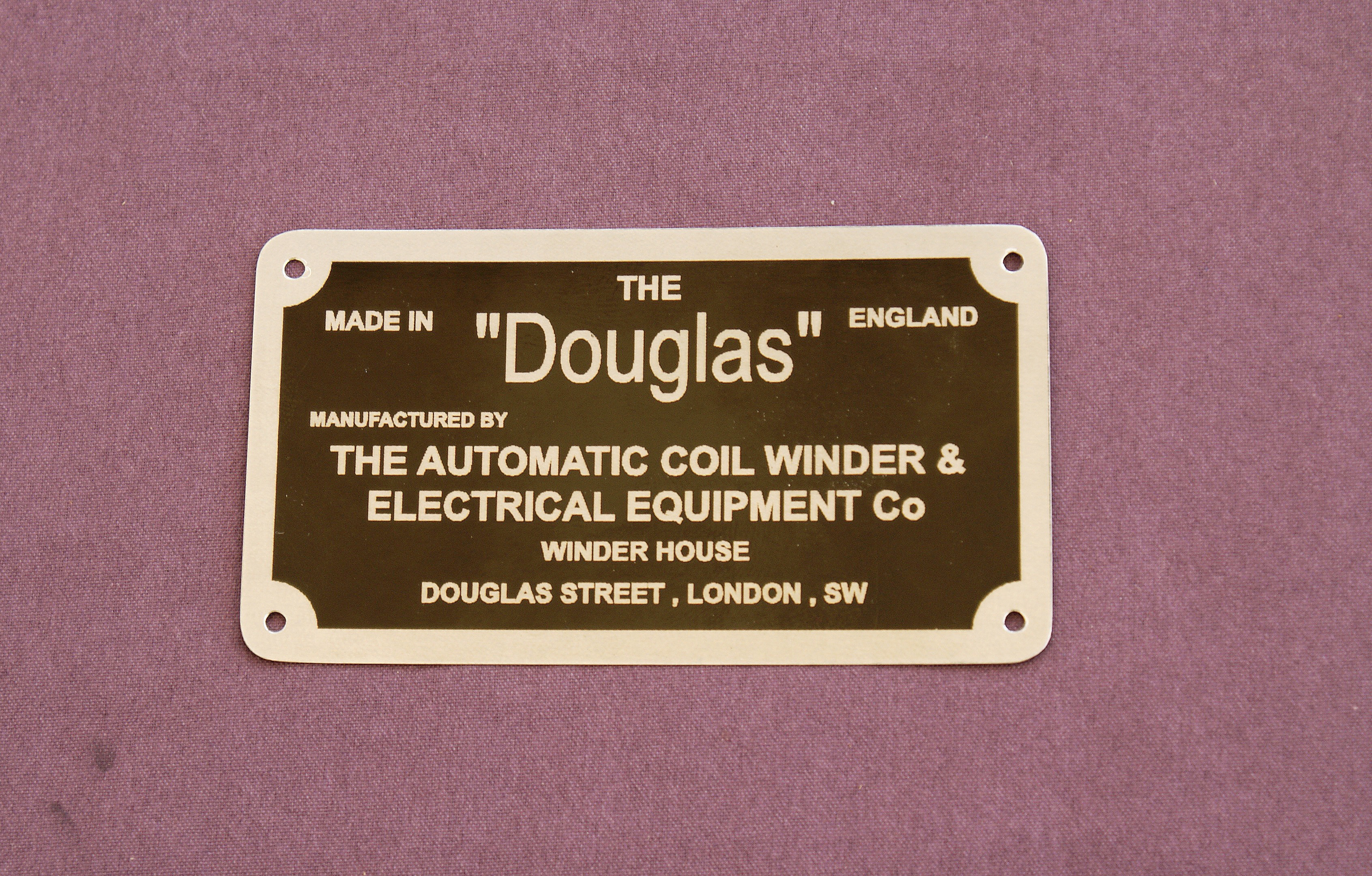

Its off topic, but just as an example this was raster laser engraved using UCCNC and it would not be possible to do it with Mach4.

some ways in the old days when PP was king. Nice engraving by the way...
