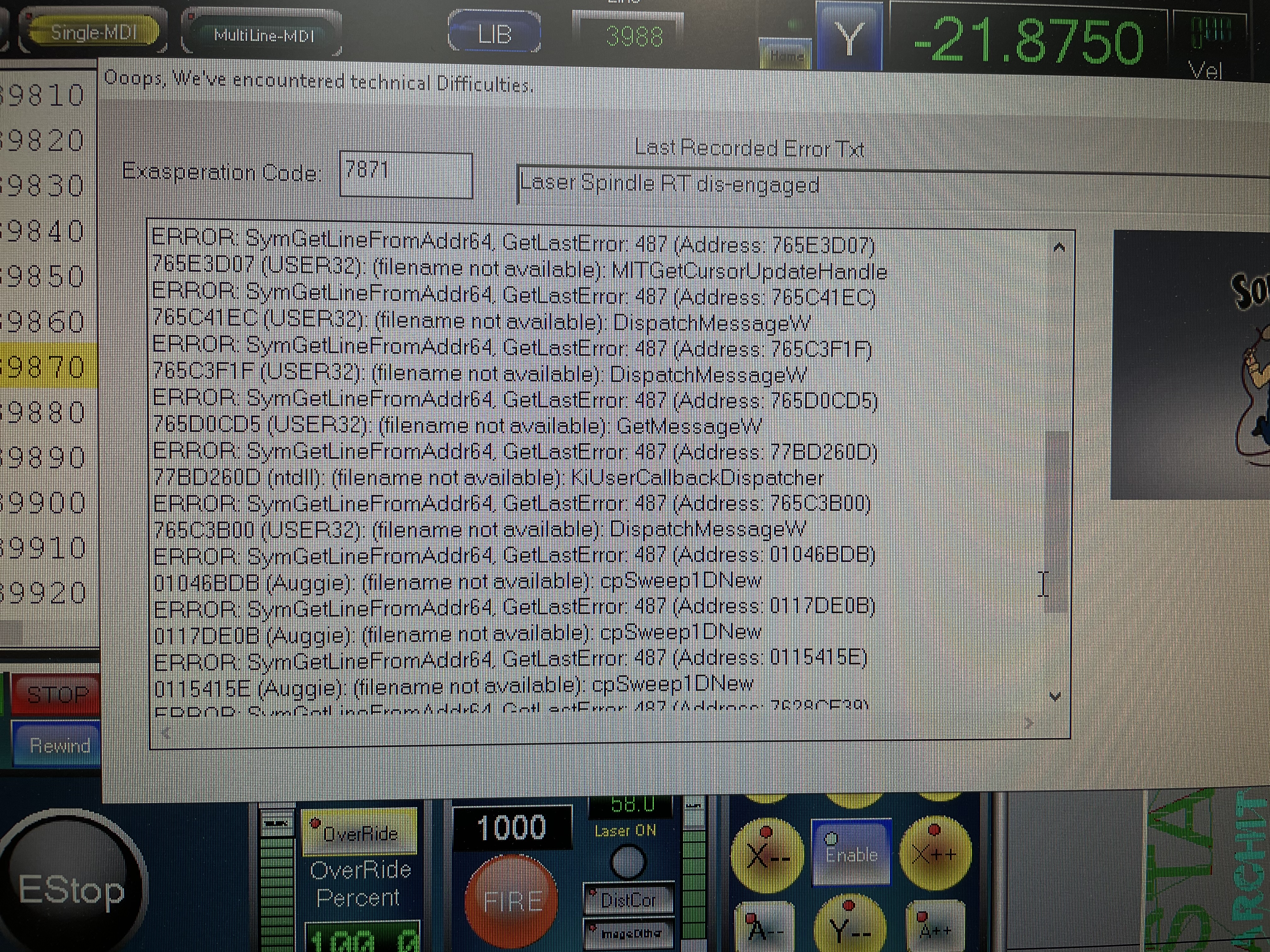

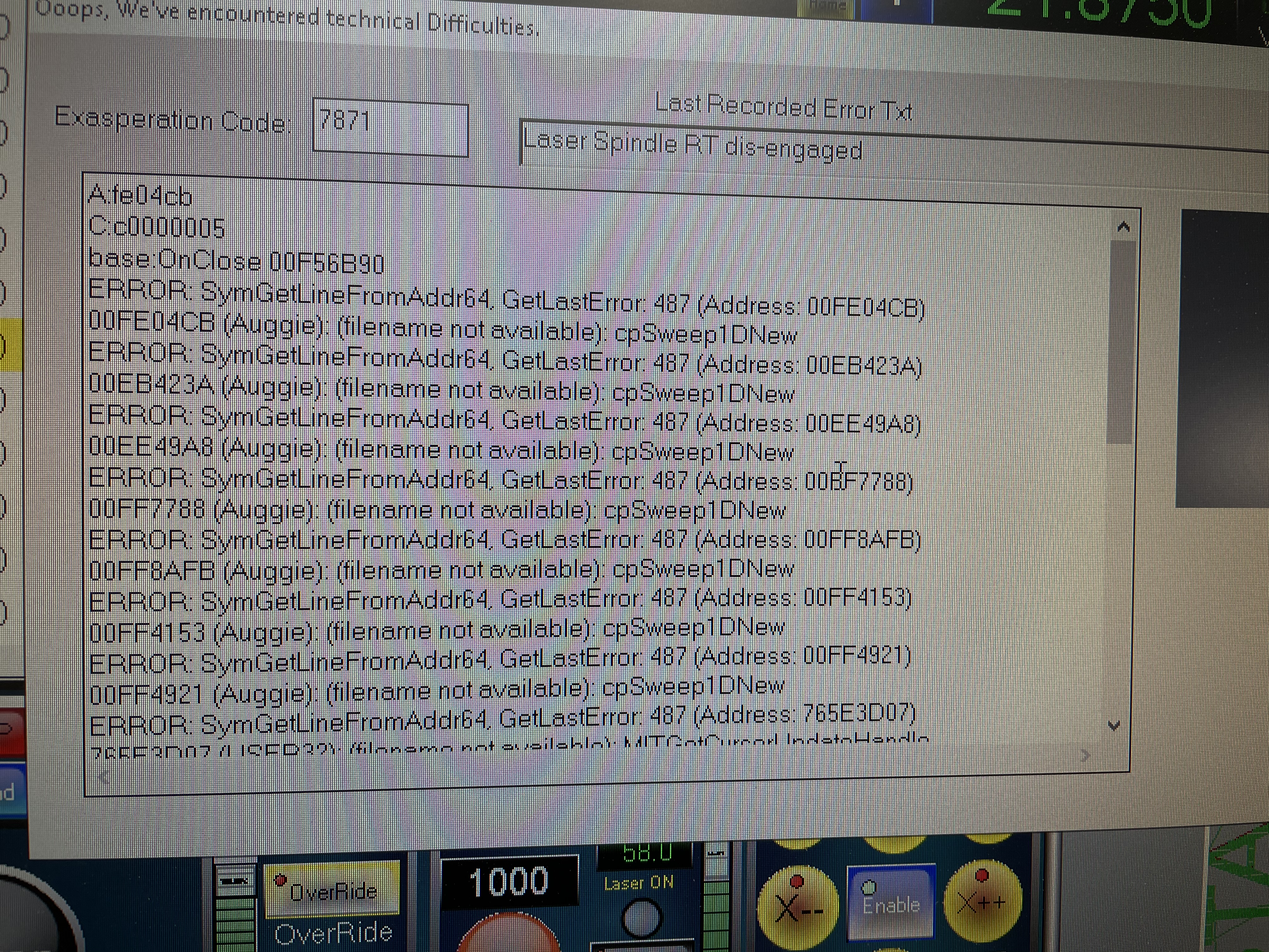

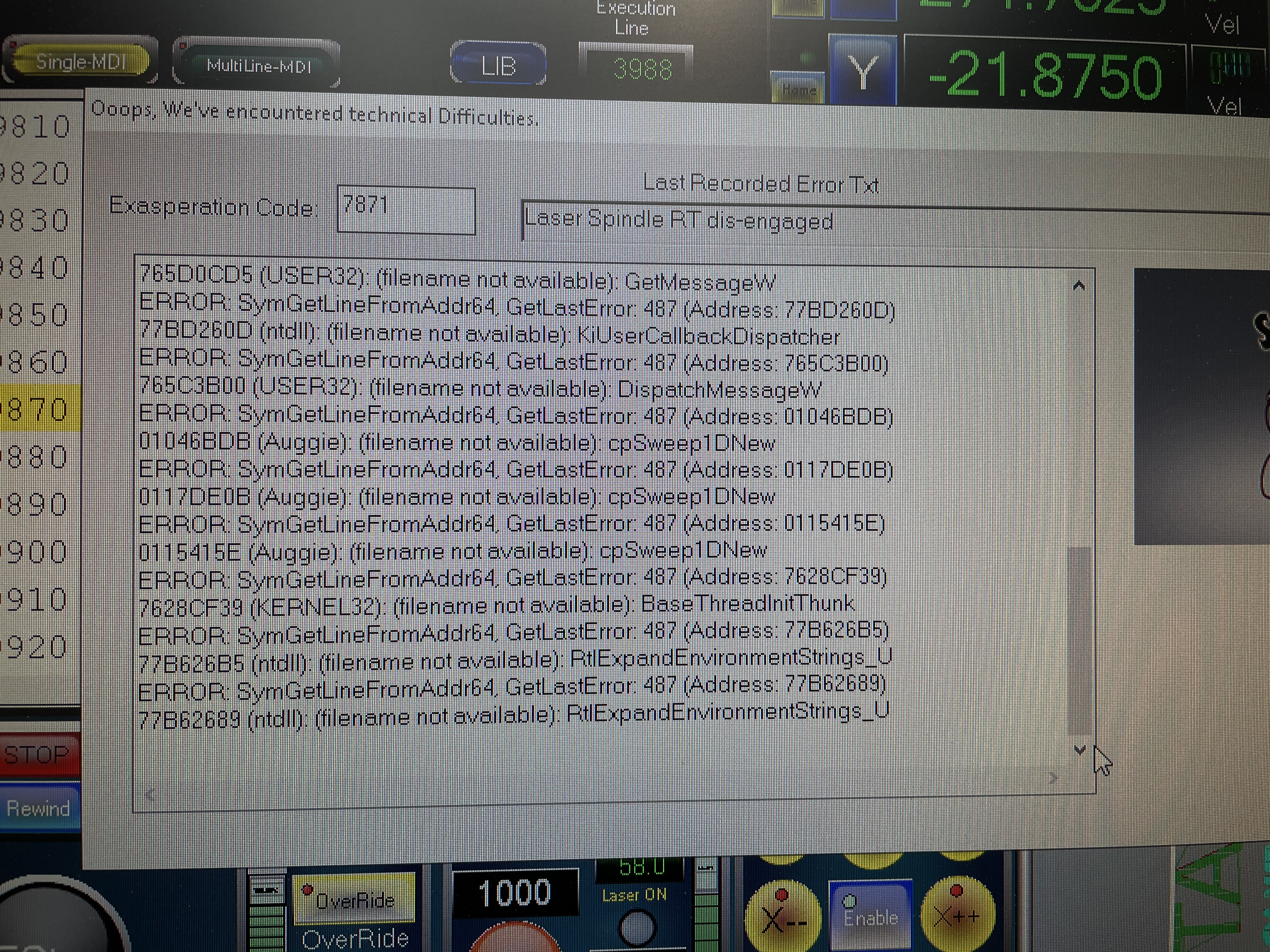

Now suddenly I get an error stop (7871) every time I try to burn. GCode files I burned the day before without any problem do now this stop.
I have no idea where to search as there was no change. I switched off in the evening, started again in the morning and there it was.
Of course I tried several times, restart everything etc. No change.
When the failure happens the machine goes very fast about 20cm to the right on X and then stops.
I attach pictures of the errors.

Hi Roman:
Sorry for the trouble. I know your previous problem was due to something in the lookahead system.
The error your getting is non descript. The error number is a report that the last thing it did was a successful
execution of a script, then it failed.
  Have you tried setting back the lookahead to a low number like say 50 as a test? You may want to turn off the
spindle library to see what the effect is.. I suspect a call is being made that is confusing it and Auggie is
terrible at reporting errors, its so thread busy that finding what actually caused an exception is difficult.
When it suddenly stops runnign like that though, its likely that something in the profile has set to a wonky
number. Do you have any backups of the profile data file that you can copy in?  I do recommend when you
have a working system that you backup the folders so you can revert it if necessary as the profile will
change as it records your last state settings. A Gcode file may have changed a setting to something
bad that its missing.
    We'll have to narrow it down , perhaps by testing MDI codes to see what line it is that causes the trouble,
or what its doing then failing..

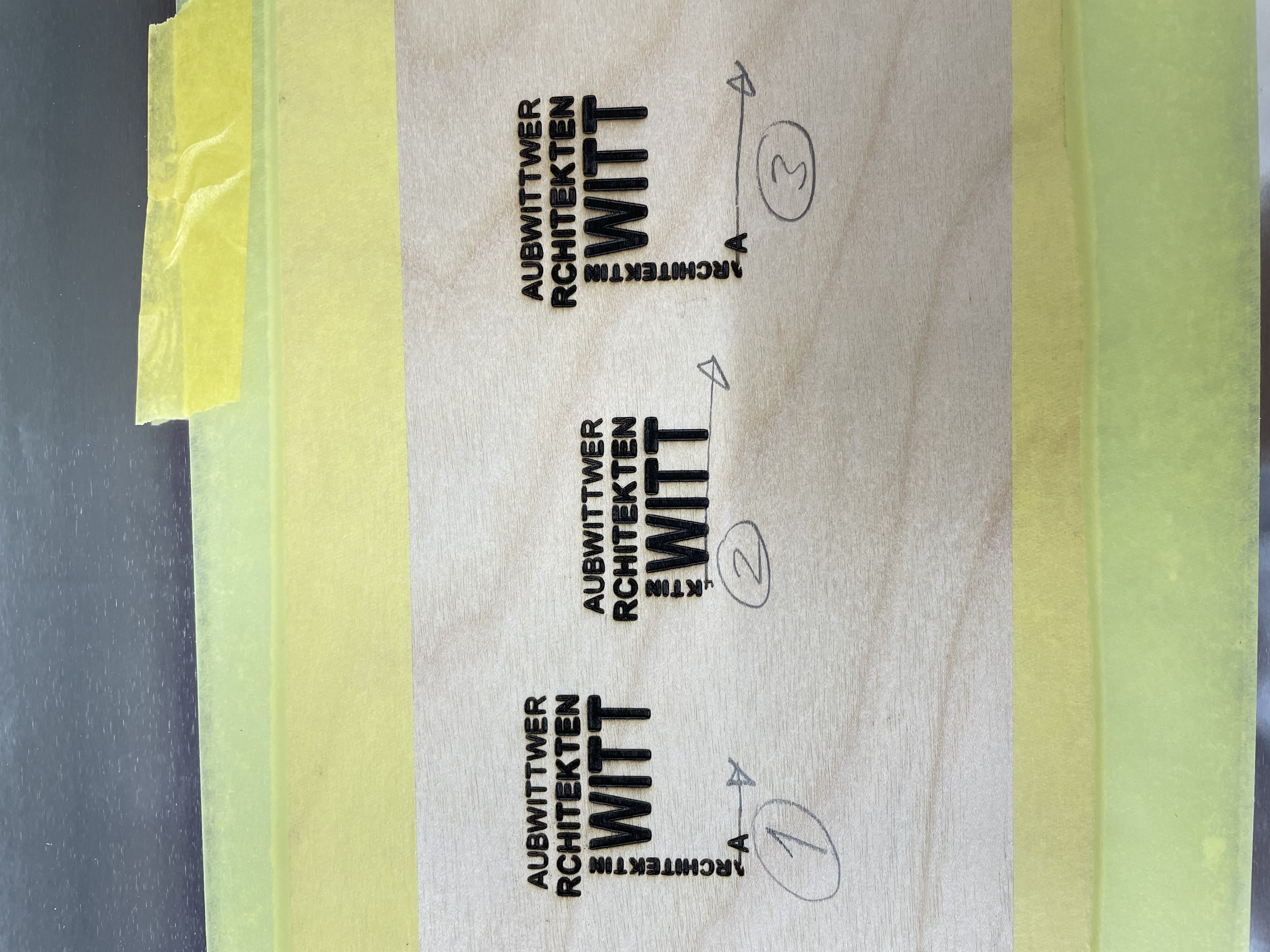

Somehting else I observed now by chance:
I cutted a thin masking foil. On straigt, faster moves the foil was cut just like it should. Courved, slower sections: no cut, just little burn. If I raise the power or lower the spead the curved lines ar cut just right, but the straight ones are overdone, burned.
Means that the linear relationship between actual speed and Auggie-regulated laser power is not good here. Is there a way to influence this?
Best regards
The selection of "DistanceCorr" on the main screen turns on distance correction, which adjusts power to
be equal to the actual motion speed, its meant to remove as much as possible the slowdown in curves and corners
to stop them from burning. Is it on? I think there are a couepl settings as I recall that set a minimum amount
of motion time before firing.

In essence, the dist correction tries to maintain a solid fire power, the way it does this is worth noting though, as it may affect what your doing.
First, the speed is taken for the upcoming ms of motion. This is computed as a percentage of the FULL SPEED request, that is the ultimate feedrate
in effect. Then the power is adjusted to be 0-100% based on the percent of speed to be done.
This is important for this reason.. say you set 15000mm/sec as the feedrate in a curvy program, but it never reaches 15000, say it reaches 5000
at max speed due to the curves and corners. The power will be computed off of a speed of 15000, so the power will be much lower than
one expects. At full speed it would be 1/3rd full power. (I know this doesn't explain your trouble but it may be related as Ill explain).
Corrections on a laser aren't linear typically, each laser differs in just how linear they are, but Auggie expects it to be for this calculation.
If the actual max feedrate isn't close to the set feedrate max, then this nonlinearity is accentuated, made worse by the assumptions.
For example, if a program is running at 30mm/sec in a curve and then at 100mm/s in a line, with a proper max feedrate of 100, then the slower speed will 1/3rd of the max power seen at the 100mm speed. But..if the feedrate is set to 1000mm/sec, then the difference between the 100mm segment and the 30mm/s segment will be very small. (Because as a function of percentage the difference of 70mm/s is only about 7 percent of the total speed curve.
When I'm being picky, I run the program in the air to see just how fast the program gets at max speed. I then set feedrate to there, or lower, and the lower the set feedrate is, the better the speed correction works.
This is nonintuitive, but the math problem is one too many unknowns for the speed/power equation, so the feedrate setting is assumed to be
the actual max speed , so if its off, the distance correction gets off by a percentage.
Film cutting in particular can be very sensitive to power levels, where wood or plastic may not well see a 5% variation,
films of many types will react very non linearly to power. Try varying the feedrate lower ( and power of course ) to see if this smooths out the differences. The usual problem with distance correction is a blanked corner, this is due to the next ms of speed creating a power level way too
low to cut. (that nonlinear problem I mentioned.), In the settings you can select a minimum for the power calc to aid in that.

I always do an 'air cut' to estimate the maximum effektive feedrate achieveable for the job, bacause you explained and recommended this earlier here in the forum.
So this is not causing the effect. Regarding the foil - and if I think about it - you are of course right: it either melts somwhat on the surface or then (likely suddenly) cuts through. Not linear but binary, so to say. So I do what you said and try slower but also with less power and/or set the minimum in the settings to something above zero.
