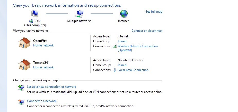

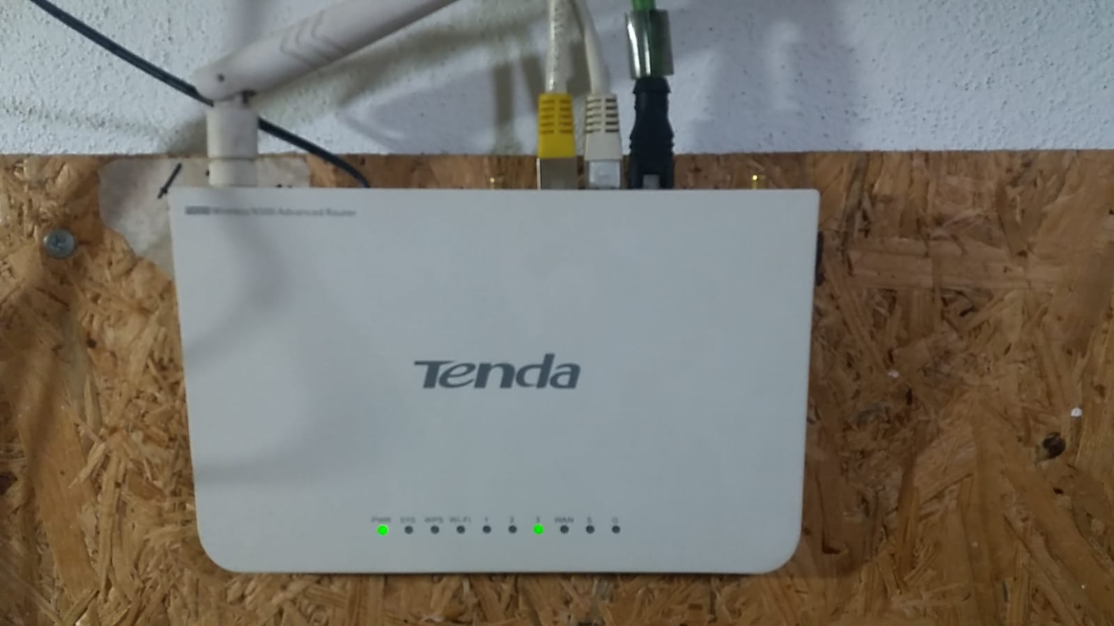

I got some problem when i start , also randomly getting a big lag like laser stop for almost 1 secMarkW wrote: Who knows who else may run into this type of situation.
Mark
at random interval of 30 sec . If you engrave something is pointless will destroy
you engrave . For cutting is just annoing.
I solve it putting rule on my network in IPconfig and i change the original to openwrt firmware
on that router used as a switch . That router connect only pokeys , my pc and camera . Nothing else.
And i never get that problem again.
Maybe help
bobby
