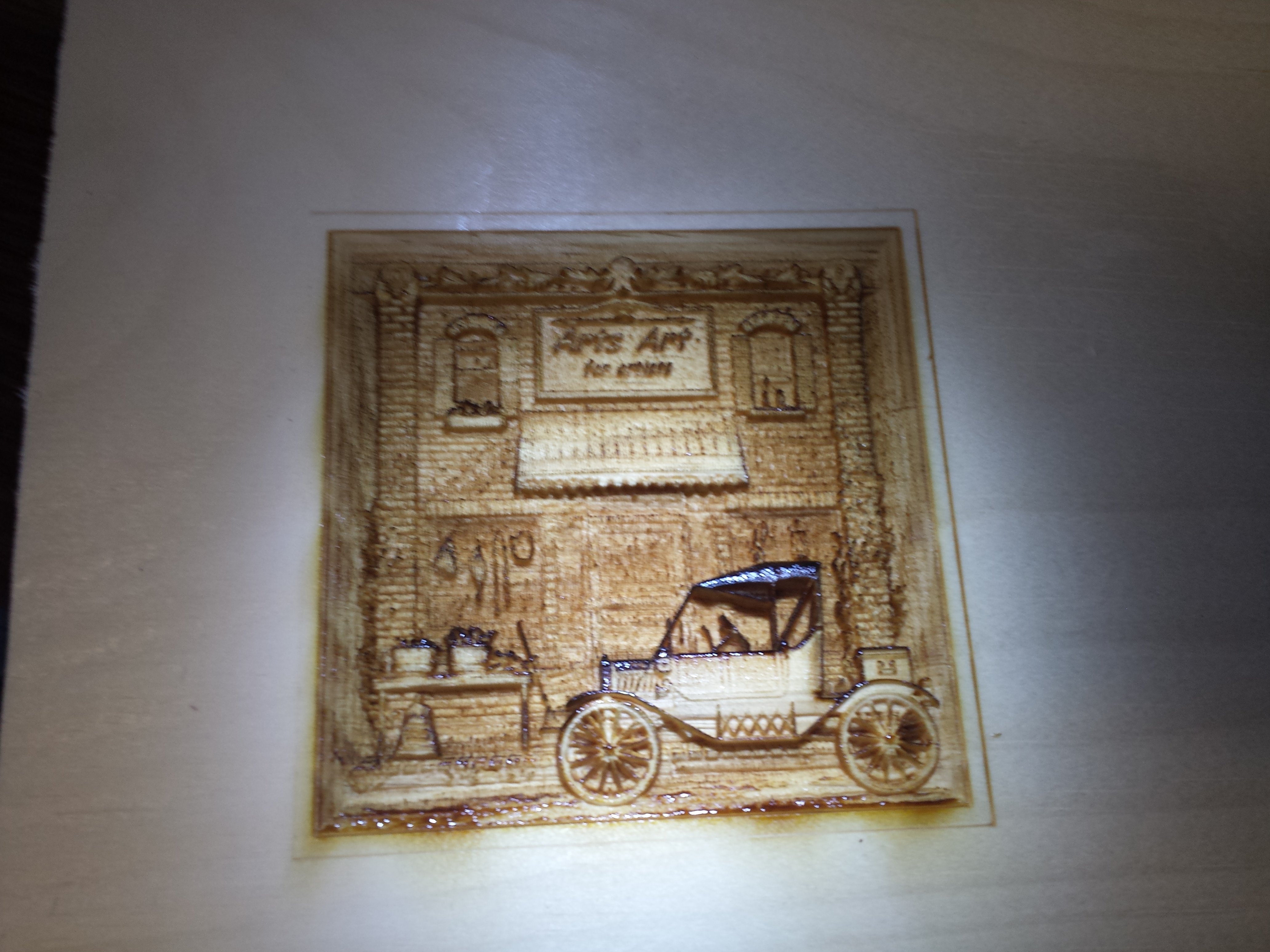

  My 10 watt laser ( cartesion table) did the following cut .. as an example of what a 10 watt can do
with all corrections and doing photo engraving.

  If your into laser engraving, have lower power or wish to try 3d, I suggest you do
some experiments with 3d engraving. It can help even in 2d really, so setting 3d
multipass with a shallow depth can help with photos as well. Get used to the extra
menu under the special DRO's tab which has DRO's for pass, number of passes,
and Z motion per pass. This mode doesnt simple repeat each pass, it calculates
the total laser energy per pixel and ensures it totals to the correct grey scaled
average per pixel of density. SO if you request 5 passes, dont be surprised if
it looks very bad and strange in pass 1, 2, or 3, the average has to build. You set
your power so the first pass doesnt burn too much( or at all), as the "darkest black" in the
image will get full slider power each of the 5 passes. The 127 ( or middle grey )
will get full power for 2 passes, and then 1/2 power on the 3rd pass and no power
on passes 4 or 5. ( for a total of 1/2 slide power over 5 passes. ). My laser has enough
power I can set it to a point where it doesnt burn at full speed, but removes a
thin layer of wood cleanly, so in multi-pass it just gets deeper each pass where
it must.
Sorry for the verbosity, figured Id do an archival explanation of this function,
I've found it the most fun to play with as it makes my 10 watt laser put out
engravings I've only seen 100 watt lasers to be capable of. There seems to exist
in most lasers a speed at which a full power output will not burn, but only remove
wood or other material cleanly. Finding that speed I have found to be a great
move forward in doing 3d depth engravings. In normal black/white photos you want
to find a speed/power where full speed at full power leaves a black line. To find it
I simple use a test piece of wood, set my slider, do a single line MDI of G1X100
and see if it burned, set the slider for power to just before it does.
  When I find that speed in the material I want to 3d burn, I measure the depth
of the removed material from that test, that is the depth per pass you will request
for auggie to put out the 3d Gcode. Multiply that depth by the total depth you wish
to get and it works amazingly well in many more linear materials.  So some lasers
may have a .1mm per pass, where I use up to 1-2mm per pass on mine. Get it right
and youll get the same engraving I get at 50 watts, just more passes if
lower power or fewer if higher.
