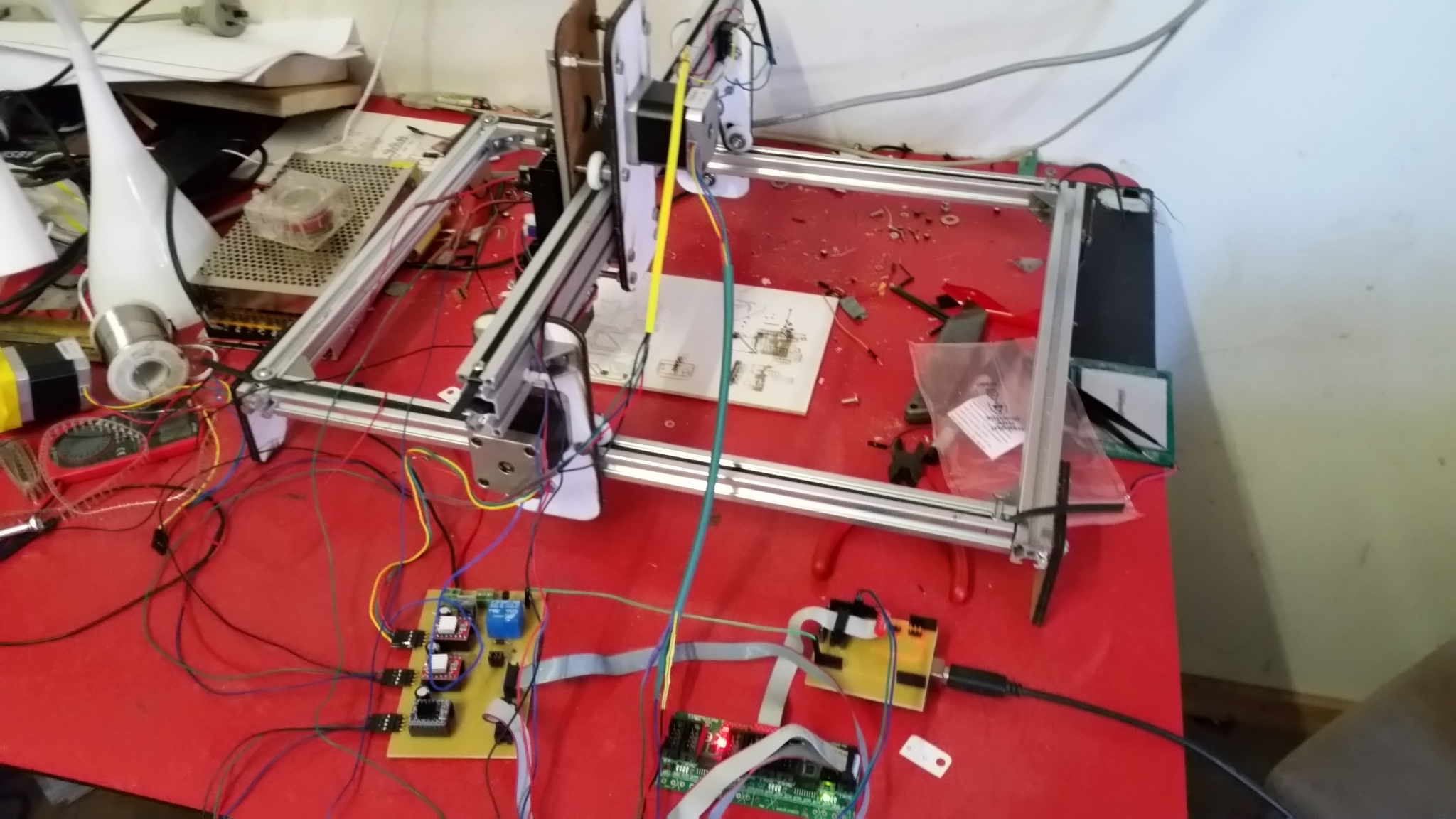

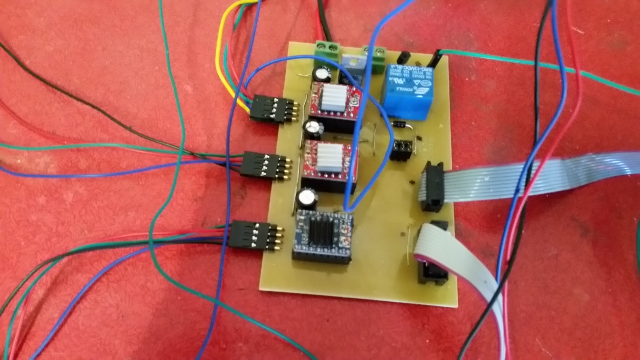

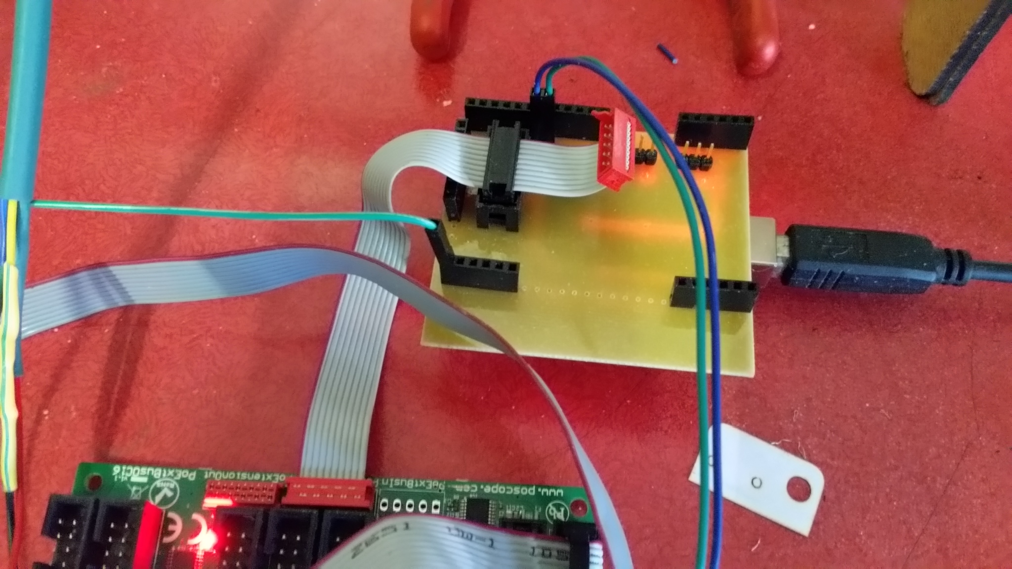

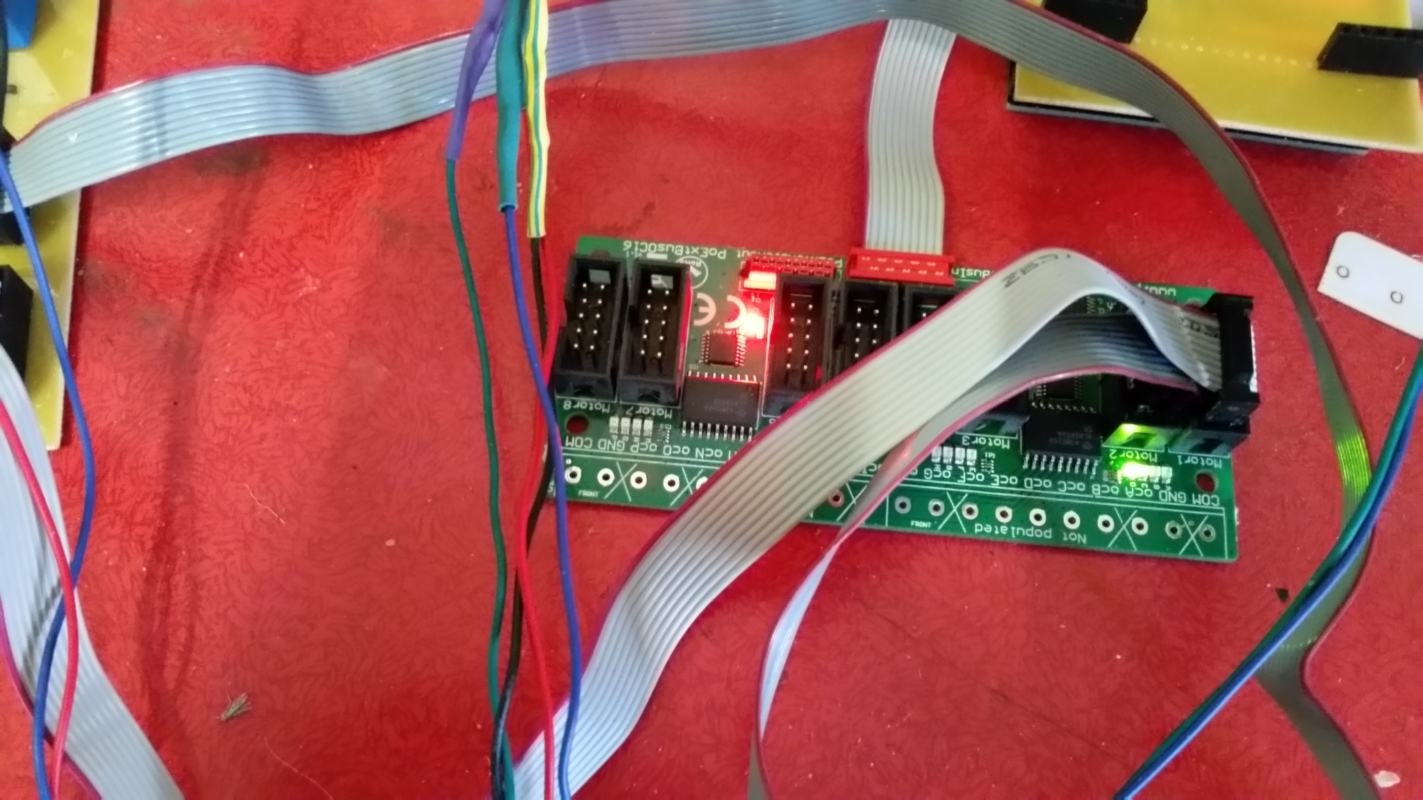

this is very near a success ,
the PoExtBusOC16-CNC comes with a pobus extn cable the 57u has the potential for a pobus extn connection . guess what
the cable is different to the 57u bus connector , the PoExtBusOC16-CNC dosn't connect there anyway . what are they thinking ?
my solution was to make a hat to sit on the 57u to provide the connections i need and crimp a more suitable connector onto the pobus extn cable
auggie laser with pokeys57u+PoExtBusOC16-CNC

Re: auggie laser with pokeys57u+PoExtBusOC16-CNC
major issue is with the motor enable signal .
thr 57u shares one enable pin with all motors ,i have chosen pin24 .its low to enable
when testing from the pokeys test jog set up its works perfectly . from auggie it disables fine but when the motors are enabled the signal pulses high for
94uS every 54mS . movement is ok and unaffected but the motors are noisy .it can't be a good thing . i have tried pin1 also its the same
i also have a question re the laser power button , i want to set a pin high /low with it using setpindig() but cannot find what script is monitoring the button

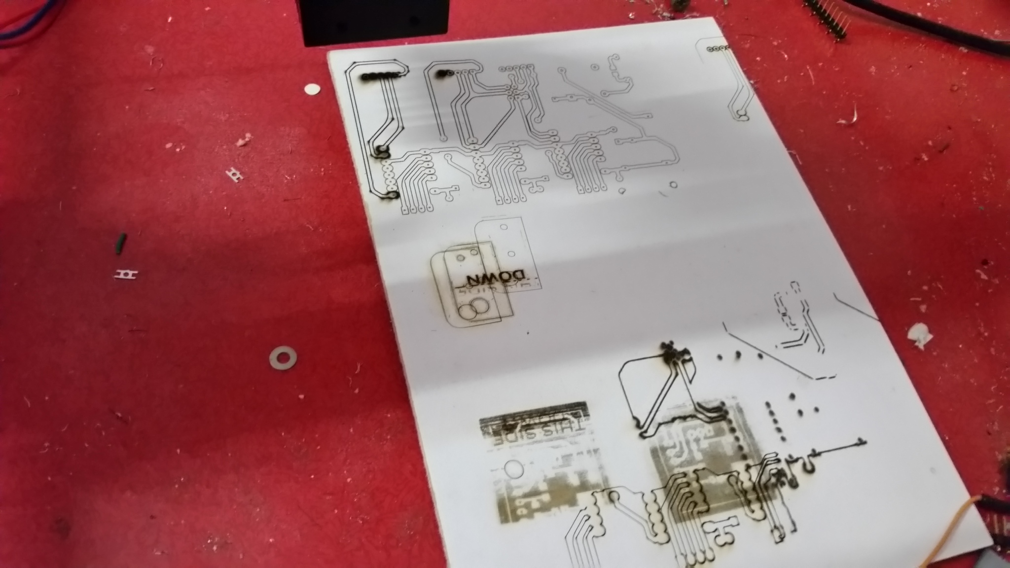

some inital scratchings, i have not made any schematics for this. if any is interested i will provide pcb designs .
as is its a good way to auggie up a laser
