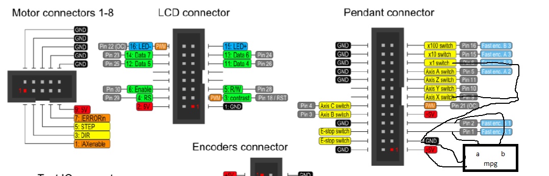

how do go about getting a mpg to work with auggie ?
have wired it up like this

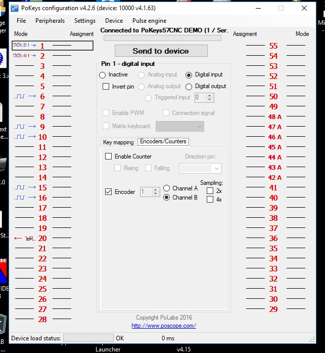

pokeys setting, I know this screen shot is a demo the real pokeys is set as per this

Re: auggie with mpg
Jim:
In the pokeys pulse engine engine config there is a setting for which encoder is for what axis, and a enable/disable.
Is that turned on?
Is that turned on?
- Posts: 152
Re: auggie with mpg
no , I missed that bit . I was hoping to use one mpg with a switch to change axis
- Posts: 152
Re: auggie with mpg
ok that's one axis.

Re: auggie with mpg
looking at the pendant connector gives the impression that its possible somehow

Re: auggie with mpg
Richard:
In checkng it looks to me like the pendent reports to software in its plugin ( in mach3 for example) and the software then takes care of jogging. That would allow for swapping axis, trouble is, I leave it to the pokeys to
manage its own MPG capabilities, so it limits it to 1 MPG per axis with no swapping as far as I can tell.
I will look into adding it to Auggie to do this, but it would be a complex upgrade as Auggie woudl have to deal with the MPg on its own and I havent added any code as yet to support that.

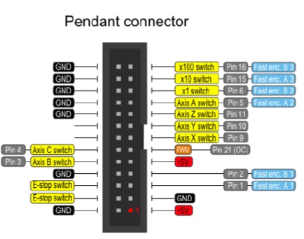

Re: auggie with mpg
Richard:
In re-reading, it looks like if you connect your encoder as the one encoder input to the pendent connector,
and then use the axis switch inputs so select what axis will mpg jog, then it should work when in State 10
as the pokeys is then in full control.
As I read it, when wired up that way, Auggie will switch to the pendent when you select MPG mode. I think
you need only have the "control switch" input on the pendent set to on as well.
Do you have the pokeys PulseEngine.pdf, it shows the wiring of it?
