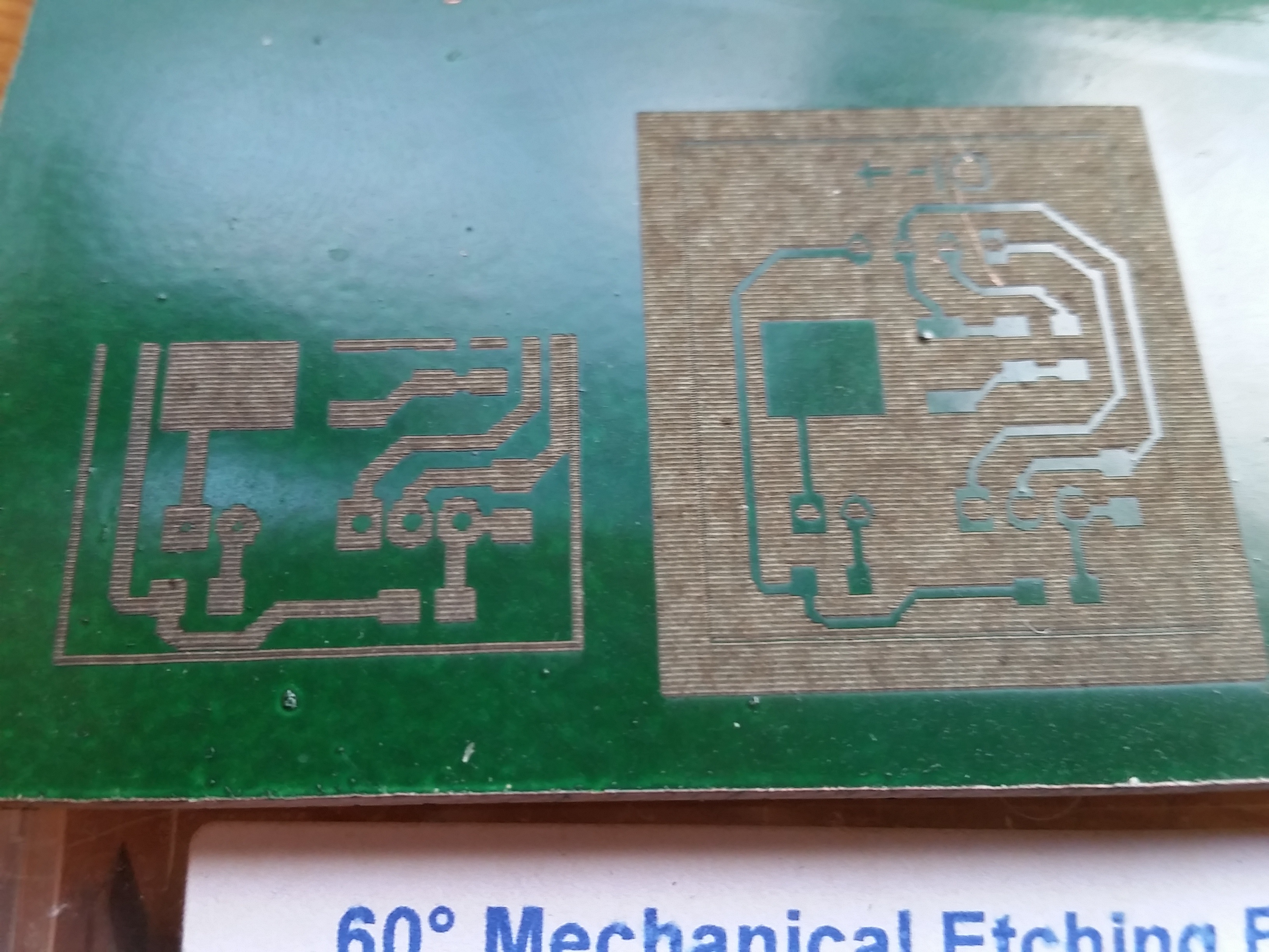

i'm still playing around with making pcbs , now trying out auggie's image rastering, the TRACKS when lasered with a positive image are
correct width {although quite useless for pcb etching } When the image is inverted the TRACKS and PADS all seem to shrink ,
it all looks good on the screen but the result is disappointing when lasered.
looks to me that the laser dot with is being subtracted from the region .
attached are the org pattern and the pos/neg results , raster was 30mm wide .5mm overscan, @.15mm raster

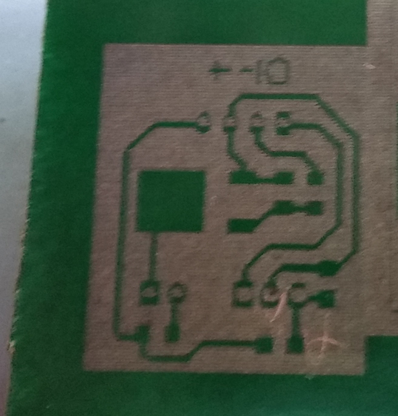

I inverted the image elsewhere and retried augs , I still feel the tracks are cropped .
is there any scope for laser dot size adjustment ?

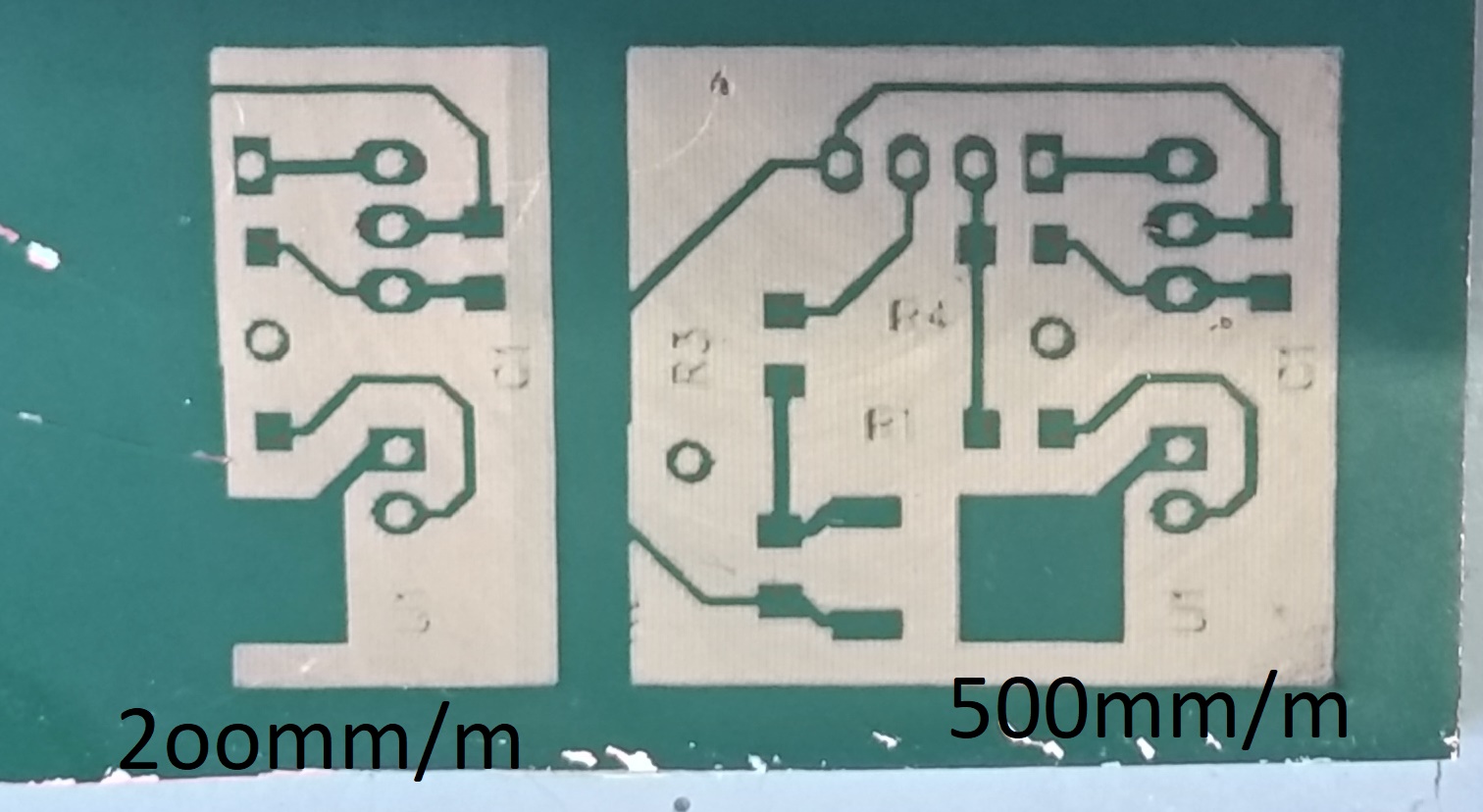

I don't think its a timing thing , traces are thinned n/s as well as e/w . I did try though ,slowing from 500 to 200mm/m makes little difference.
it looks more like milling a shape with a 4mm bit when all the offsets were calculated for a 3mm bit.
traces and pads I can be oversized to compensate but it would be nice for etching logo's and such if negative images were true to form

I increased the dpi of the source image x 4 thinking it may be a rounding issue . makes negligible difference

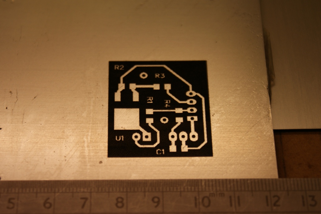

Looking at your pictures my thoughts are ( as you have said ?milling a shape with a 4mm bit when all the offsets were calculate d for a 3mm bit? ) that your laser focussed ?dot? size is too large.
Just to see if I could replicate the problem I copied your pic. and generated the code for Auggie and this was the result.
Hope this helps.
Did you manage to solve your track width etching problem ?
Hope this helps.

my diode laser is fixed focus @18mm focal length and a dot size approx .12mm ,the dot is not perfectly circular either
your laser has done a better job , that would etch quite well.
