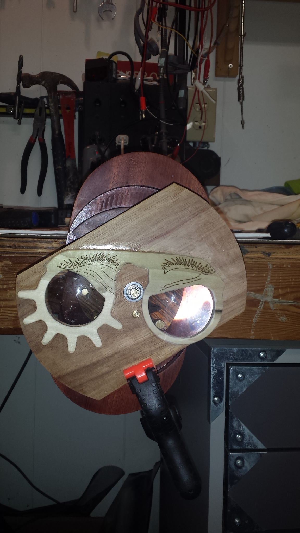

Here's a photo of the ticker.. its called "An Orange Clockwork" , hopefully, its vanes get done this week for video next week..

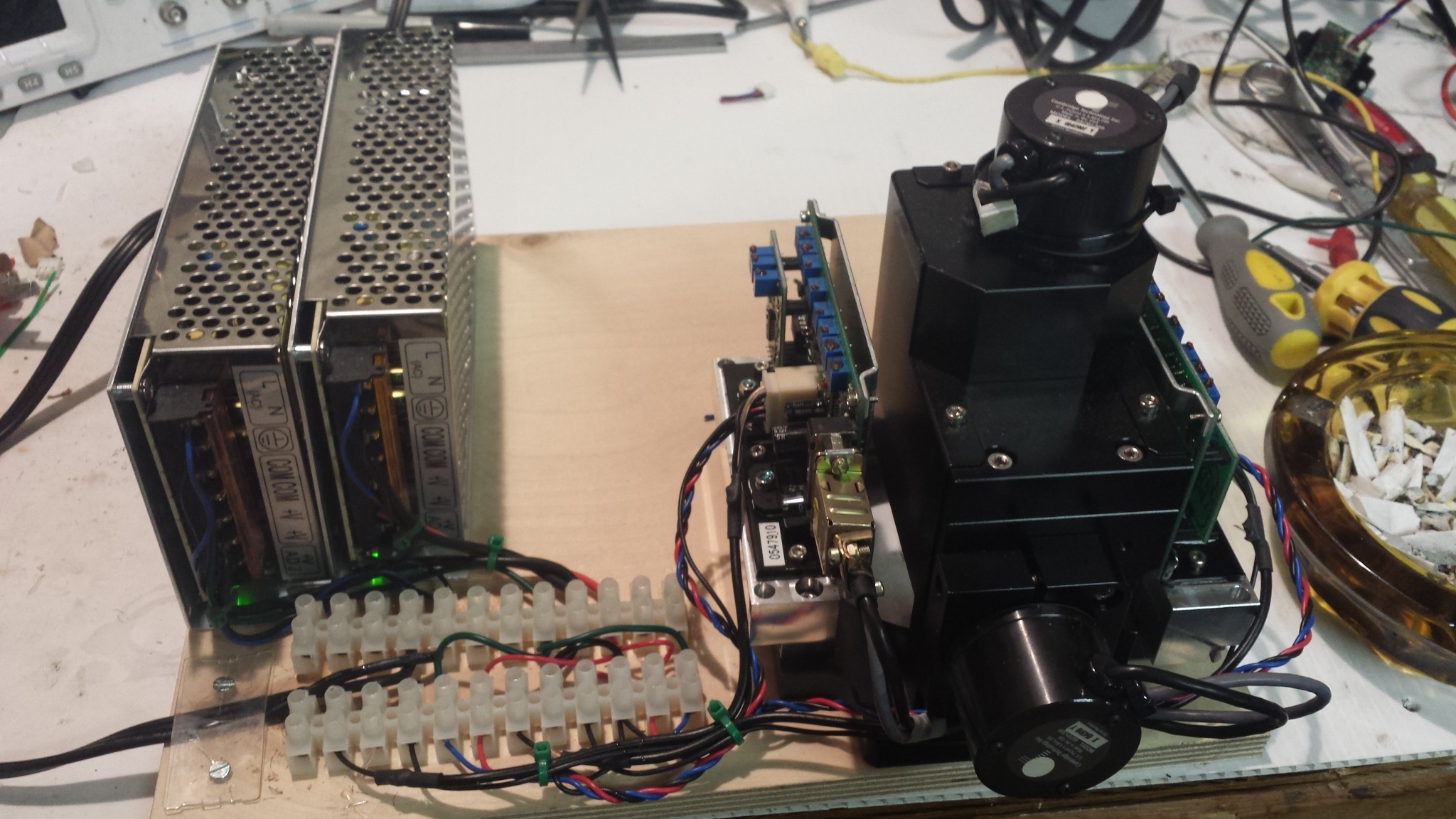

Nothing is put together as yet, I have a galvo cube from a yag system I picked up on Ebay,
I have it powered up and ready for an analogue signal, and I have a synrad T40 to point into it,
but I'm working on making an arduino act as a 2 axis step/direction galvo controller.
If I can manage that, Ill be adding the laser to the cube.. Ill use a laser pointer during
development of the step/dir controller. Ive never dealt with these things before, so Im not sure
how much trouble it will be, but the math of the timing says I can do 100K points per second
from an arduino due .. in theory anyway. My Pokeys can send 125K steps / second, so it should
allow for looking at the galvo cube simply as a very fast cnc mill, only with laser instead of a
tool. So I hope anyway.. This is the galvo cube Ill be using..
