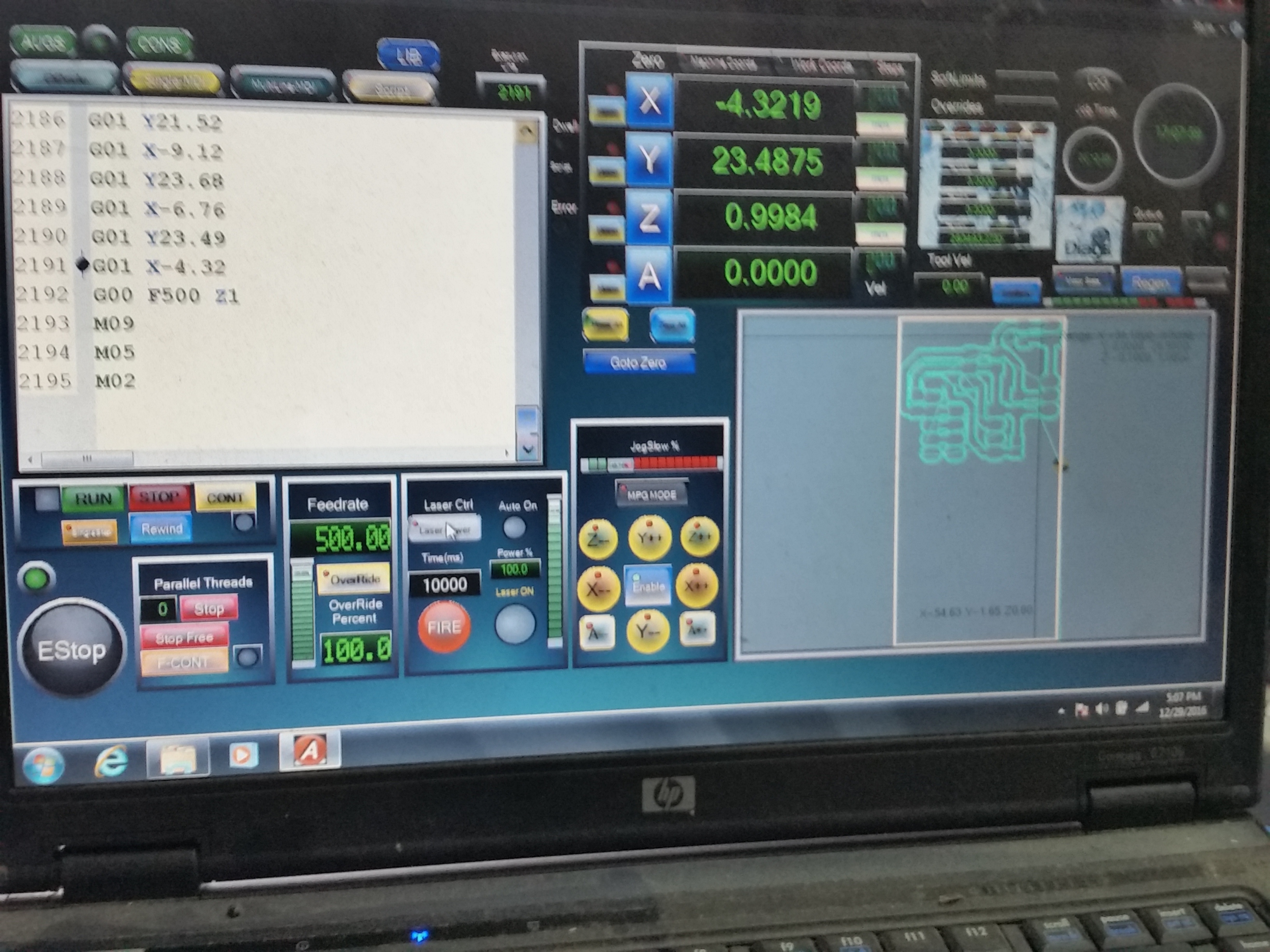

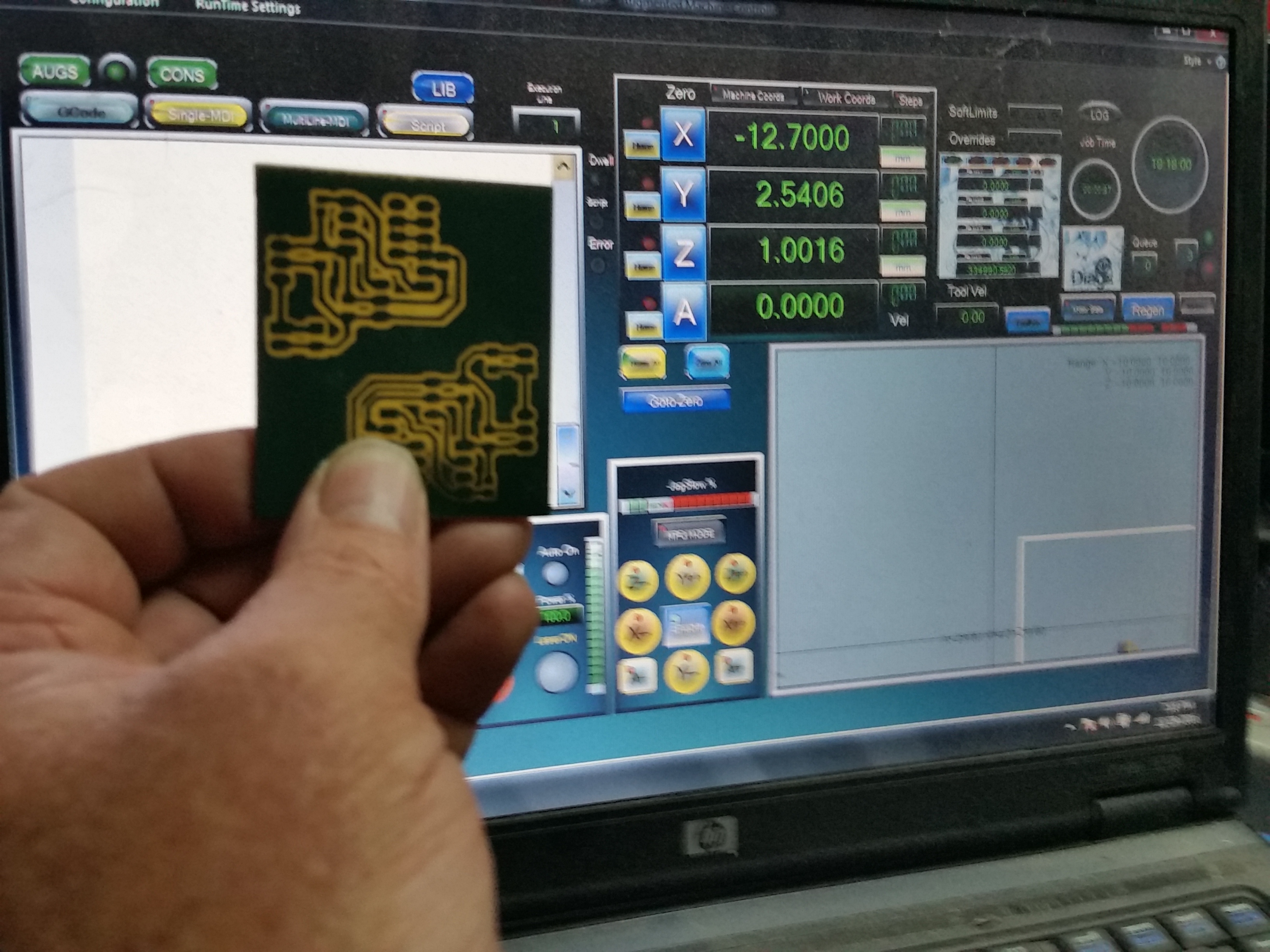

- Posts: 152
Re: auggie with laser diode on pokeys57cnc
first attempts at laser cut etching masks with auggie
method
blank pcb cleaned up with steel wool and brasso metal polish
wash with metho and dry
spray with dark green pressure pack touchup paint , dry in sun 20min (impatient)
cut with auggie , wash again with metho
etch fecl3
first results , pretty good. drill holes did not cut with laser seems g01 moves on Z don't seem to fire laser at anywhere near full power. I was hoping to use the code directly from coppercam to mark the drills
method
etch fecl3
Hi Richard:
Thats looking pretty good. A hint on the Z moves, the power you get is equal to (Actual Feedrate / Requested Feedrate) * 100%, so
if you make your Z move with a feedrate.. Like G1Z.1 F0.5 , youll get a slow Z change at full power laser. Trick I think would be to
select a feed distance and a feed speed that makes the shot long enough for the drill hole. even a
G1Z-.1F.5
G1Z0F.5 would take about 6 seconds and burn full power for that 6 seconds, or so Id think. But if you turn off distance correction you can
have full requested power all the time. Does your laser panel have a button labeled Distance Correction on it? Im not sure if the
distribution has that button, if not Ill upgrade the laser panel to my own version of it. It has overrides for dist/cor and such on it.
One of Auggies best features for laser ifs that it shoots only while moving, and only in a g1 move. But I know there are times
like when you wish to drill a hole where you need more power, the above may be a solution. If not, we'll find one..
All in all it looks like your on your way.
G1Z-.1F.5

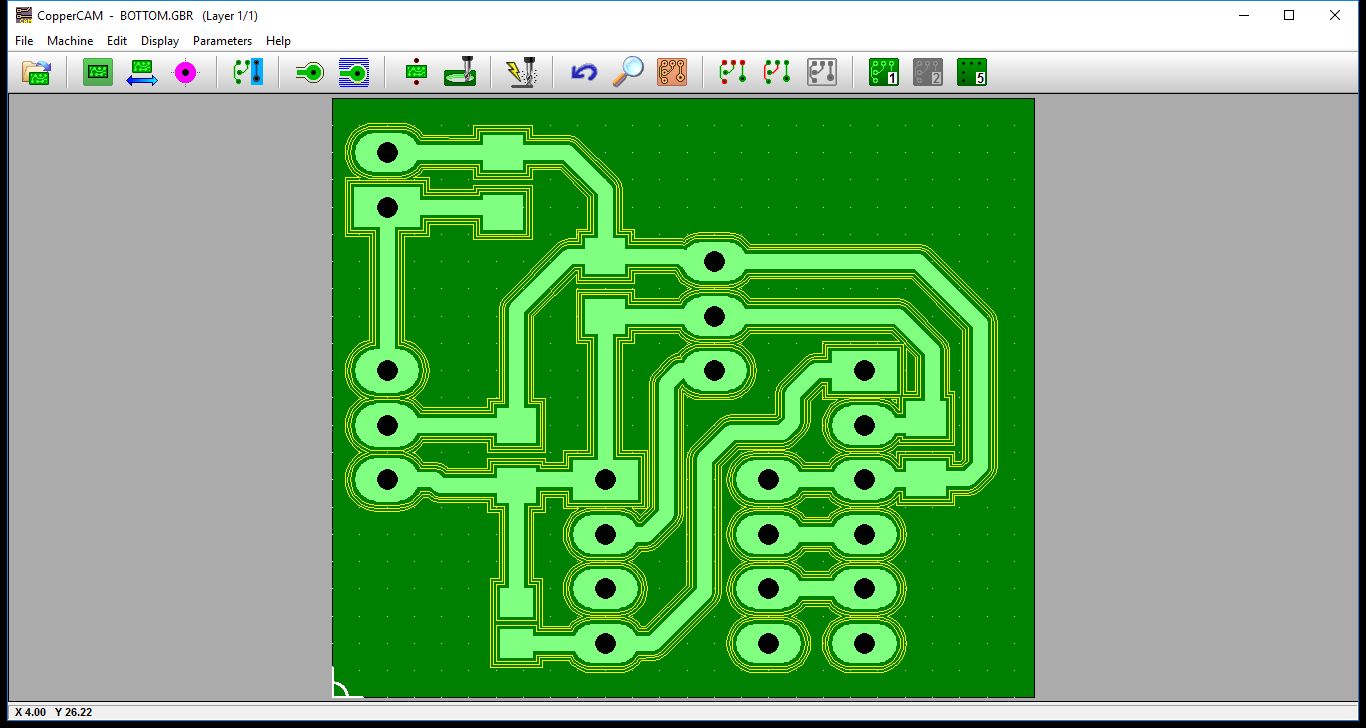

- Posts: 152
thanks for the new panel , but it dosen't solve the problem
treid the Z drills as suggested with distance compensation on/off and the laser will not reach past barely above tickle power
(laser current 10mA where idle is 2mA and full power 1600mA) the power level reached always is 10mA regardless of speed
for each g1 Z move the laser does increase and then go back to tickle when completed but goes from 1 % to 2% (guess) only
coppercam does have a circular boring mode but auggie does not like the arcs it generates (mach3 is ok)
Richard:
Its a good point. All my work has been on imageing and cutting, so I hvent had to get power at a location without motion.
I will add a way to do that, perhaps with a Gcode that fires a set power for a set time..

- Posts: 152
problem solved. coppercam can bore without creating arcs ,just need to turn off circular interpolation.
can now make etch drill point marks any size I need at any speed I desire
