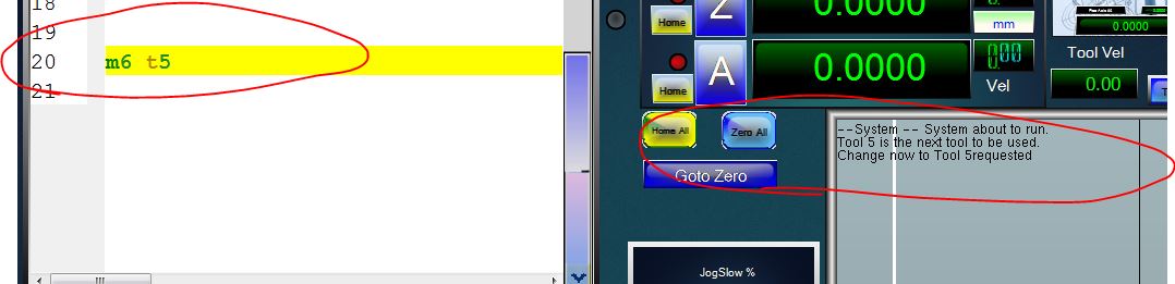

the image above was from the Single MDI tab

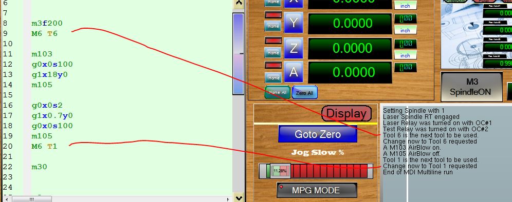

this image is from the MultiLine MDI tab shows me calling it twice in the SIM mode
make sure you have the yellow highlighted line on the start line and use the run button

We did find an error in the M6 today, it wasnt remembering the tool properly. When interpreted, the M6 calls the macro "ToolChange( tool )" but you'll need an updated version which I haven't put out yet for the fix. Ill be updating within a few days.

I think youll find MCode6 isnt being called, its calling ToolChange( tool )..which has the same messages..
M3,M5,M4, M6 are all special and call special macros, SpindleOn SpindleOff, ToolChange..etc..
Any nonstandard MCode or unrecognised MCode will call a script named MCodeX .. so modify ToolChange and it will work.. after the next release anyway. Thx for the tests..
