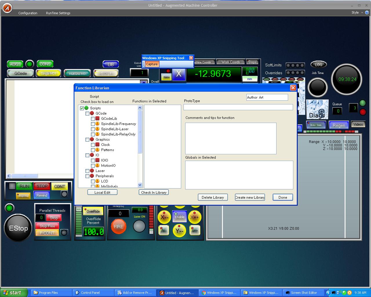

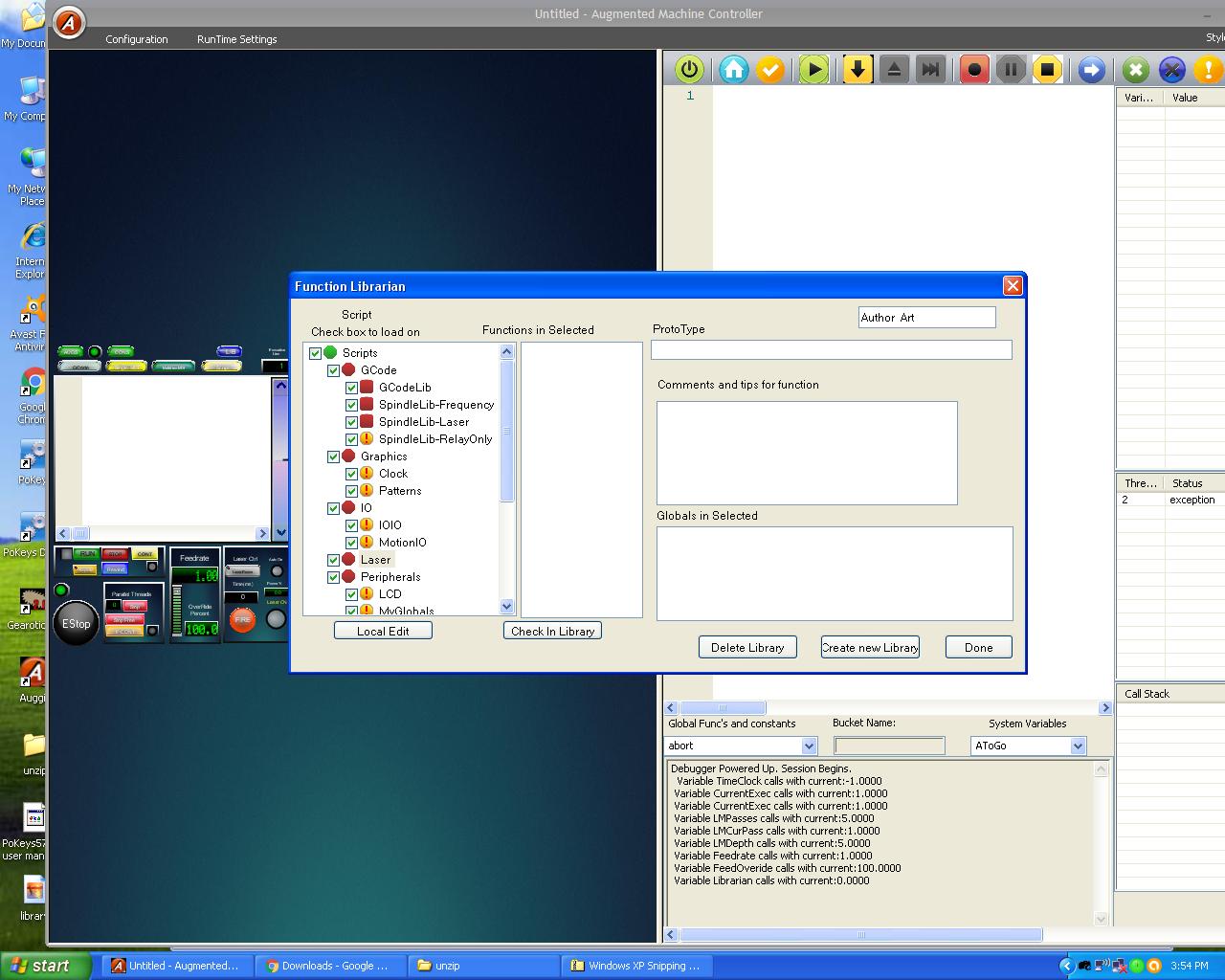

When I try to turn on the Libraries, many show a warning icon, and if I select the checkboxes, click done and reopen, none are selected. I tried turning them all on, thinking it was a dependency problem, but same result. Attached a screen shot of Libraries, and ErrorLog. At around the time of 50: in the log is when I turned on the libraries.

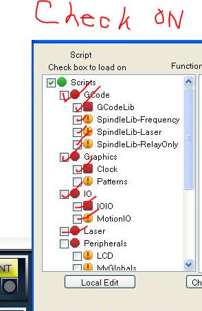

Make sure you check the tree headers too

Thanks... I did have the headers checked. The other odd thing is that different libraries have the error icon each time I open the dialog box.

Seems like it may be a ui issue, and the libraries aren't being selected.
First screen shot is all libraries selected. Noticed the check boxes don't turn green,as they do on win 10 machine. Also the icons are in random state each time I open the Libraries dialog.

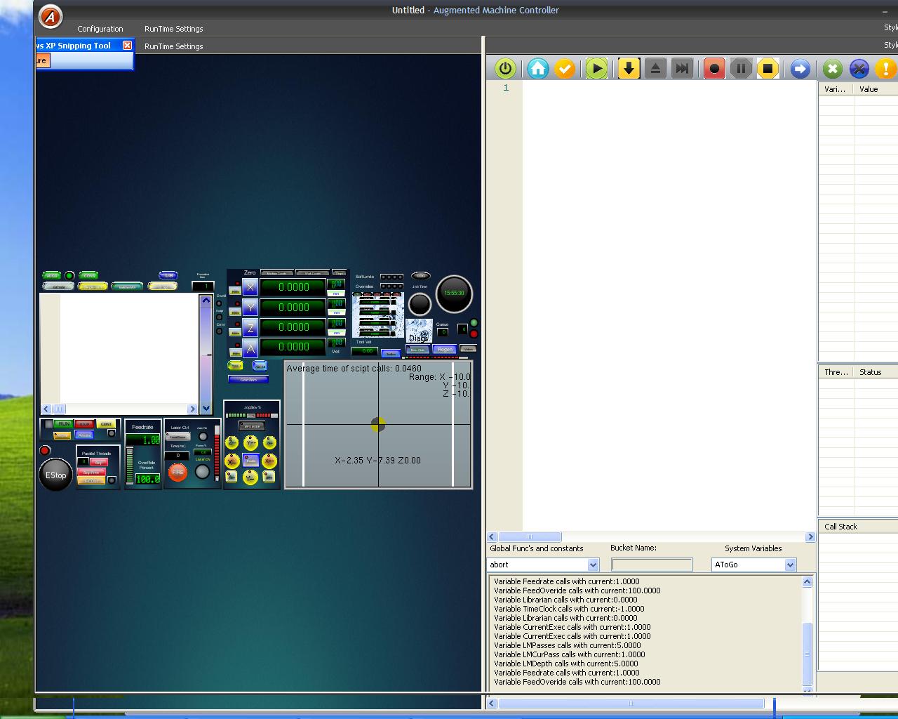

Second screenshot is scripter after I hit OK on Libraries dialog. Also attached the errorlog with log checked.
