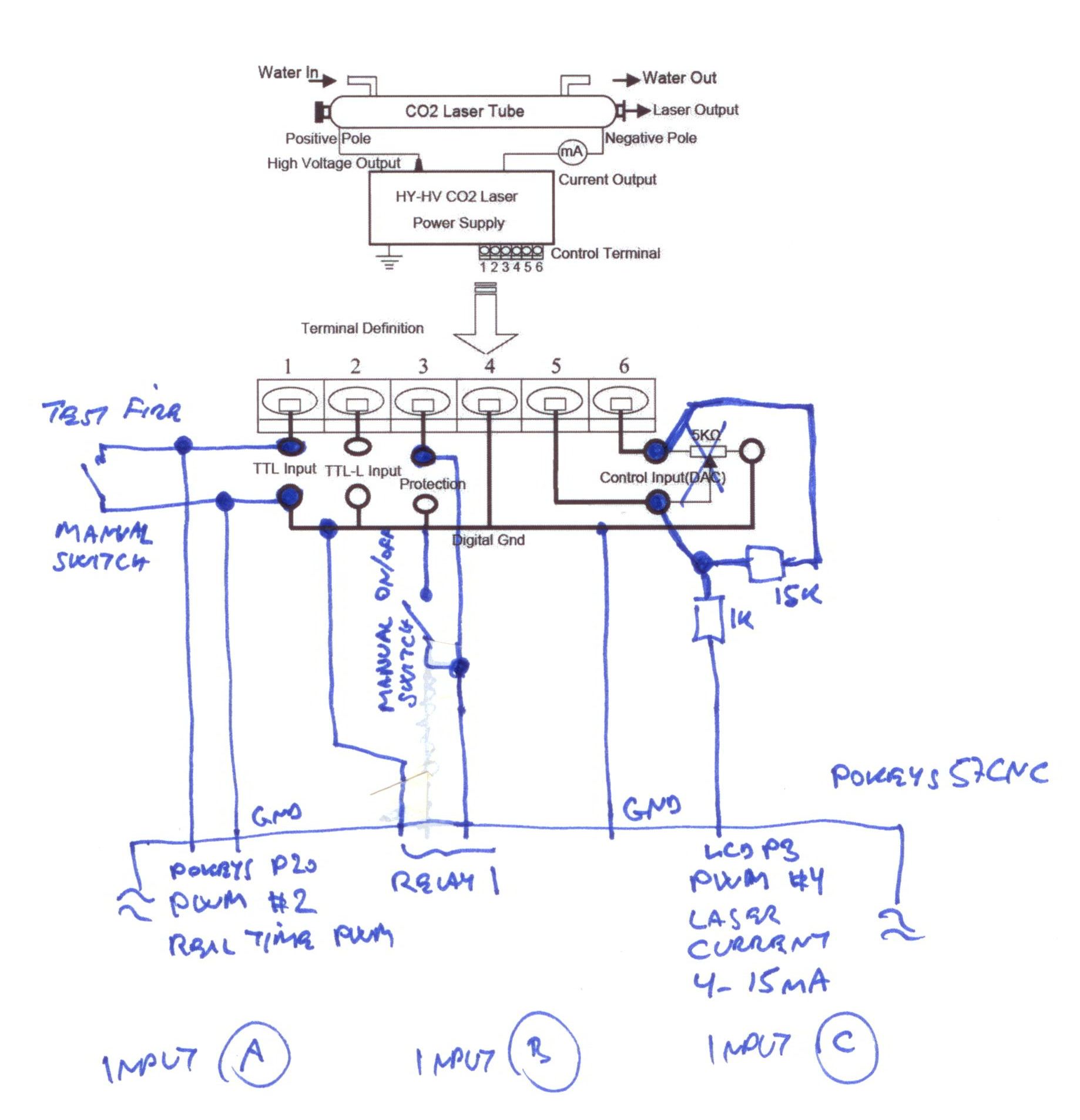

On the power supply there are three inputs: TTL (fire), On/off (Enable/Protection) and Current control (DAC/potentiometer).
I have attached a handmade sketch of my current wiring.
There should not be any conflicts between TTL controlling the laser and setting the current for the tube - Current setting was earlier done with a manuel potentiometer and is properly a slow way of changing the max output effect.
I just made the manual adjustment of current into a program controlled version with PWM channel #4.
The analog to this setting in CNC would be to change the spindle speed - It is not fast but some times needed when running a job.
Because it is possible, I would like to have the same option on the K40&nbsp; :) Others on the net has done the same.
It is working fine as long as M3 is not activated. After M3 is run, the value is frozen and can not be changed until M5 is run.
(The power supply on my K40 is a little different, but the sketch shows the same signals)
Joakim
Re: M3 blocks changing PoKeys PWM
J:
&nbsp; I understand. My point was that input A is not required, it could be jumpered to ground. Since PWM#4 is controlling power,
a setting of 0.0 duty cycle power is always off even if TTL is on.&nbsp; Max power would be a 100% duty on PWM 4.
&nbsp; Under that scenario, the pwm control is never locked out, it is provided by #4 whether&nbsp; using S words, or slider, or Image augments.
On a K40, from our testing, the PWM input is fast enough to control everything in realtime. But.. whatever works , works. :)

&nbsp; PWM at 20Khz is basically a DC value to the circuits. I would recommend just using PWM into the analogue input, and tie
the TTL to ground. PWM is enough to do all the control, really nothing else is needed.
Joakim
Posts: 56
Joined: Mon Sep 17, 2012 5:48 am
Post by Joakim »
Art:
I plan to use the optical isolated input that the original Mosidraw board used and the analog potentiometer. The optical isolated input can be used without any modifications - using the analog input for PWM can result in over current if voltage gets to high and I have no electrical protection (It is a cheap Chinese power supply).
The optical input is designed to be used for engravings, the Mosidraw board used this input.
If I let the potentiometer be at the highest level the end result should be the same.
And it is still handy to have manual fire and low power when calibrating...
I can always switch to using the analog input at a later time if this configuration gives trouble.
Joakim

Another benefit of this configuration is that I am not bound by the 20kHz requirement for current control. I could use a lower PWM frequency as the current is managed by a DC voltage from the potentiometer.
When browsing the net for cut/engraving settings I often see a recommended frequency - often wondered what that ment... Anyone have an explanation for this?
