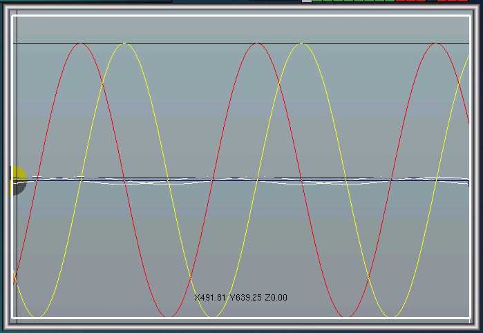

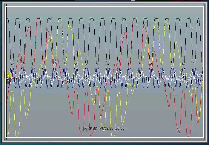

Running the 1mmspiral.tap GCode file on my K40 I noticed uneven circular motion, like motors was constantly changing speed.
Turning on Motor Stats I got the oscillating motor output as shown on the first screen capture.
Settings:
Feedrate = 3000 mm/s, Lookahead = 20, Constant velocity on = 0.05, Max Jerk Limit = 5000.
Rerunning the GCode and raising Max Jerk Limit to 50000 (10x) stopped the motor oscillation and motion was again smooth (Second screen capture).
Is this the expected effect when lowering Max Jerk Limit?
(The 1mmspiral.tap is a special case, with only arcs and no lines)

Re: Uneven motion in GCode spiral when Max Jerk Limit is low
Hi J:
  Yes, Id expect that. Lets discuss why for a second as it may help others as well..
The CV in Auggie is unique, its based not on accel as in Mach3, but on a defined
radial distance. (In your case .005 , which is very very small by the way..). The radial
distance you select as well as the length of your line segments in any file will define
just how much the jerk setting affects the end result.
