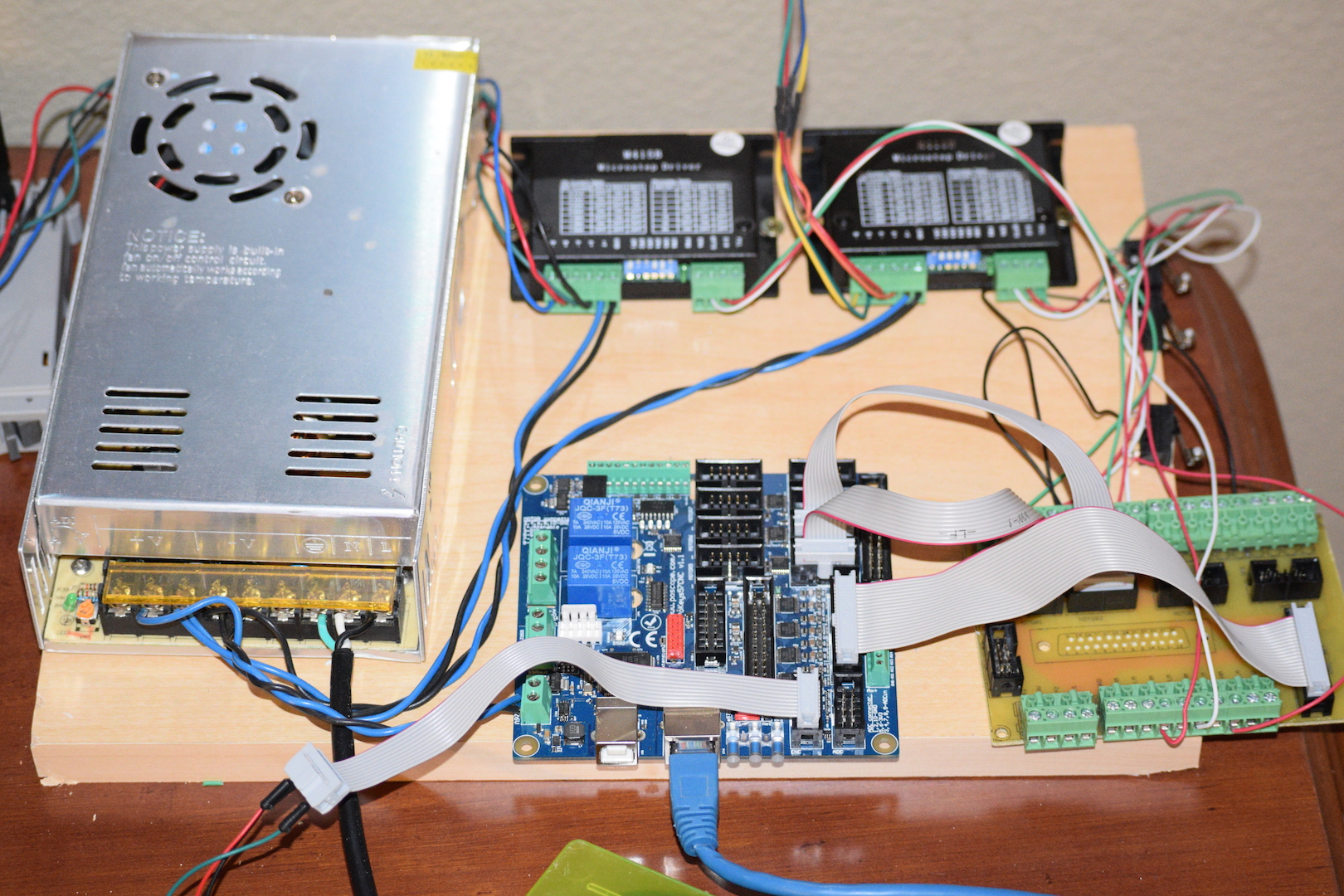

Need to redo the board to add in the 3.3 to 5 volt and some other changes but this my basic set up for electronics.
Mounting and wiring will get better.

Glenn:
Looks good, by the time its moving, it should be bug free enough for what you need it to
do. Like Mach3 was, it will be one of those ongoing projects at any rate.
