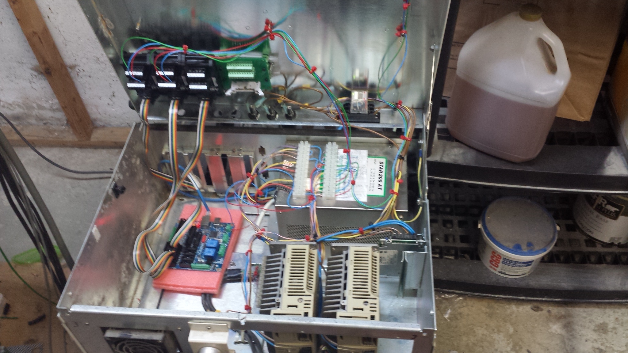

Well, I finally moved my 57CNC to the controller box, just lying on it foam protector till my standoffs come in,
got my Axis up and running. In Darwin I could run at about 11000 as a max, in Auggie, its scaring me at 30,000mm/minute,
so I have to turn it down I think. Awesome first tests though. The application of Jerk shows noticeable difference through
its range and Ive never seen the arms move so fast.
So far, Im pretty pleased. I still have laser supplies and all that to hook up, but initial testing is really pleasant
as to the lasers motion. Ill post a video showing various jerk conditions and the resultant runs of a test pattern to show
how Jerk Limiting can smooth out motion to allow higher accels, at least on this heavy beast.
Latest version of Auggie is online with Feedrate override included. It works pretty awesome here,
with instant slowing to any percentage speed. Very handy for slowly starting up the system.. If I can get
this type of performance while scanning with the laser, Ill be quite happy.
Heres a photo of the control box system as it sits so far..

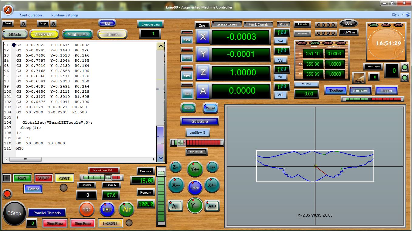

here is real short video of auggie running a SpiroGraph, shows on the paper the led red beam I use for testing and alignment. :o
running at 2300 inches per minute in X and 700 inches per minute in Y

Another quick video of the cylinder raising turning on the led test beam and showing the outlining of the Harley wings.
You might beable to see the reed prox switch on the air cylinder I'd like to see if I can determine position of LED lift station.
Gcode script inserts
GlobalSet("BeamLEDToggle",1);//sets the button state, that toggle raises the cylinder and then turns on the red led.
GlobalSet("BeamLEDToggle",0);//sets the button state, that toggle lowers the cylinder and then turns off the red led.
then as an EStop safety I added the commands in the "Library SystemCallBacks" to toggle the button states to off, turning off the laser library controls if they might have be set on.
global OnDisable = function()
GlobalSet("AirBlowToggle",0);
print( "--System -- System Disabled.");
https://www.youtube.com/watch?v=KEoRbCoDFdE

I hope you got the pokey57 off that pink foam. It's usually anti static which means it conductive!!!!! Many years ago i was testing a circuit on a piece of anti static foam and I was getting erratic operations until it dawned on me that the foam was somewhat conductive. After replacing the foam with standoffs the problem went away.

Re: Finally hooked up and running 2 axis..
Hi Dan:
Actually, its on standoffs now. High rsistance on that pink foam, doesnt
seem to affect much at low voltage...
Happy to hear it's on standoffs. When I had problems is was only running at 24V and there was a 5V circuit also. The way I found it was that I was measuing something with my dvom and and when I pressed down on the probes the reading changed. Sfter making sure it wasn't a loose part i measured the foam and said wow!.
