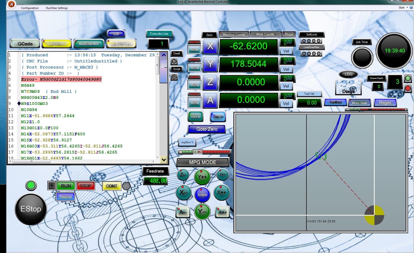

seems to work ok on my hp i5 w7 laptop (wifi) , after doing the pokeys updates to the latest version (firmware too)
having issue with incremental/absolute arc moves
Re: Laptops and Auggie
Hi Richard:
Yes, some Gcode items will still act up as of yet. Arcs in particular. They are only roughed in as Id liek to make them of any normal..
Glad to hear its running though, several updates are in the works..
