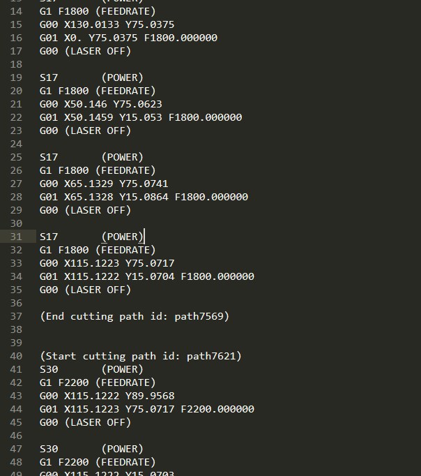

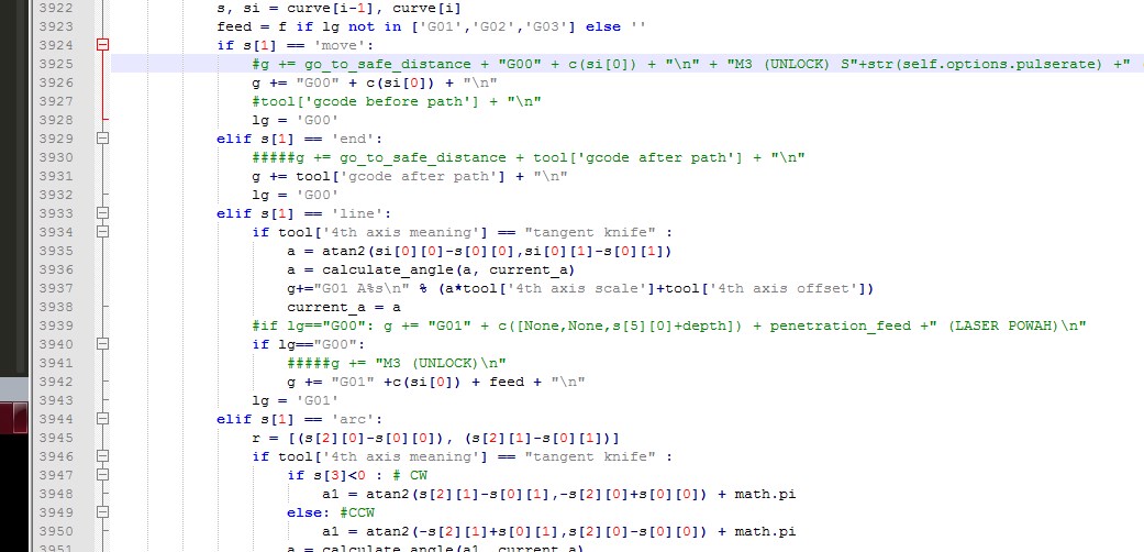

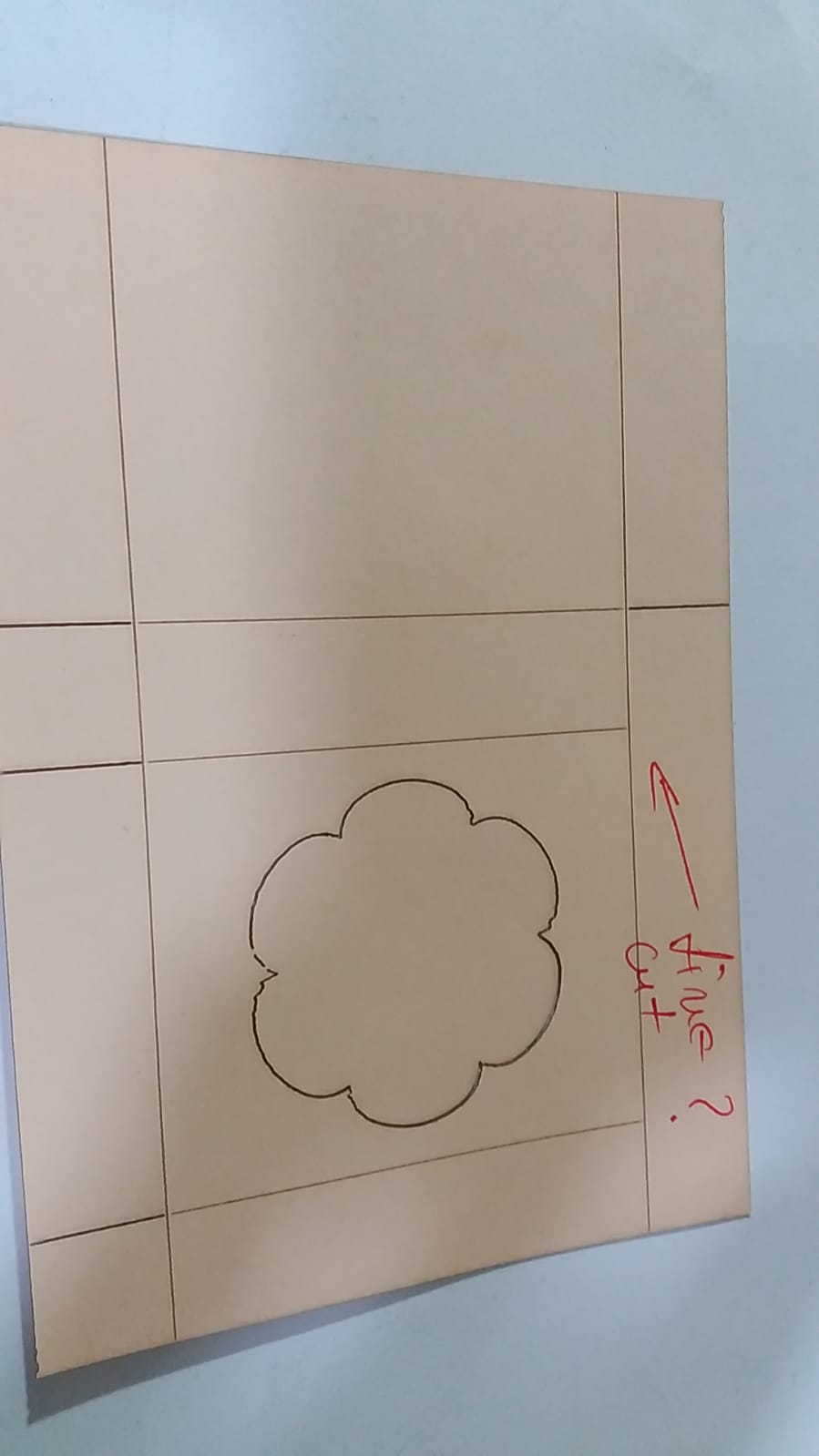

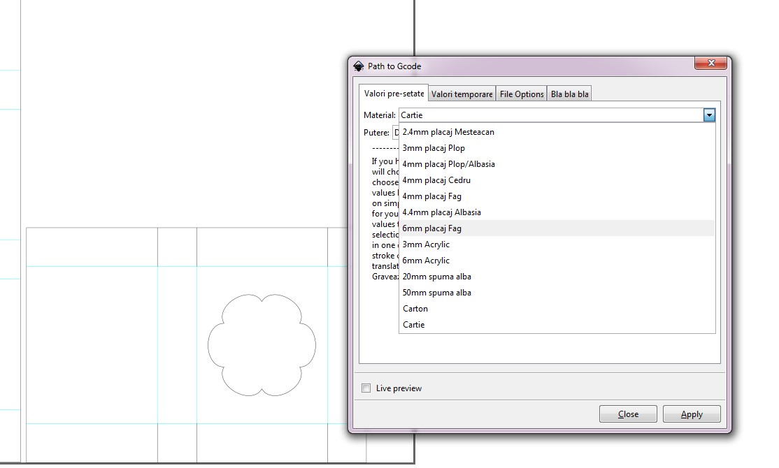

Re: My laser engraver from 0 knowledge to 32.461% .... probably
Hi everyone
I have some trouble for a while with my code . I try to find a extension for inkskape
to generate the GCODE to fit with Auggie and to cut and engrave by color lines.
So far i found some , but not useful , no one change the power,speed by line color.
So keep reading and combine some pieces of codes also writing new ones i manage
to generate the GCODE with 4 different power speed by color.
To good to be true , sometime after engraving , when the time come to cut , the laser dont fire
on some small parts . I noticed if the part need to be cutted have less than 4 points sometime
miss to cut random pieces. If you run the code again , same parts are not cutted.
If i generate separately the GCODE , one for engrave and one for cut , everything is ok.
That happen only when cut and engrave with different power speed are combined in one file.
I put below a pic with that error and also the GCODE , maybe experimented guys can
figure out what is wrong .
I try to figure out but no chance for me .
Also if someone want i can send the inkscape extension , single problem is
variable are writed 30% romanian and the rest in english . In SVG file , black line generate cut
, blue deep engrave and blue+green light engrave.
Bobby
You may want to try it without all the M5 and M3's. Just put one at the start. Auggie will not cut in G0.
The laser will only cut or burn when G1 moves are in progress , otherwise power is off. ITs possible
all the redundant script calls are threadlocking or something. Just put m3 at start, and an M5 at end of
the code and rely on the G0 moves to not cut while the G1 moves do.
Thank you Art , you are the boss :)ArtF wrote: You may want to try it without all the M5 and M3's.
Well soon i wake up i saw you answer and i start to modify .
I let M3 only an beginning and M5 at the end of code .
Surprised , the laser cut all lines , dont miss any line and everything is fine.
Second good thing , now the extension generate the GCODE way more faster ,
i mean if before for 20000 GCODE lines need 20 sec , now in 6-10sec is done.
Still i'm not sure if is necesary the line "G00 (LASER OFF) "
because if i pass that on next will be the " power" and " feed " set and
start again in "G0" >
I mean the laser will never " accidentaly " burn without that line , right ?
For me was a little difficult , without any knowledge about GCODE ,
my start was from "0". All good now , still learning.
Thanks Art
Bobby
Hi Bobby:
The G0 line is not required for laser control. It is a given that any G0 move will
not turn on the laser. SO really, only an M3 at start is necessary, and the M3 is really only a
safety.
Ok . Understood .
I remove all unnecesary comands and now work ok.
So at the end wasn't the extension issue , M3 M5 G0
repeately on each path just saturate the script .
And also the code is generated way more fast of course.
Thanks Art
Bobby

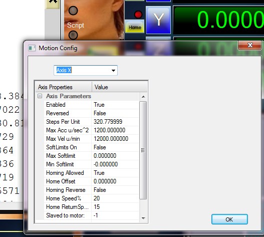

Yea , on laser a burn miss is not big deal but on CNC it is .ArtF wrote: Bobby:
Recently one user made cnc scripts for spindles and I think he had to add a sync to make sure
the spindle was up to speed before continuing.
I got the point about that .
And now with all pieces together , i remember , when i write first time the extension
to fit with Auggie was ok , but in that time my motors wasn't realy "good " tuned.
in time , getting experience , i figure out my laser can go to 12000 without any problem
the motors are with encoders and never miss one step , many time i engrave a photo 6 or 7 times
just to test and never miss the 0 point . But... after G00 go from 4000 to 12000 "max 4000 was my old config"
the laser start to miss some very small points .
And now working normaly.
When i start to build i was with '0" experience in CNC and GCODE and of course
i made many mistakes when i design the laser .
the very big one , the X ax are so heavy + big motor , totaly pointless to move 200g
laser head , the ax itself is at least 20 times more heavy than the laser head,
but if we dont mistake we can not learn , so ... we go on. :D
thanks Art
Bobby
