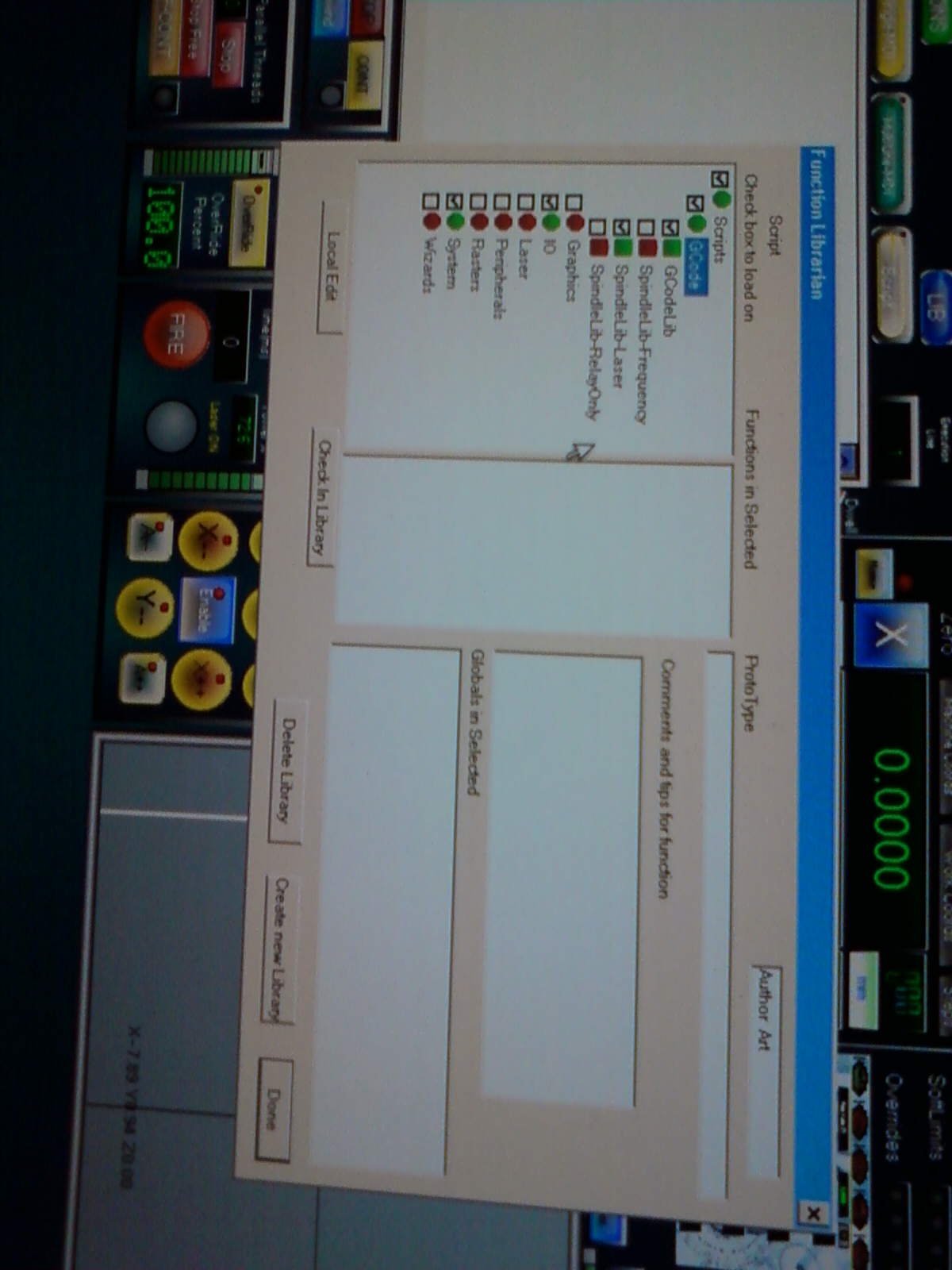

Hi;
This is what we come up with.
For all XP users, next release of Gearotic should have a fix in it, however for now if your library doesn't appear to work in XP like mine did, simply copy and add the following code to your profile and restart Auggie.
To elaborate, inside your Gearotic Motion folder, you'll find a folder called "Profile", inside that folder you'll find your configured Auggie system profile, simply edit it (*.profile) with notepad and add the following code to it and save it. Restart Auggie and it should work. What you'll see is the green indicator to indicate active, make sure all the ones shown in picture are active in order for it to work properly.

Anyhow hope this helps anyone using XP and stuck in the loop I was, and thanks to Art for his dedication to finding a solution.

Re: Realtime PWM mode added.
Here's a picture of the Lib when it works fine...
