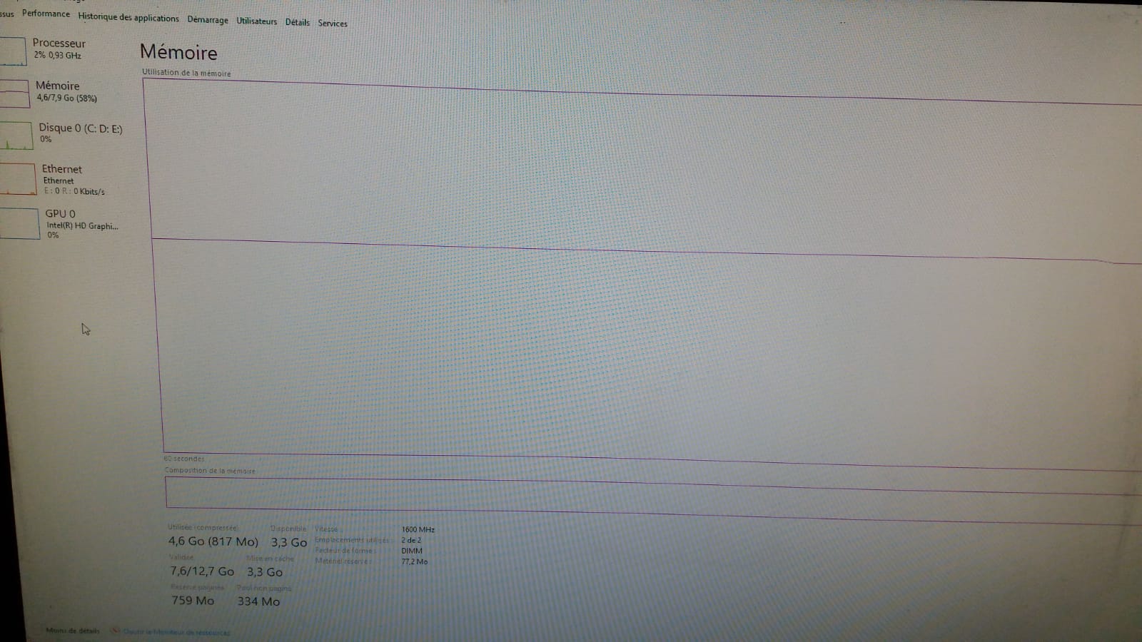

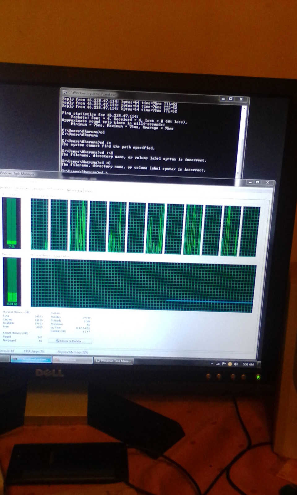

Re: Almost there: Laser reacts strange around 1% power (and traps for beginners)
You mean auggie keep data in RAM , not external "temp" file ? It load entire program in memory to avoid timing delay from external temp file ? Maybe that is the explication why on some photo i test on my second laptop i got some strange error ( quad core 4gb/ram). That errors, same image never come on the second PC ( 2 xenon x 6 cores , 36gb/ram with the same auggie profile and settings.ArtF wrote: Roman:
I think whats going on is a memory limit. I used to use 300 look-ahead on small segment GCode, and it works fine. BUT,
if I load an Aug, specially if its created by Auggie in the same run, the memory gets low. During a run Auggie must keep
the image you used in memory as a lookup table for burning.
What I found was at line 243 in the run when loading, creating and running an Aug, I got a memory overwrite failure.
Im going to see if I can put a memory check and lower the look-ahead if not enough memory is left but

could be as I 'drive' on the bare minimum on an old Shuttle barebone which I use for the CNC machine and which only has 3GB. It is quite old but was 100% sufficient so far. After booting W10 puls Norton allone consume about 1.5GB physical.
So , is in RAM loaded. I understand why i got some errors on old one , and was 8gb/ram not 4 , i forgot , but like you see in picture attached , only opera browser loaded and one PLC compiler , let me only with 3gb/free .Roman wrote: could be as I 'drive' on the bare minimum on an old Shuttle barebone which I use for the CNC machine and which only has 3GB. It is quite old but was 100% sufficient so far. After booting W10 puls Norton allone consume about 1.5GB physical.
On second one i never got any error , only when i made some :-[

Hello Art
It does not seem to be the Memory.
I tried with the biggest G-Code file I have. The maximum RAM Auggie consumes (at least what the Task Manager shows) is 165MB and I have plenty of memory free during the burning.
With this file it crashed all the time.
However, I tried to raise the look-ahead in steps: At 201 is the last working one. 202 and it crashes.
Best regards
Roman
