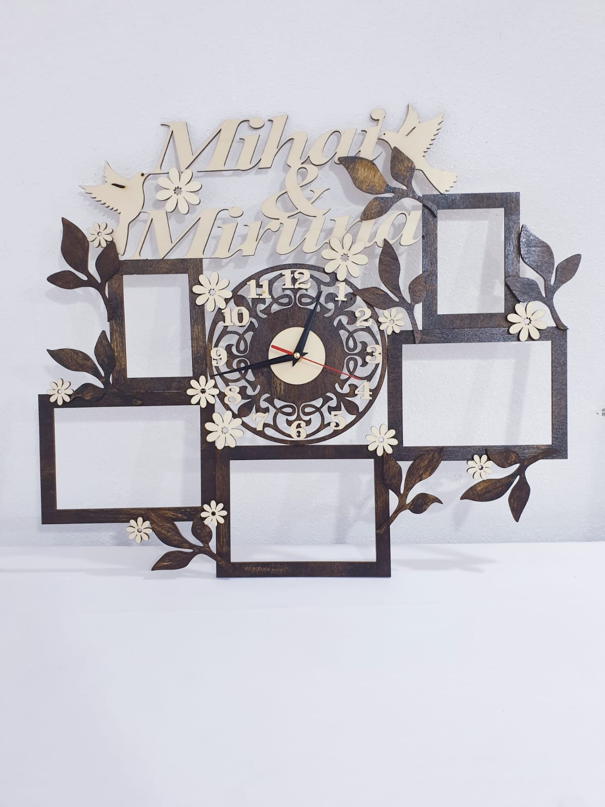

Thanks for you kind words . I was off a while bussy with my house
I was surpised when i comeback to laser, i change the laser room and after some days i try to engrave a small photo 80x94mm and a error pop out "exasperation code " xxxx
dont ask me the error number because i forgot until next day . Single way to pass that error was to change the size at 81x96mm or other size and work fine . After some hours i try to reproduce that error
but was impossible , no error at all. No ideea what was about .
I will post some pictures , work better and better .
Thanks again to everyone

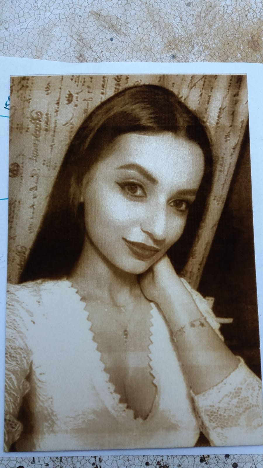

Thanks ... well like i says , i'm on again playing with my laser and i figure out something strange and very important in my opinion.
When i was in France i buy some good quality playwood from Germany so the photos engrave ok . Some days before i start to engrave one photo , a normal resolution like 1200x1600px and
surprise , the laser even i increase the power more than i was need before for same type of dimension , 140x210mm refuse to made the dark brown color on wood .
Literaly he cut deep almost 1mm and no way to get even brown , i got something like very light brown . I got piss off and i start to made a ,mess tru' my polywood to found that piece of same type of material .
No way to find , but i'm ordonated in my way and usualy i memorise everything i made for any photo i engrave . I set my laser identical , i take one good succeded photo and i engrave same code on the back of that photo .
Same story , the laser cut but dont burn .......  ??? ???
Well ... doing the time back in my memory i remember , when i was in France the polywood has always some high moisture because humidity was very high in my town . Moving back in Romania , humidity is normal here
maybe a little dry if don't rain for a while . And.. i take one ordinary polywood , a brush with water on both sides , a thin layer , i let to dry couple of minute and i start engrave .
In that moment the dark brown almost black coming on the wood.
In conclusion , if polywood dont have hight moisture , the full white-brown scale is impossible .

Some work below
I forgot to say .. the image was very low resolution , only 540px and 44kb
Bobby

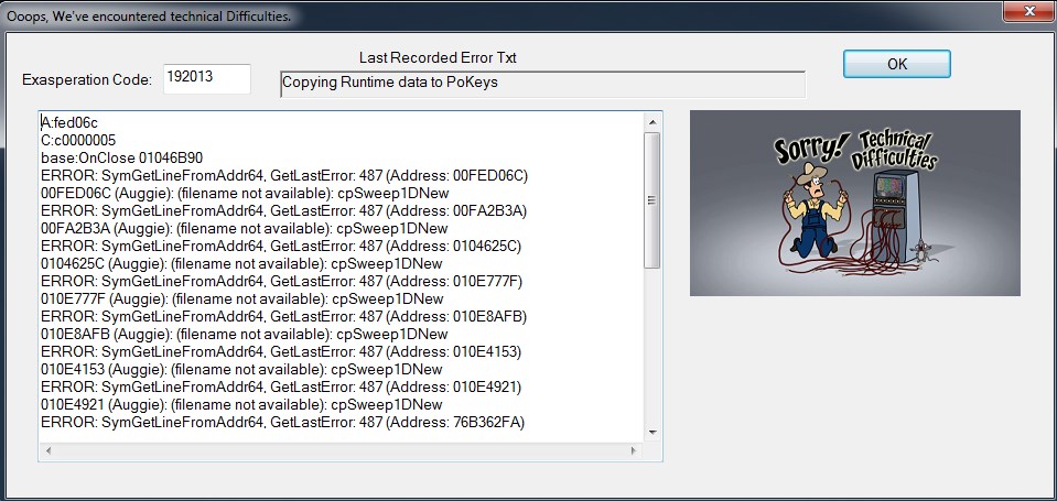

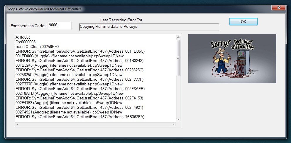

Also today i want to add a button on screen for one realy , and no way to made it to work.
I start watching you tutorial here https://youtu.be/AtnLlfho5BU , but no way to see the code for other buttons like i see in you vid.
So .. i anyway i was needed two buttons so i say to made a small screen with two or more buttons and when i try to destroy screen for new one
i receive two different errors everytime when i want to destroy screen .
I even update the auggie on last version i found on website but same result .
I put some screenshoot below .
The system is win7 x64 and i will dont change for 10 or whatever , i work hard to downgrade the bios to bypass the win7  :(
thanks

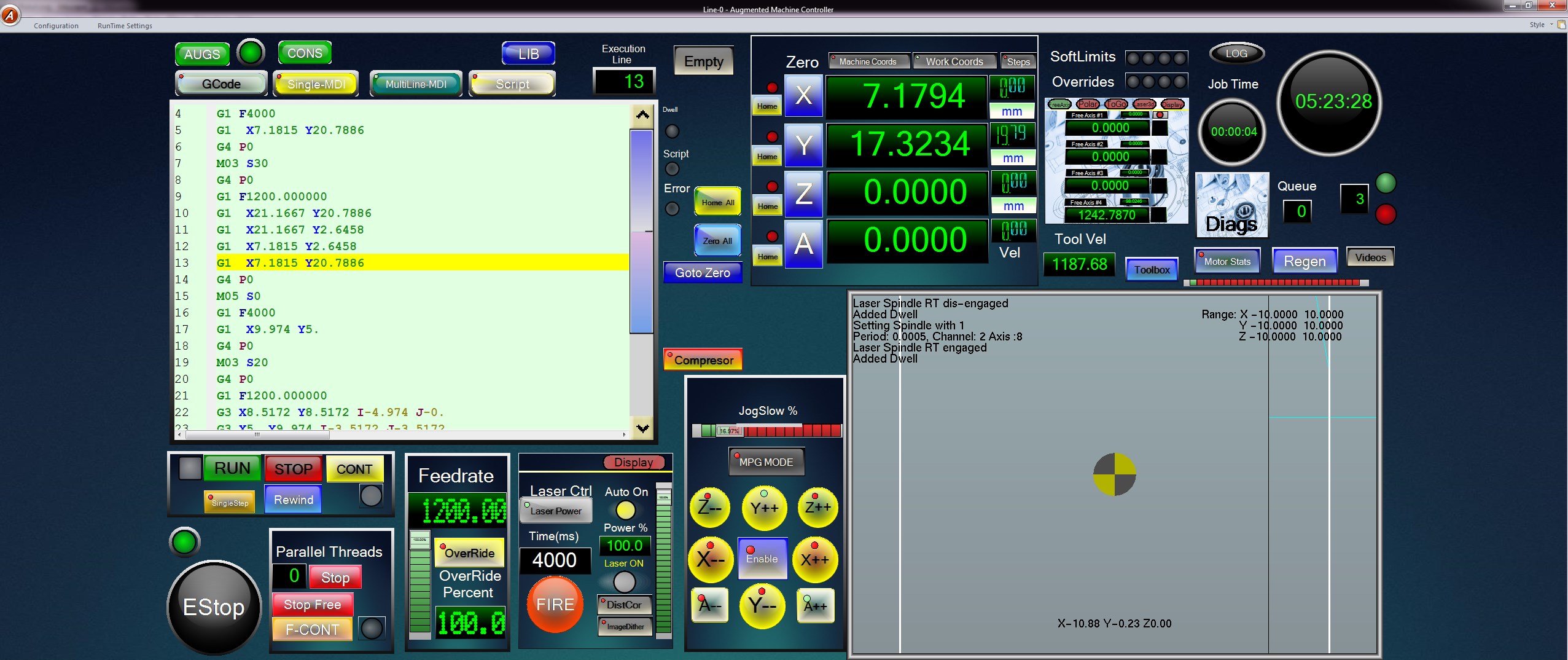

About power and "S" comand . No way to set the power in GCODE. Definetly is something wrong with my Auggie
or i'm just stupid  :-\ . The rest of Auggie work perfectly , only if i want to run different poers comanded in GCODE
don't work
Also don't work in a single or multi MDI.
I attach below a simple circle shape to test in multi MDI

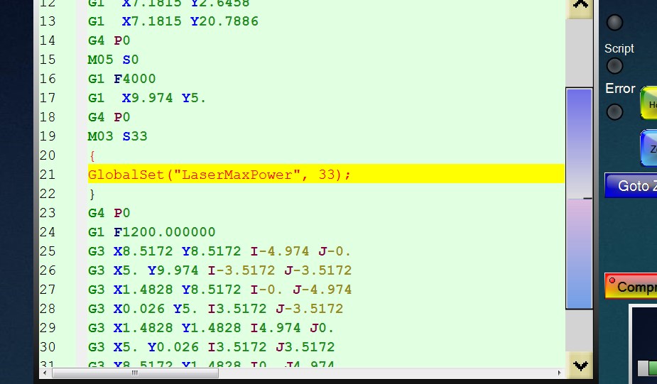

It wont work with S words controlling the laser unless you change the script in the
LaserSpindleControl library. You need to make the speed function look like this..
global SpindleSpeed = function( speed )
  /*power is automatic in laser spindle mode..
    no need to specify, in laser mode, spindle
    power is a function of augmentation */
    print(" Set Max Laser Power" , speed);
    GlobalSet( "LaserMaxPower" ,speed);
  this will change the slider value to the S word value and burn at that power. There is no override for this
though unless you add some sort of logic to that call to override S words. You will see the slider change
position on each S word in the GCode with this set this way.

Yea , yea i should figure out is something missing in spindle library because
i use to control the power like in code posted in picture below.
But was annoing to edit all the code manualy or to create little program to insert automaticaly the code below the S# parameter.
Well... the thing mess me up was the lack of knowledge . I read several section in the forum and in some posts i read
some of GCODE parameters are already included in AUGGIE itself inside of software not in external scripts .
And in my head became the ideea to dont create a conflict if is already defined in program.
Exist somewhere a doc' about all variables used in software and parameters of all of them ?
Anyway , you save me Art , that S# issue became annoing because remain stick on my brain   ;D

Re: My laser engraver from 0 knowledge to 11.362% .... probably
Bobby:
  Awesome, that too will work. By placing it into the library you just allow it to
automatically translate an S word to a GlobalSet. That you figured that out is
proof your doing very well with it. Mixing script with Gcode is a pretty powerful
way to do almost anything.

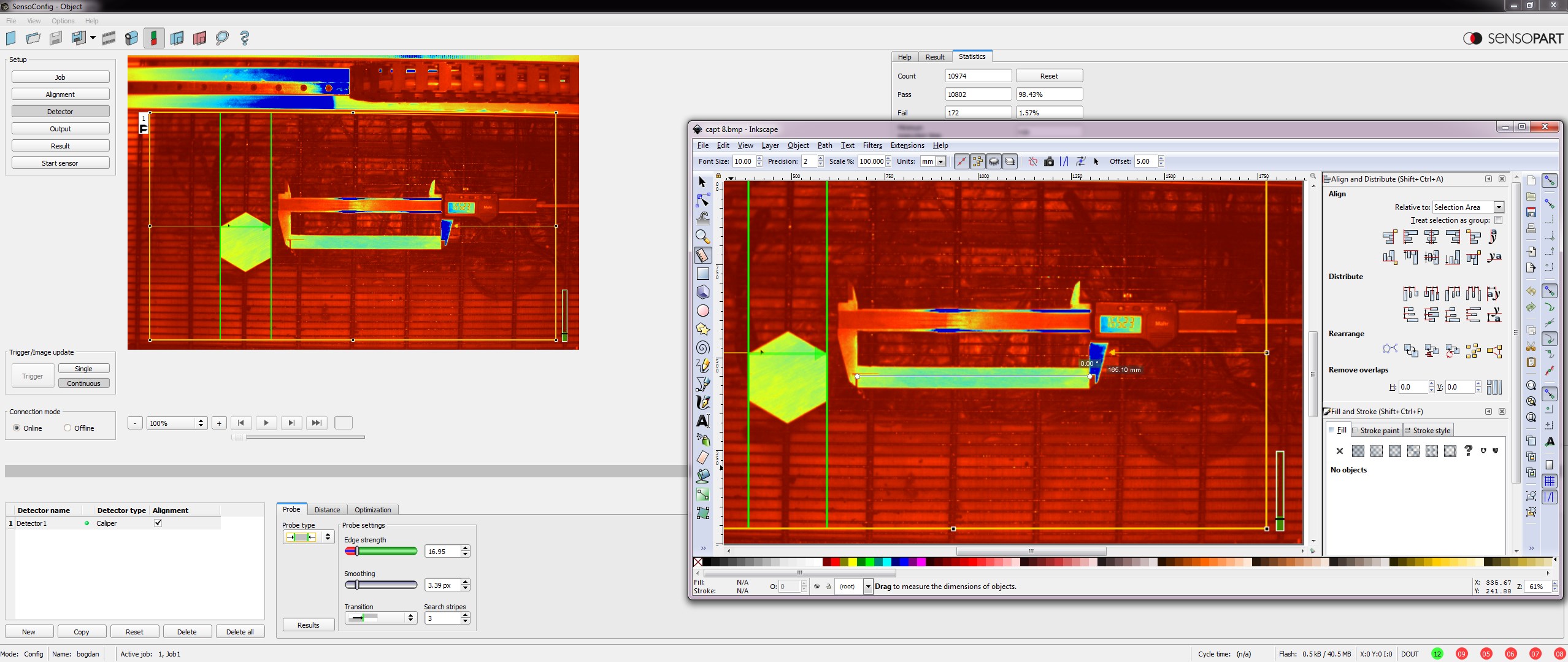

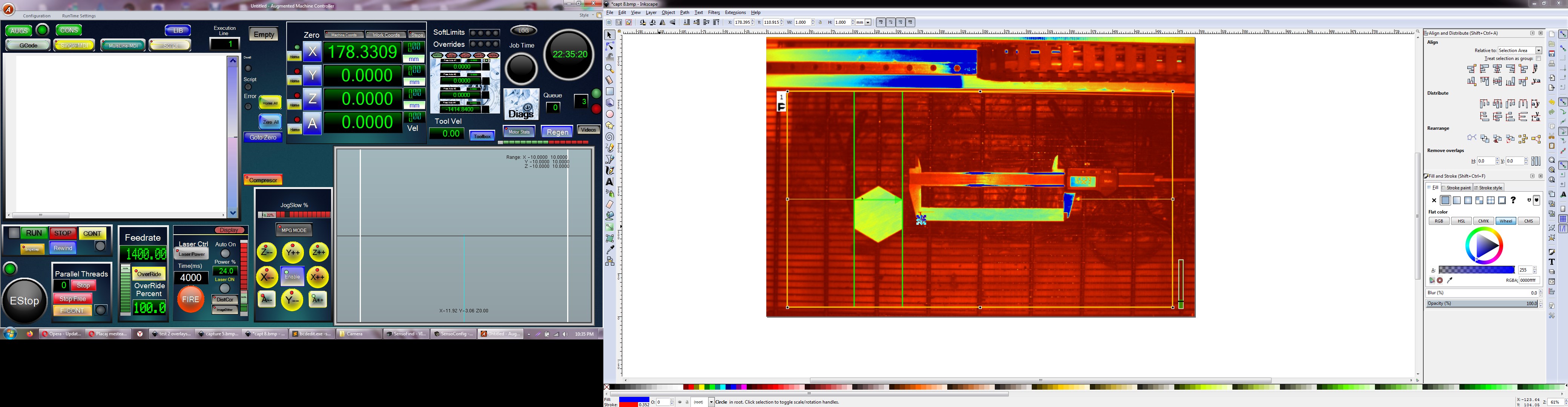

One of my old problem was to engrave on some small objects a part of them surface . I noticed is very hard to align the perfect possition on that object . Actualy tou need to made some tricks to find the perfect coordonates to engrave on some spots.
So i was thinking to create a extension in Inkscape to be able to comunicate with a " possition sensor camera " and the coordonated and picture to be transfered in Inkscape with some filters and in that way can be able to
put the engrave part in the perfect spot possition .
So i start with that and the next [part in my ideea is to GCODE to be created as reference of that object coordonates.
Until now i was manage to create the perfect reference of object dimmension and to be able to have the perfect distance from X home to that object .
Still i have some problems with Y axis but i will figure out at the end.
The error of object size is maximum 200u and the same for X axis (senzor limits), but 0.2mm is not a problem anymore .
Doing that by hand definetly is more big error. That dont bother me now.
I put below some vids. The sensor is a VISOR vision sensor A10.
https://youtu.be/Iw03eUHwro8
https://youtu.be/as9MhaYxpaE
And some pic below . Thanks
Bobby
