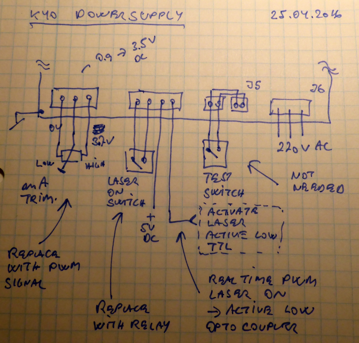

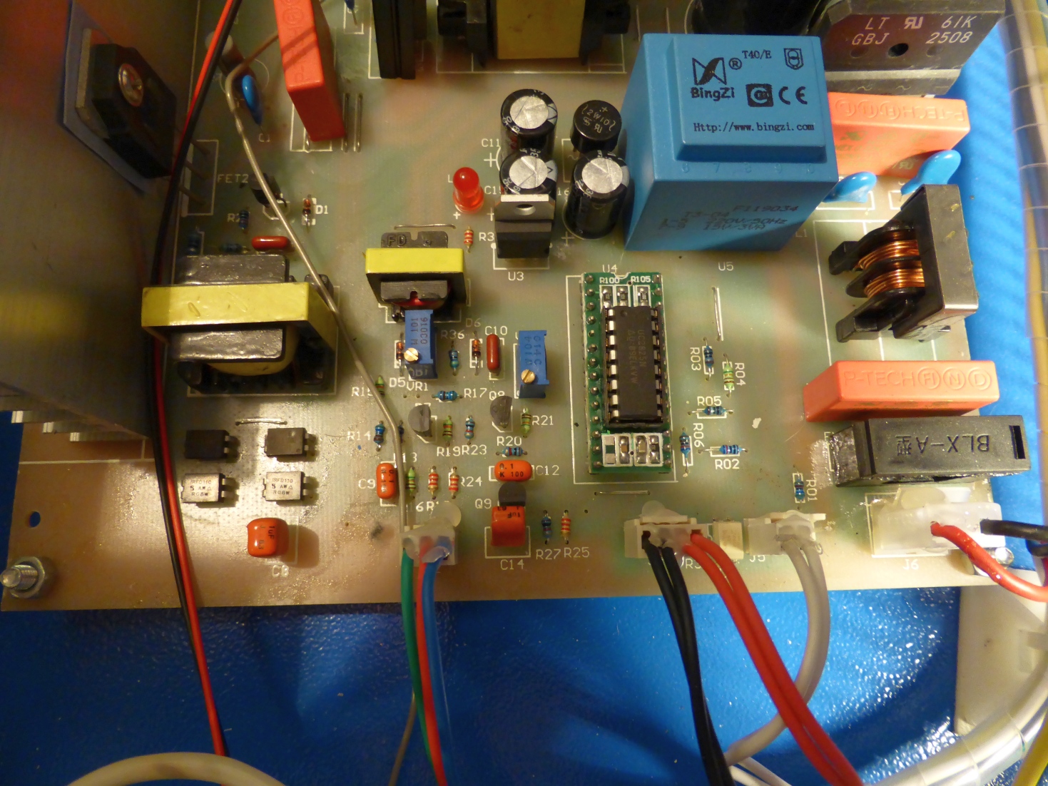

My power supply is a real Chinese Style, open and have few markings on it. Earlier I did some measurements and wire following to get a schematics of the inner working (hand draft attached).
With Mach3 I had the laser fire working, attached to Z direction signal and it fires when pulled low.
The laser activation (Laser On) can be a relay simulating the switch I have today.
Laser power (mA) can be a PWM signal simulation a voltage between 0.9V and 3.5V - now it is a potentiometer 1k 2W.
Test switch will be in software (Auggie).
First test will be the real time PWM and get it working.
Laser On switch and mA control can follow when laser fire is working.

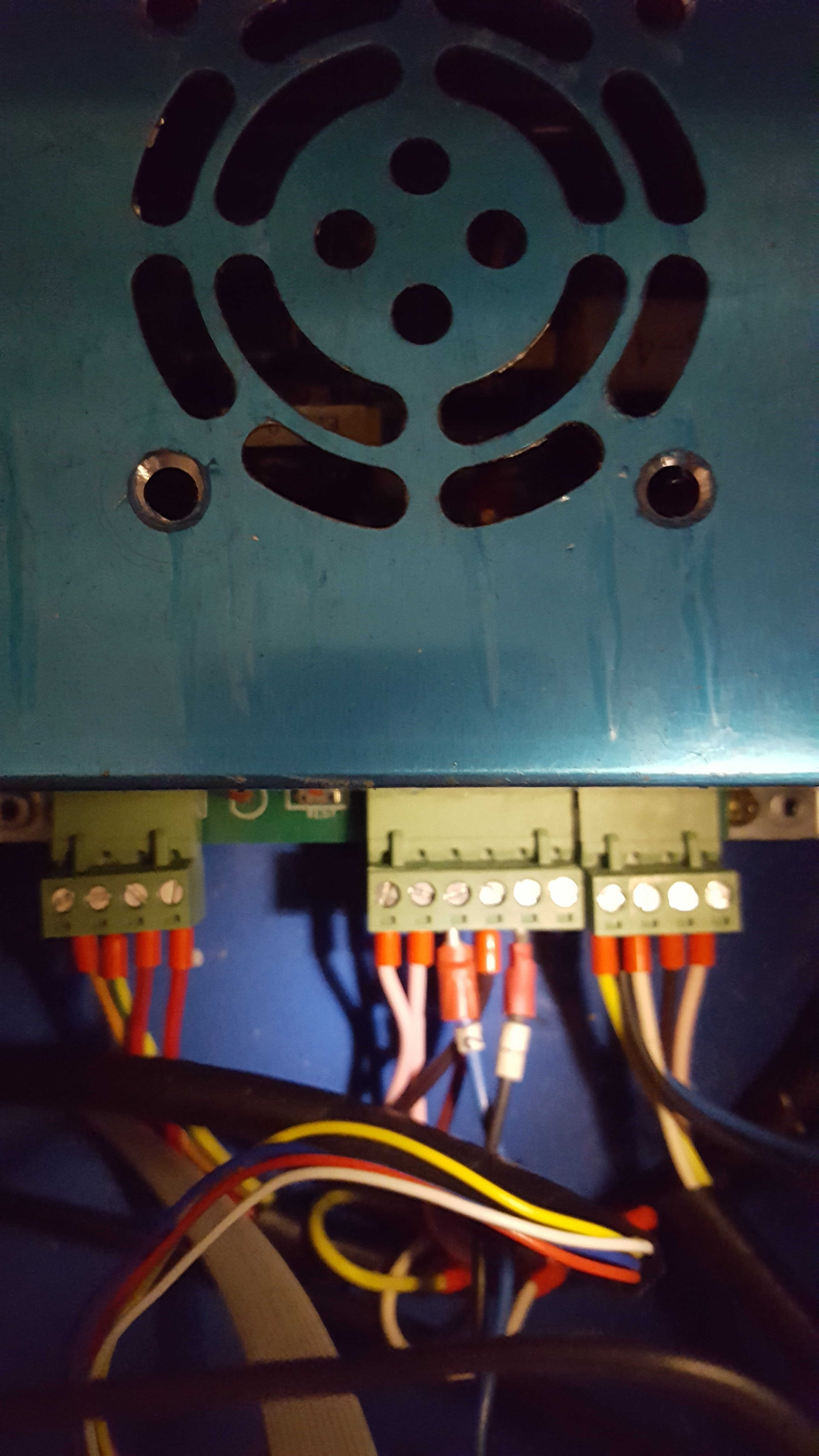

Re: Realtime PWM mode added.
Hi Joakim:
 Amazingly ( or not), yours is near identical to YaNvrNo's, who hooked up last night and will test shortly under Auggie.
Its always easiest to test with Pokeys software first when you hook up..

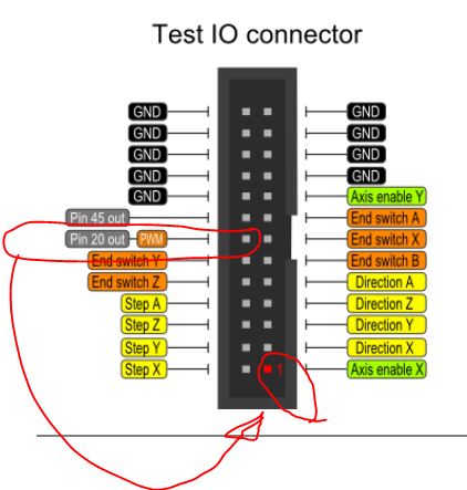

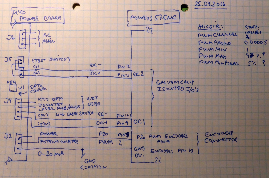

 So lets talk about the schematic, he hooked up different to you, but there are many ways to do it..
 OK, so lets talk about PWM first.. We disconnected the pot, and connected hte 0vdc line of the boards POT connector
to Pokeys Ground. This references the Pokeys to the board. We then used PWM Pin 20 on the TestIO connector
to the center POT pin. That pin, ioncidentally, has changed location, its on pin 14 in my board of the testIO connector,
and on Pin1 of YaNvrNo's baord. So check your board for version info if you decide to use Pin20.
  That connection will then supply the PWM. In Auggies Config/Planner, you will set a period of .00005 for 20Khz PWM
and channel 2 if you use the TestIO connector . ( I use Channel 4 here, pin 18 from the LCD connector).
That having been done, your PWM should now control the power.
 Now for LaserON, we used the Test Switch inputs, feeding  the positive side
of the test switch to OC2+ and the other to OC2-.  Also the Laser on was fed
to OC1+ and OC1-.
  On this board for some reason the test switch must be pressed for it to work.. I might add
his board is different than yours, a modification or revision Id think..
I use relay1 to control my laser on, so you may use relay 1 instead on an OC.. The
on, whether you use and OC or a relay, will have to be changed from what I use as
I use only the relay #1, and its triggered by the button on the screen , which has a
variable name that makes it trigger Relay1.
 So, if you get the OC's or relays you need turning on the LaserON or Test  button ( or both),
so long as the PWM is hooked up, the LaserSpindle script will automatically use the config/planner
settings to control the power.
  We're just getting YaNvrNo's working today, so Ill post updates as to where we were
wrong or add data to help you figure it out. He'll post if I have screwed up any
details, as he actually has the laser there.. I am viewing from a distance. :)
If confused, Ask away, we'll figiure it out together, but it looks like your well on
your way and very close to radiation..

One more piece of data, ( because threads such as this exist for years and many tend to read them for info..)
The following photo shows the Pokeys57 revision 2 changed the PWM location on the TestIO connector. As indicated by the arrow..
Ya-Nvr-No
Posts: 188
Post by Ya-Nvr-No »

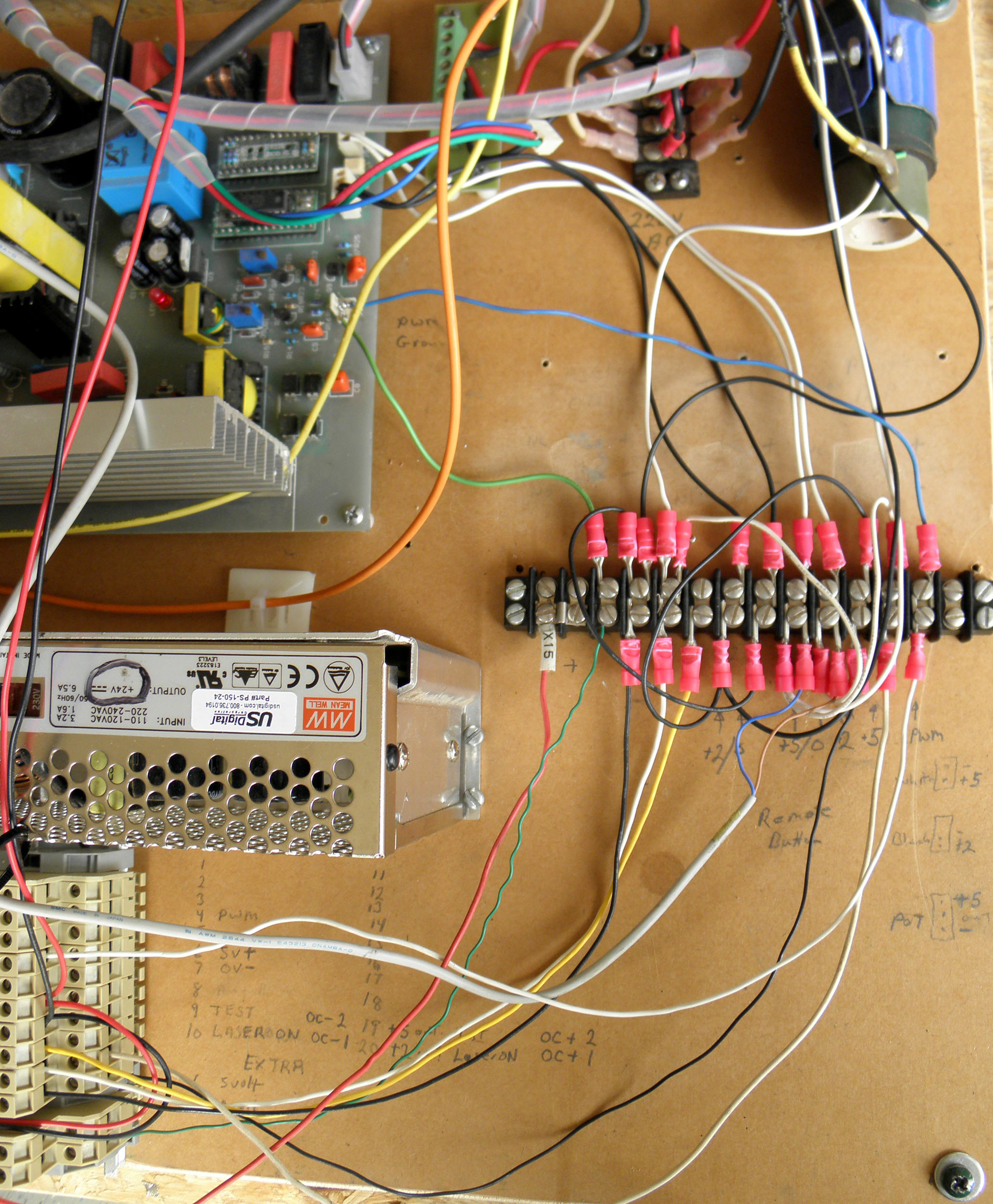

Here is a view of my wiring on the laser board, I tried to label the connections, but it turned out to be quite straight forward. That is other than the pot plug had to be removed for the pokies pwm to control it.
In my case I used the OC's you just have to provide the OC+ with the voltage source from the buttons (note where the +/- are) and when the pokies turns on that OC it closes the contacts just as if I pushed the button. I wired them so I can still use the buttons in a manual mode. I also added a remote Test button so I can fire if i need to walk around. (not necessary but it makes it nice for laser/mirror alignments)
So hopefully you can see on one side I send the signal over "TO" the pokies thru a terminal block then the pokies is connected OC- "FROM' back thru the terminal block. (more that you follow the logic then using this hardware)
And then the pwm test connector art showed in my photo above was just connecting my choice (Pin22 PWM2) back to the center tap of the pot with a common ground from both laser and pokies boards.
In my case it takes about 2volts to start to fire the laser, somewhere around 42% on the pwm slider. And that's what lead to the scaling routine Art created for your particular requirement.
Safety Note: stay away from the left side of the board if testing with button or firing laser. Take my word for it ;)

I have summed it up for my board and have made a sketch (only handmade).
1) The power is controlled with PWM 2 on Encoders pin 9 and GND on pin 10. (It is the same as DB-25 connector or Test IO connector but without the version confuse).
2)  The Laser On/Off button is connected to OC1 on the Galvanically Isolated I/O.
3) The Laser Fire (Test Switch) is connected to OC2 on the Galvanically Isolated I/O.
This input bypasses the opto coupler on K40, but it makes sense as Pokeys has its own opto isolation and the delay will be less.
Ya-Nvr-No:
I made the drawing before I saw your post. Only difference i see is that we switched OC1 and OC2. I haven't made the physical changes yet so I will change to match your configuration.
What I don't understand is the PWM connection to the power pot. If I measure the voltage on the center pin it is about 1.22V. Switching it to ground will not give the correct voltage (0.9 - 3.5V) as the pot gives.
I will keep the manual switches as well - good idea.
Just a short status - I will be away this evening.
J:
Looks good. As to the pot,  the center tap being connected to the pwm means it shoudl see from 0 - 5 as pwm goes up.
The 0volt line of the pot is connected to pokeys ground just to give it a referance for the pwm.. You do need to remove the pot
though.  You sould then be able to measure form 0-5 volts as you slide the pwm slider on the pokeys software..
If so, your good to go, we're runnign tests, so we'll tell you what to look for as we find weaknesses in setting up..

I only unhooked/hooked the TTL line and the PWN line (sorry for the dark blurry photo).
I did that to just test it out.
I still have to hook in the water pressure switch and a door switch but it runs.
I am pulling the 24v off of this power supply to run the Pokeys as well.
The blue wire labeled 2 goes to the Relay OC1
The black wire with the label is using Pin20 for PWM(PWM2).  I have it run through a small 3.3v to 5v booster circuit.
I used encoder connector since it had a smaller foot print.
The bob I am using is shown as well.
I will post a picture, I got off of the google K40 site, over in the laser stories side.
It looks reasonable.
Glenn
Edit was removing some possible confusion with the pin number P20 is PWM Pin2 not pin2
