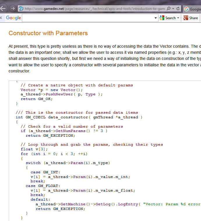

GlennD wrote: P.S. Did look up the Game Monkey and it does mention that no switch is available so blocks of if statements it is.  :D
I found this example and it worked for me.
Code: Select all
name = "pear";
switch (name)
  case "apple": { print("hurrah "); print("for apples"); } // braces are required
  case "banana":                                       // Fall through multiple cases
  case "pear":
  case "cherry": { print("fell to fruit", name); }
  case favoriteFruit: { print("my favorite fruit"); }     // allow variable cases!
  default: { print("no fruit for you"); }                 // Default not required

Group, sorry about the switch thing, I thought I had tried the braces in the case portion guess not.
I had tried several variants before I went looking at the Game Monkey stuff.

Even funnier is when you look further down on the page as linked above and where I found that it said didn't use switch. you see switch used in the Constructor with Parameters example. &nbsp;The example isn't using the braces.
