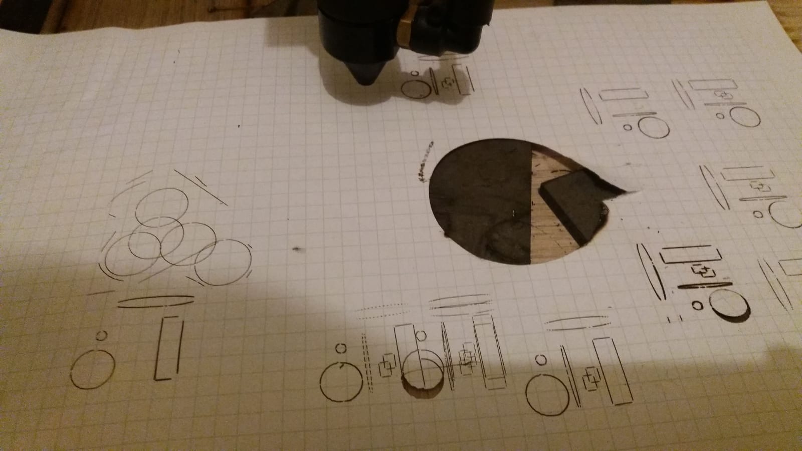

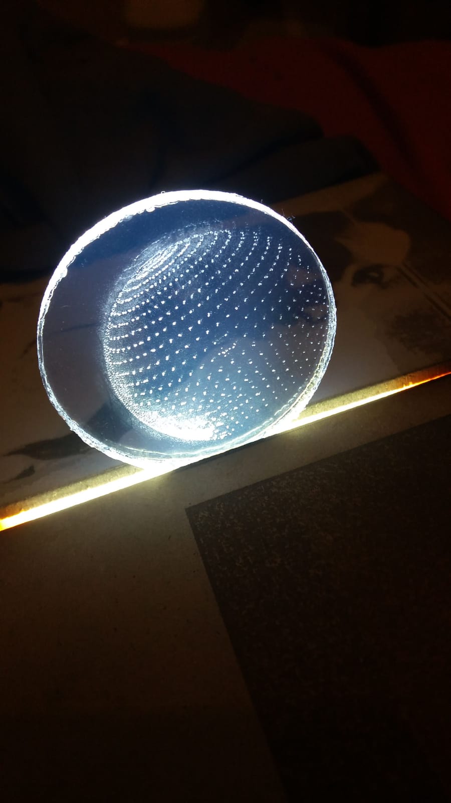

Not that fast Art , not that fast > Is true , on engraving i try almost everything , and day by day , gett'in better .
I try on glass, back of the mirror , working realy nice , almost all materials i've get.
The problem now is of cutting that's materials.
I try some shapes , and on circles was realy strange .
I try to made the DXP file in Corel Draw , no way to can group all objects > No skills in that type of programs.
After i try in inkscape , create DXF and import in vexx to convert to GCODE> then , on lines work but on circles , no way ,
the laser don't even shoot , only on the big circle i draw, but interrupted line .
I put the file below , what program i should use and what is the best option ?

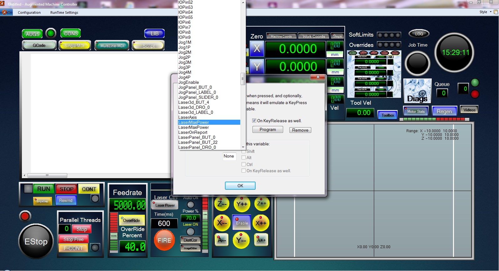

Re: My laser engraver from 0 knowledge to .... i dont know
And on the small circles laser dont even shoot. I will made more test's.
I have a question . I open the Gearotic software for curiosity , and i saw there on image processing , is the same AUGS used in Auggie to generate the code but not on same size and less options.
It is possible to have the option to can made that to run also on full screen ? That should very useful , on small screen you can not realy see what truly happen with photo.
Bobby
Yes , i figure out that .ArtF wrote: When you run such a file, you have to manually do the M3 to enable the laser before
running the file.
Yes , that i notice , on big circle i saw the interrupted power , so i figure out are not a continuous arc , just small segments.The circles imported from the DXF as line segments, not circles
My feedrate was on maxim is writed in config. 12000 , run ok now when laser move without burn . But when i decrease the percent , i saw the power will drop considerablyThe speed the circles
will achieve is a mixture of requested feedrate, and Jerk from the radius of the
circles.
Bobby
Hi
This night made me crazy , I can not rid off on that stupid ellipse. Engraving working fine , i can do almost everything
i want .
The problem is on cutting. and is not about the power, i have a lot for what i try , is about my settings that for sure
First , i try all the speed and mixed , also i figure out what "jerk" do, i hope :-[
(i didn't figure out what mean , look ahead , and radius settings)
So, If i made one shape , as square and i set some power speed , feed for that , working perfect . How i wish .
If i made a circle, also working. The problem is on different size of circles. On small ones , he don't even burn
also on that circle he like just stop for some ms and made a short gap without burn.
I made a bunch of test's on paper , just above to pass trough , and i figure out , soon the curve going small power decrease radical.
Can be the problem because the motors don't have any reduction rate, Are directly connected on X and Y .
That can be a problem ? They have a lot of power , that why i didn't mount any reduction well.
I can run so fast to almost break my axes , and don't even get on half on load current on motors .
I'm totaly lost now. I give up and go on sleep to clean my head
I put some photo below.
Hi Bobby:
I can see a problem or two in your tests..
All your boxes show on takeoff the laser isn't shooting at the start..
This may explain small circles as they never get up to speed. So a couple things to discuss...
First, as the laser takes off on a move, the formula for power internally is
max( minpwmsetting , (ActualSpeed / Feedrate) * power )
So in the config, the minPWM sets the startup cutting power as the axis
starts to move if the axis is so slow the power computed is less than minPWM.
SO to set this approximately correct, make a square
in gcode. Cut it as you have and if there is no burn at the start of each
corner increase the setting Planner/MinPWM until you see each corner
has been cut. Set you feedrate so your table actually hits it in the velocity DRO,
(or close anyway, it doesnt have to be perfect..but if you see 1589 is the fastest
it goes, set the feedrate to 1600 or so. )
The second problem is that feedrate and jerk are related. Jerk is defined
as the amount of mechanical jerk the machine can do, or how much jerk
occurs during a move. As its lowered, the axis will move slower. As its raised,
the axis will move faster.If this is too low, you will not be able to move
fast enough on small segment programs. Another consideration is
look ahead. If a circle is made of hundreds of Gcode lines, the program
can only see ahead by the setting of Lookahead. Change this to
300 or so and it can see and thus plan for higher speeds.
If you run a program without laser on, see what max feedrate is achived in
that small circle , the math is that a small circle may never hit the feedrate
you desire, so power will never hit it as well. For example, if your feedrate
is set to 5000, and you have 2 circles, one large and one very small.
The feedrate in the large may hit 4000 ( for example) but the small
circle may only hie 1000. If so , the power of the small circle will be 1/4th
the power of the large. In this case the feedrate for the program should
be set to 1000. (Or a feedrate for the small circle of 1000 and for the large
4000.)
Jerk in a circle is computed as a function of its radius. The larger the
radius and mathematically the smaller the resultant jerk. Smaller circles
have larger jerk.
So I would first look to the square and adjust the minPWM to make it
start that corner with power high enough to burn. If you turn off
DistCorrection ( button on the laser control), you will then get
the set laser power at all times during motion, which can be fine in cutting
but will cut harder when its slow due to planning motion.
It takes some playing to get this right. Unlike normal CNC where motion
alone is enough to cut, Auggie needs to get the power to be properly proportional
to speed, which is why all the power settings.
Let me know how the squares corners come out with adjustments and we'll go
from there. :)
4000.)
have larger jerk.
from there. :)

So , i made the test how you say .
On beginning was the same , after i rise "jerk" to 6000000 (i was annoyed in that moment) and surprisely , he cut nice the square .
?? How much i can rise the jerk ? Exist a limit value for ?
Also i put min PWM at 20% , i have second power control at analog on min/max power and i set the power just to barely cut the paper.
I notice , the tool hit almost all time the feed set , excluding that small ellipse when decrease the power.
I put on max CV radius 0.10 (what is hes effect ?) i didn't notice any diff.
https://youtu.be/LU0qrUX1Pxw
AND not at least , today i find out you are the creator of Mach 3 , man , a awesome work realy , i never used but , every time i look at one video about
machining , that Mach 3 remain in my mind. Again my intuition didn't fail . I have such a big respect for you .
Thanks for everything you do for as
Bobby
Hi Bobby:
Jerk can be a large number. I sometimes use 1000000 and sometimes 50,000,000,
depends on what Im doing and how it reacts. Setting Jerk very high basically reduces
smoothing, but some systems dont need smoothing so a high jerk is fine. The limit is
in the billions I think..
That last video looked much better. If your doing an ellipse there are many small moves in
some code, so make sure your look ahead is high.. maybe 400 - 500. This helps the planner get
up to speed. Small circles calculate jerk a bit differently as they have to take radial vector
pressures into account. Its all a balance, but I think your getting there, the last video showed
your very close to what you need. Play around with jerk and feedrates and eventually it will
sink in how they affect each other.

Hi ..
Thanks everyone for help. I figure out what " jerk " and other variable do . I manage to have constant power on
cutting almost on any shape i made . Now trying to script a "air button " for air assist , i found that library was already created
by @Ya-Nvr-No , and of course did't work , so . I start to look on you videos on youtube , and trying to see where are located all
variable in the system , i found some variable (including " AirAssist " ) variable , is duplicate in the my system.
That affect some how the Auggie funtionality or is just a visual bug ?
I put below a screenshot of that
Bobby
