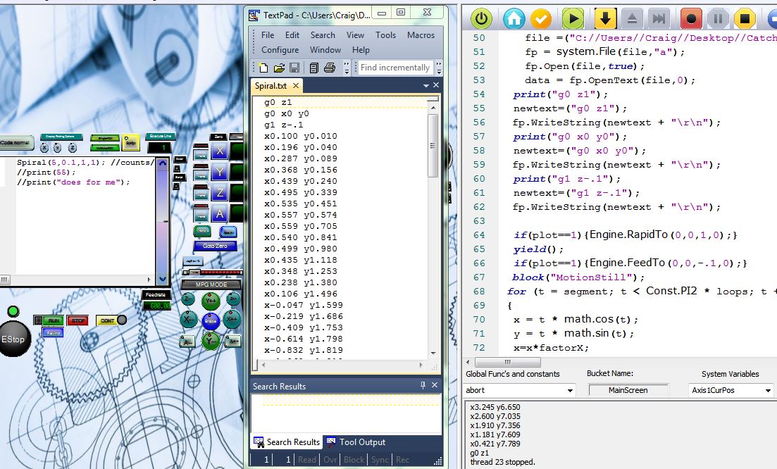

Re: Shared Functions()
I read some concerns about scripting and motion directly from scripting.
Well why not open a file in the function and write to the file as formatted gcode?
after all its just math and numbers all doing the same thing.
What do you think a Post Processors does ???
So there is no reason not to create functions that can give us unique shapes and post the data out to your gcode read only controller.
Embrace scripting as a new vehicle to give you a new creative tool.
PS: This was my crude way to do it but it shows that its an easy process.
I'd like to see a function created, we just pass the positional data too and it writes the Gcode.
that way ever function can use the same GCodeOut() function
A function that would take info out of a .csv would be good, then you could do a spreadsheet and use voronoi math to do spirals. I have info on how to do this in another computer language.
I might see if I can find it and have a play.

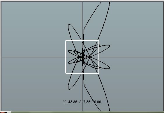

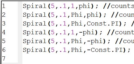

playing around, made a couple alterations.
global Phi=Const.Gold; //Fibonacci Golden Ratio, a special number approximately equal to 1.6180339887498948482
global phi=Const.Gold-1;
x = (t * math.cos(t))*Phi;
y = x*((t * math.sin(t))*phi);
tweak the sign can give you some big changes and can create some interesting patterns.
learn what tables and arrays can be used for and how you can take spreadsheet data and paste it into one or more tables. Then use the tables as a source of data points.
Investigate web sites that teaches or inspire you to use math again, like: http://mathforum.org/dr.math/faq/
find some old source code that does something cool or you can relate to.
maybe something you would like to see plotted or someday cut out for a conversational drink holder or welcome mat.
teach your kids how math is something they can have real fun with and produce their results with your machine.
Auggie can be an inspirational & educational tool that produces CNC movement for the creative and/or inquisitive mind. 8)
