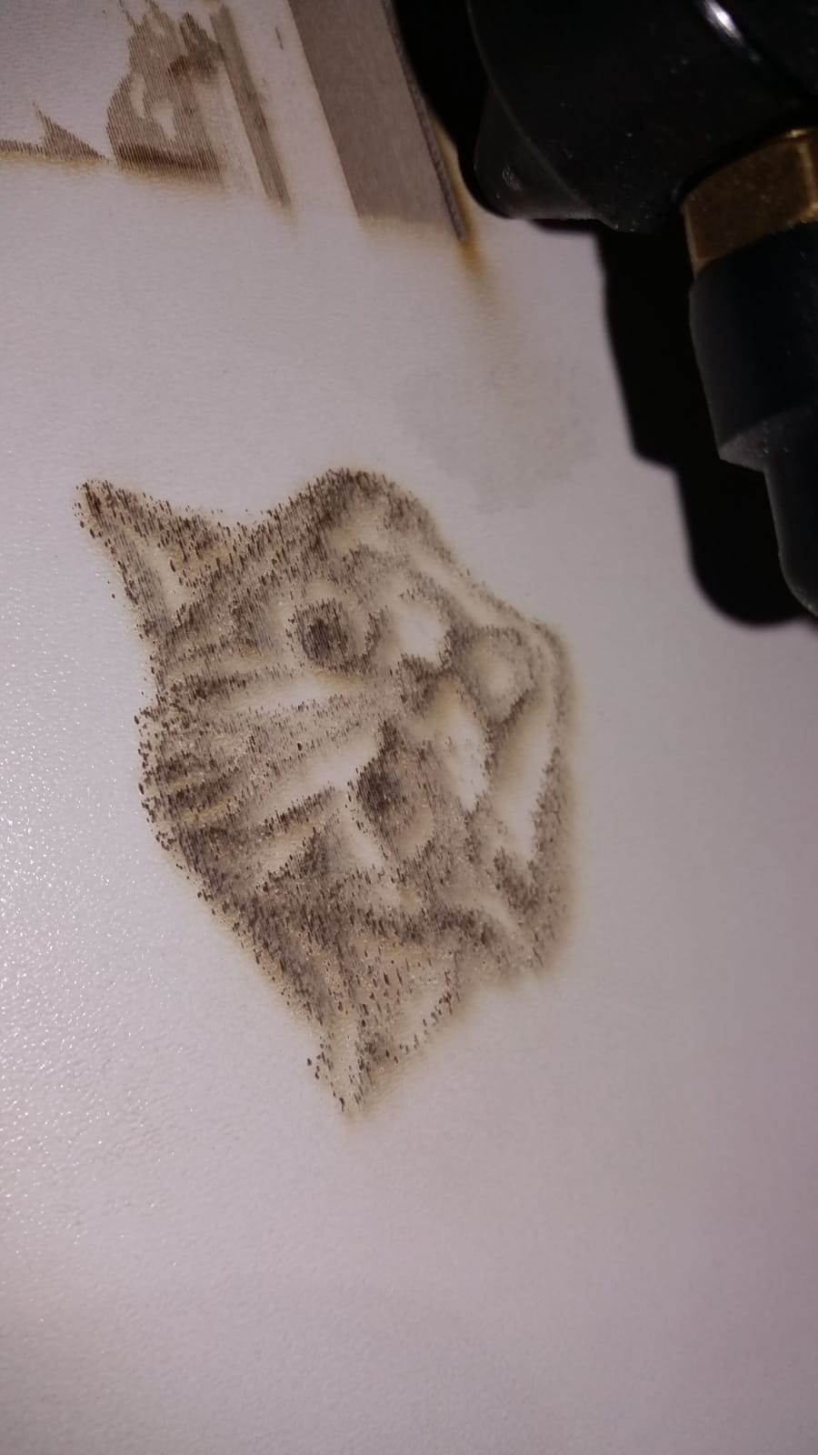

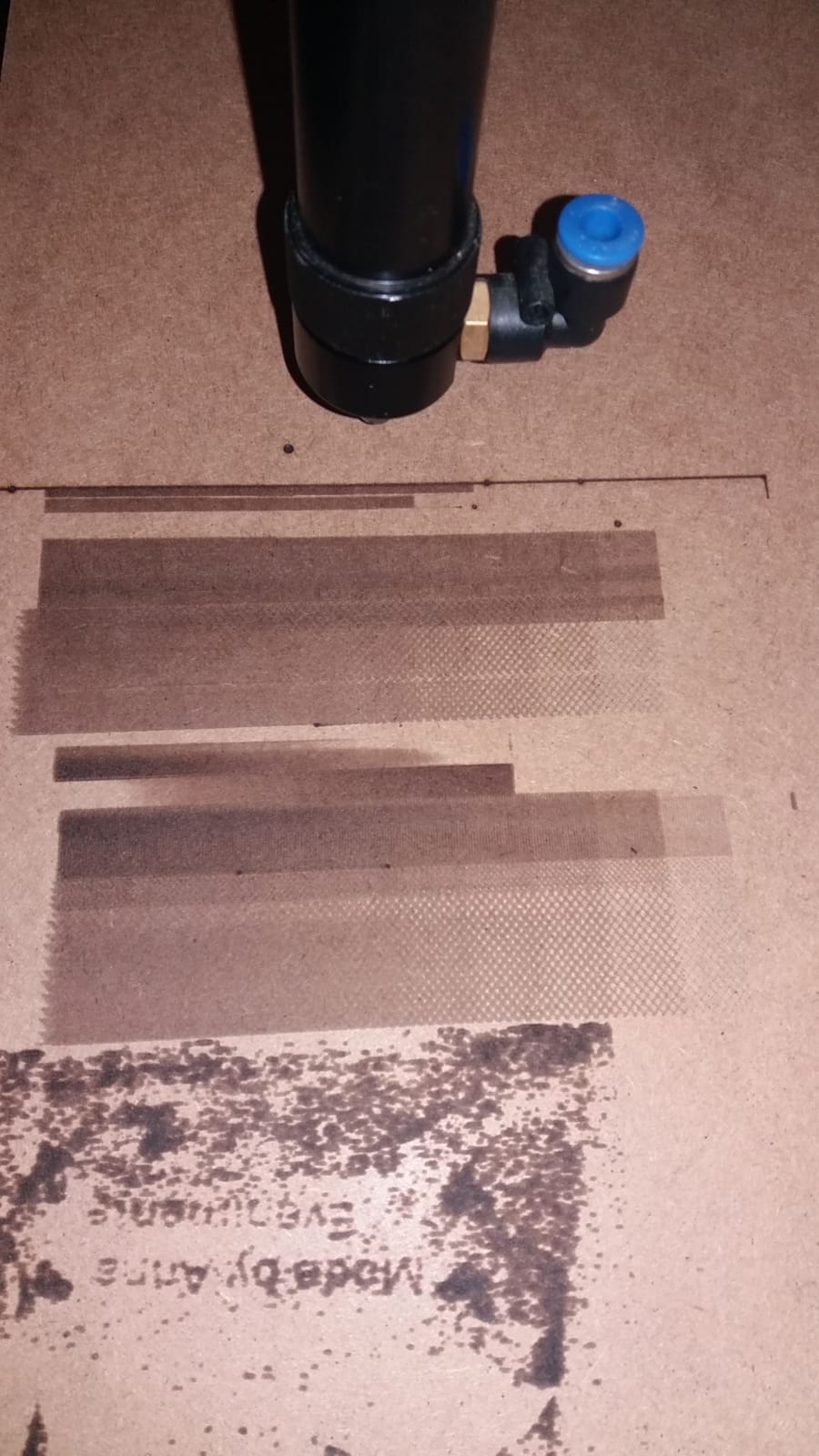

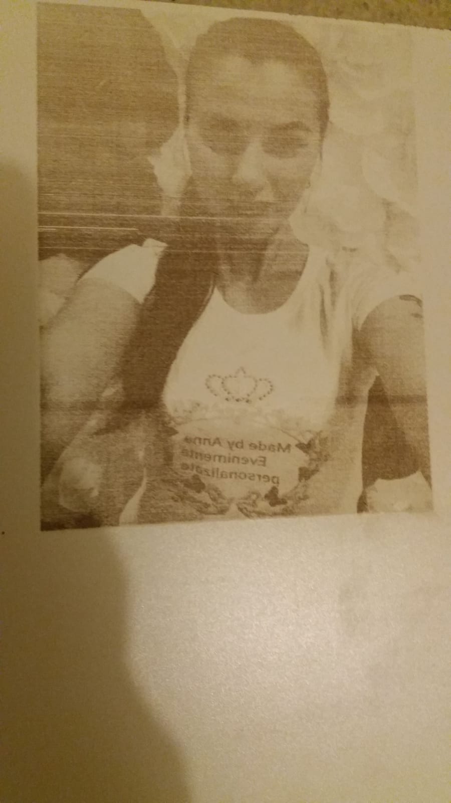

I can't stop myself to go on sleep, i made some fast and small test's.
1: First i connect the PWM to TL input and on analog input on the source i set the voltage on 200mv . I play with some feedrates and here we go , some result arrive .
First on you image and after on my . Laser was able to increase the power. I listen you advice and i put 100% at maxim , and of course the laser itself was limited by input analog vcc.
2: I found only the PIC 16F684 here , and i made a very small code , programed in real time with Pickit3 and i made some adjustments.
Like you see was pointed laser , on same image .
Also PWM set matter in my case in ouggie. If i set to high i get only full power , to low , the annoing noise from low frequency and resonances around 2khz  :o (probably was source reflection on they chinese drivers). Also when than noise come out , the laser remain stuck with fixed power (maxim alowed by analog input )
The picture say everything.
Also i think the material matter . That's a regular mdf , i cant find any different here around my city and i didn't has the time to search.
Thanks Art , i will let you know what happen .
Bobby

Re: My laser engraver from 0 knowledge to .... i dont know
Much better. I see more steps.
In my PWM processor I take it in, and measure it based on the 5khz I use. I then have an LCD
display that allows me to pick a %. If I pick 50% on the lcd for example, I will change an incoming
100% to an outgoing 50%.  If the arduino see's a 25% PWM, it puts out a 12.5% ( 50% of incoming).
This allows 100 steps of any power level set by the arduino as long as Auggie stays on 100%.
( Actually, do not go above 99% as i seem to have a bug at 100% that I am tracking down, it may
be in my arduino code but I need to be set to 99% in Auggie on my system for it all to work.
Now if I run a grey scale at 100%, I can set my LCD to 10% and get 0-10% power in 100 steps. )

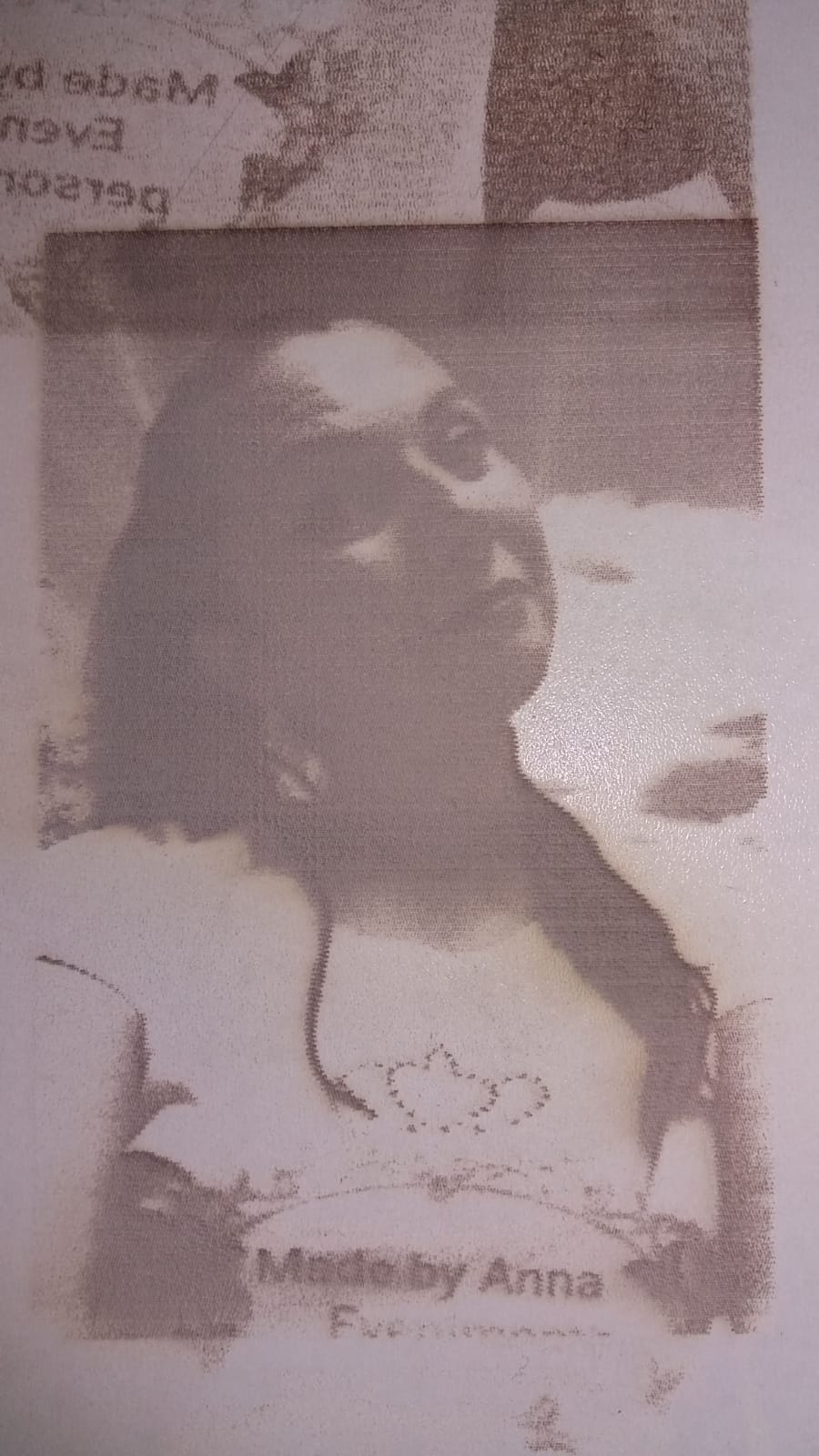

Hello everyone.
I was a little busy but now i have some free time again to play .
So , I figure out everything about feedrate , jerk limits and other stuff.
About my laser power , for the moment i programmed a dsPIC to deal with my PWM , I give up the idea to control the laser over analog input ,
and i use TH input and adjustable analog input . Like that i have 100 scale control and i notice if i convert the frequency to low frequency pulses
like 400Hz , the result are different , with fast speed on en my laser.
I attach below, the picture have some missing lines and that because i don't have the compressed air installed and the smoke keep gluing on my laser nose.
That is not a problem now.I will try for sure on analog input after my order with DAC converter will arrive , next week probably.
That's it for now.
Bobby

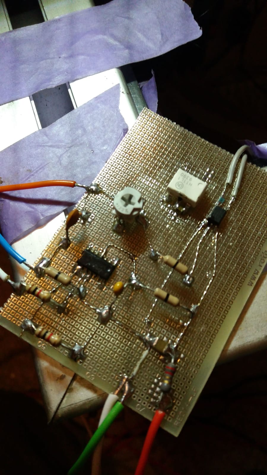

BobbyW
Post by BobbyW »
tweakie wrote: Nice work Bobby, you are making excellent progress and I look forward to following your thread.
Thank you Tweakie , i remember you has the first one who give me the advice about laser engrave.
Yesterday arrive my order with DAC and some optocouplers. The DAC working perfect (at least measured , not tested on laser) and let me to adjust the min-max voltage level from 0 - 100 PWM.
That's very useful for different materials and operations.
Still, connected to my stupid laser source the output become at maxim according with my reference set on 90% PWM. I think i will use an OP to follow the voltage with high current. Also like that i will be sure my input laser source will stay at 0 point all time.
And i manage to tune my motors how Art explain me.
https://youtu.be/a3QQo0dvWFU
That's for now.
Bobby

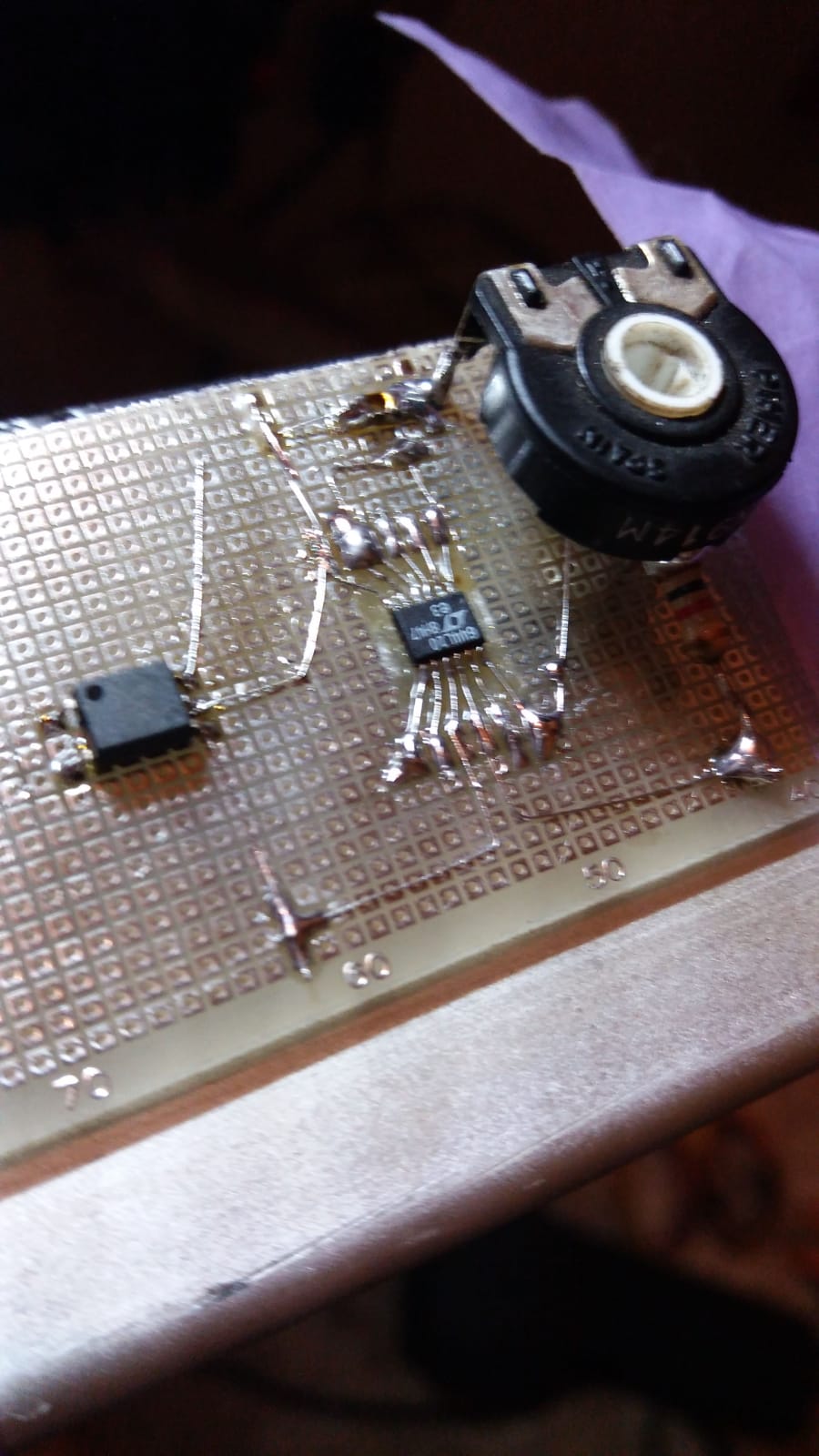

BobbyW
Post by BobbyW »
ArtF wrote: It looks like your coming along well

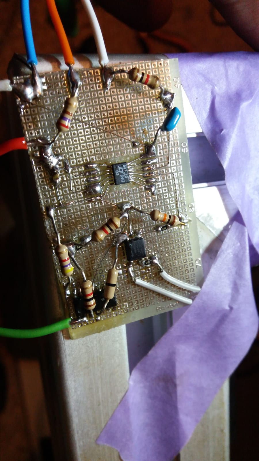

Yes and no. First of all i was needed to clear some things. One of them was to see linear on what analog voltage my source will delivery maxim power.
So surprise , surprise, on 2.68V input i get 25ma, on my Fluke , so was very calibrated measurement.
My first test with what i buy , was completely fail. Not because analog device is not good , because Bobby was a idiot ,
order in hurry and didn't read entire PDF. At least i made a good choice on optocoupler
https://pdf1.alldatasheet.com/datasheet-pdf/view/598737/CEL/PS9151.html
The PWM to DAC converter was fail , because dont let me to control the VCC in full scale reference by REF pin.
https://tz.infinite-electronic.hk/datasheet/73-LTC2644IMS-L10-TRPBF.pdf
Whatever soon my stupid source has that residual voltage input (the chinese creator let her like that , is written in PDF) i was force to deal with that.
So next help me the optpcoupler a log potentiometer and the most loved OP LM324 .
Now i can deal in full PWM range on any level. We will se if the laser respond in the same way >
Bobby
BobbyW
Post by BobbyW »
I forgot to say , the small potentiometer in the picture , is used to set the max power of laser , is conected to the external one (have 20 micro steps on full jog).
Now i thinking what simple was to use a pre-amplifier IC controlled by voltage . Ahh , but is ok like that , i will test later .
Bobby

Now about my linear vcc circuit , it works realy great , more nice than i expect
The "magic" is done by optocoupler , he work so nice , https://pdf1.alldatasheet.com/datasheet-pdf/view/598737/CEL/PS9151.html the operational i use to filter , voltage folower and to adjust the power , is in full range , i let auggie at 100% power, is so nice to have now so many option to adjust . I was afraid my laser is to powerful to engrave , but was definetly my fault. My first try " just import a photo and generate " no any filter or any adjustment's , and still is decent on that shit material.

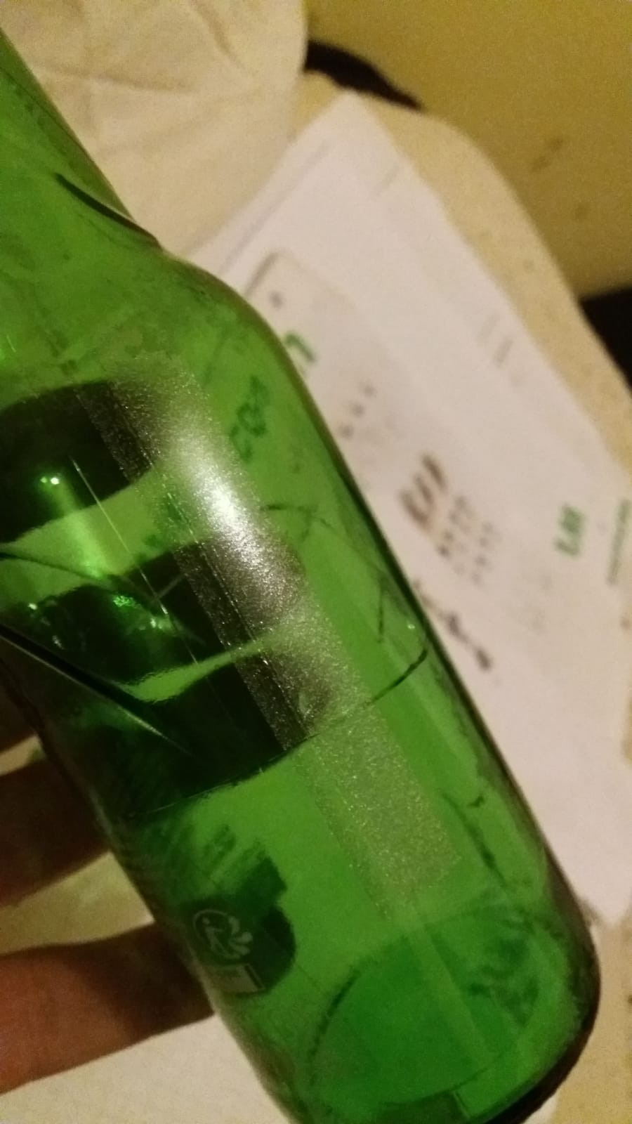

What about that material PMMA, is that acrylic ? They say are acrylic but they have a "special" way to spell the words .
https://www.plaqueplexiglass.com/perspex-chilli-red-frost-s2-4t50/
I made some test on glass , what i can say , working very well .
And.... on 3D engrave , wow , what i can say , working realy well , a realy nice texture .
You will notice the great job on last pass , if they are more than 3 .
Bobby
