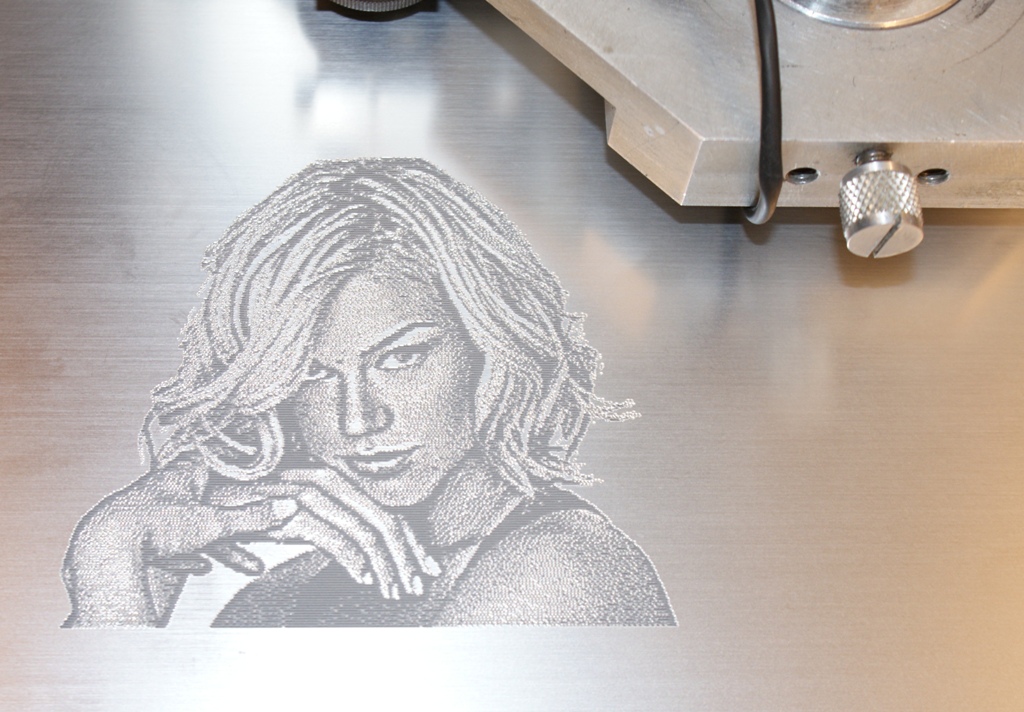

A previously used image converted from 8 bit greyscale to 1 bit dithered and then reproduced using an impact magnet.
wow, certainly decorates an aluminum plate. Nice work!
Thanks Art.

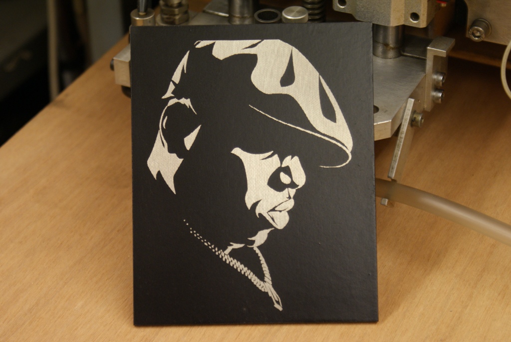

This 1 bit image was laser produced (etching black paint off aluminium).
