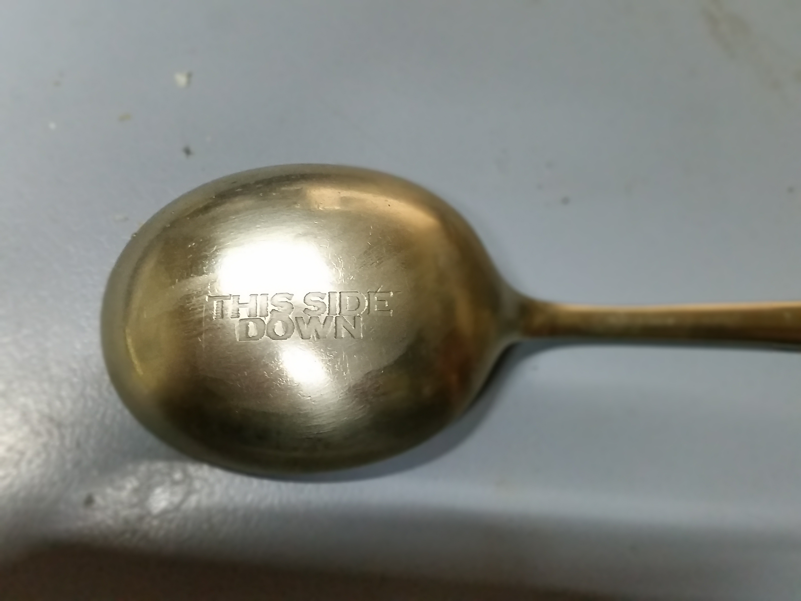

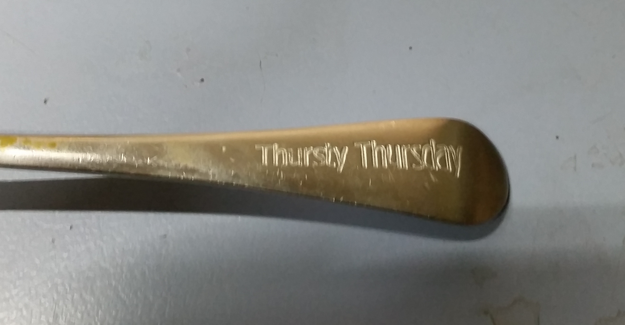

ps got a 15w diode laser [chinese watts , realistically 6w] , love it . can cut 4.5mm perspex providing its not clear or white.
red / black best&nbsp; 8-9 passes @250mm/min for 4.5mm , 4-5 passes for 3mm
pcb mask etching now @ 500mm/min is 3x faster than with 3w laser
pps
the paint masking trick is brilliant for chemical etching unflat metal surfaces
