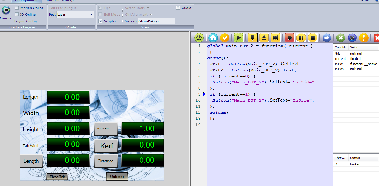

A quick question on the SetText and GetText if you have time.
I have a button I want to change its text based on the state.
I started my button id as just 0 or 1 initially then thought I would add a 700 in front maybe to differentiate them.
Here is the different examples to see if I could get the text from a button.
Figured if I went that route I could figure out how to set it from there.
Since I tried a bunch of different iterations last night and today on the SetText with no luck.
Code: Select all
mTxt = Button(Main_BUT_7002).GetText;
mTxt1 = Button("Main_BUT_7002").GetText;
mTxt2 = Button(Main_BUT_7002).Text;
mTxt3 = Button(Main_BUT_7002).text;
mTxt4 = Button("Main_BUT_7002").Text;
mTxt5 = Button("Main_BUT_7002").text;
but= Button("Main_BUT_7002");
 mTxt6 = but.GetText;
"but" does show the hex val of the Main_BUT_7002
As you can see the .GetText gives a function:_native
The .text and .Text stay as null.
I even tried getting the text of a label same results.
A perfectly good answer is it is not hooked up yet and I can wait.
Or numb skull do it this way or that ain't happening.  :)
Glenn
Re: Shared Functions()
Hi Glen:
  There are a couple ways to do that really. The way I recommend is to use
mybut = Button("Main_BUT_88");
mybut.SetText("New");
  to get the text you can do a
text = mybut.GetText();
  FYI:
    When your typing these things, type the words  "mybut = Button"", then left shift and click the button,
the rest will fill in for you.. If a button text doesnt set.. check its ID is unique..
GlennD
Posts: 80
Post by GlennD »
You forgot the you numbskull part.
I tried everything except the parentheses.  :D

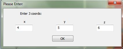

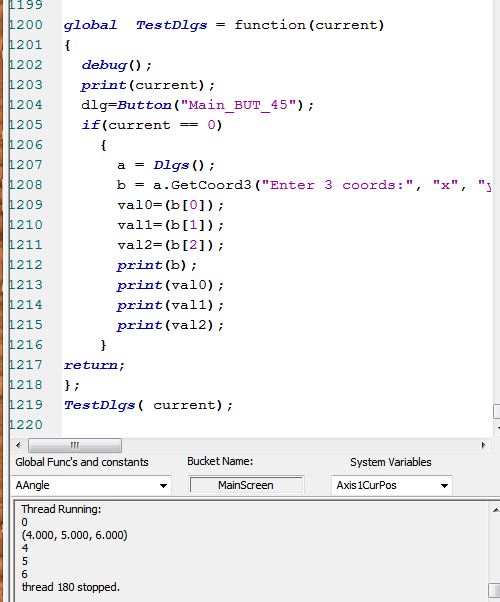

You might like Dialog popup boxes too, in this example called with a screen button named "Main_BUT_45"
Code: Select all
global  TestDlgs = function(current)
  print(current);
  dlg=Button("Main_BUT_45");
  if(current == 1)
      a = Dlgs();
      b = a.GetCoord3("Enter 3 coords:", "x", "y", "z", Vec3(4,5,6));
      val0=(b[0]);
      val1=(b[1]);
      val2=(b[2]);
      print(b);
      print(val0);
      print(val1);
      print(val2);
return;

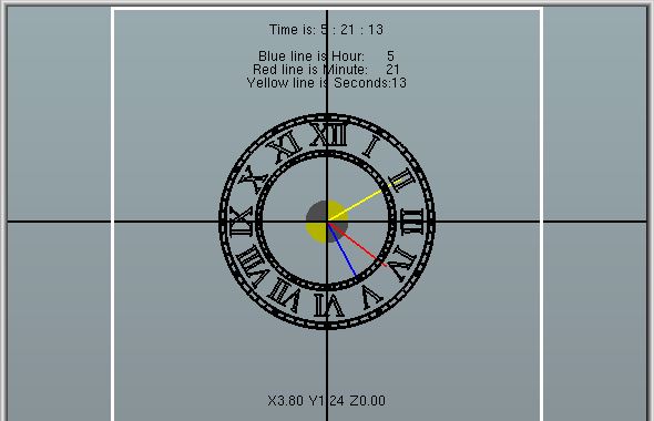

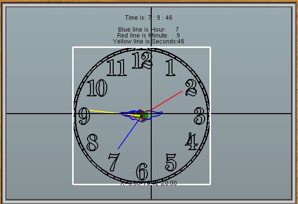

Been working on an analog clock function that takes the digital values and converts them to polar rotation, then I overlay a dxf file clock face. All cool stuff that can be done with scripting. :) (and then hopefully used to output to the machine controller)
Sorry I'm not very good at capturing the screen display and the correct seconds value,&nbsp; :-[ (I'm old)

Running a Gcode program while an analog clock script is updating on the screen, and a very short video
https://youtu.be/qaumU9BthKs

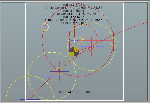

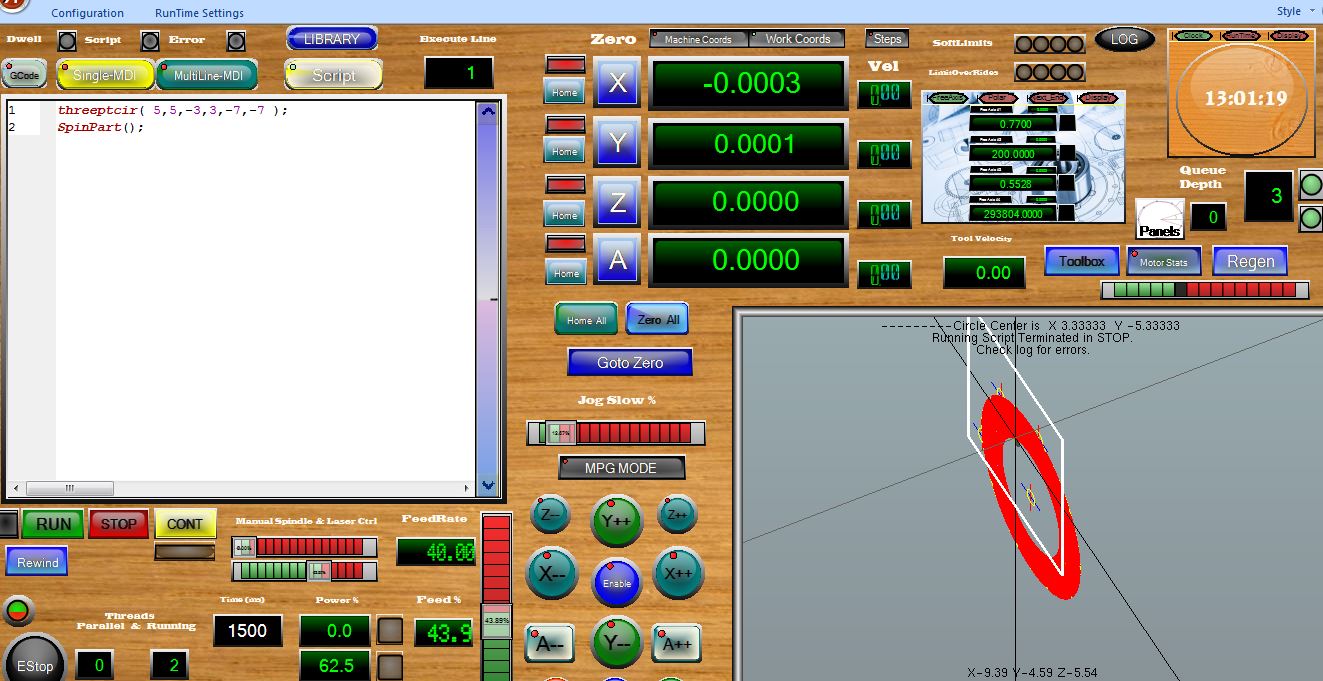

Quick video of a function call that uses 3 points to determine the circle radius and center.
I added the code to the beginning to clear the screen and also could show all three calls together. Now it will be part of the Library and as long as the check box is on, it is available to use. I am also using the pattern call from the library to display the points and the center of the circle created from the points.
https://youtu.be/p4Jv4hvptvM
added one to show some graphic patterns and spinning using a function call
https://youtu.be/ndLadbfkC1s
