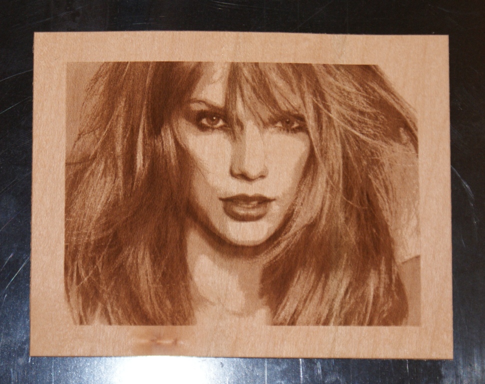

We have had a couple of days of snow here in the UK which just about brought everything to a standstill. As a country we seem to be just so unprepared for anything like this. I could not get any collections or deliveries and work was put on hold giving me the opportunity of more playtime with Auggie. ;D

Nice burn. Good grey scale. Im waiting for my theta lens, my galvos
are tuned up to speed, and Im looking forward to some test burns next
week to see just how a galvo with 50 watts on it can look..
Hopefully, I wont be disappointed, but if I am a firestar laser is a good
starting point for a conventional laser engraver.. :)

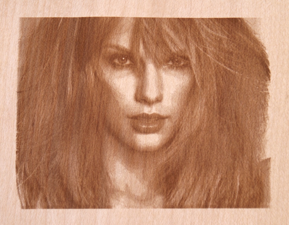

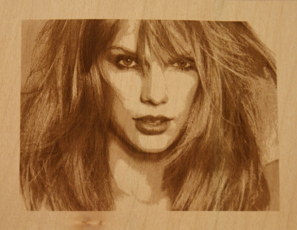

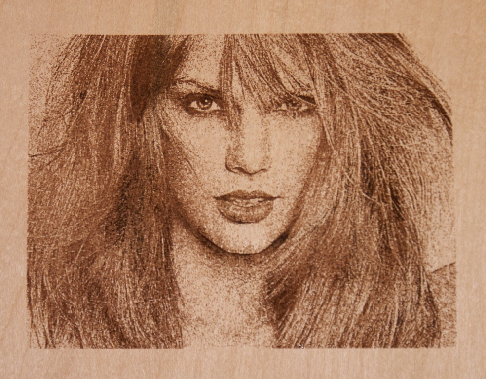

Still playing :)
number #3 I think.. :)
I agree, #3 offers the smoothness look of the three, good job Tweakie
Absolutely amazing. I'd be ecstatic if I could get ANY of those 3 images burned.
