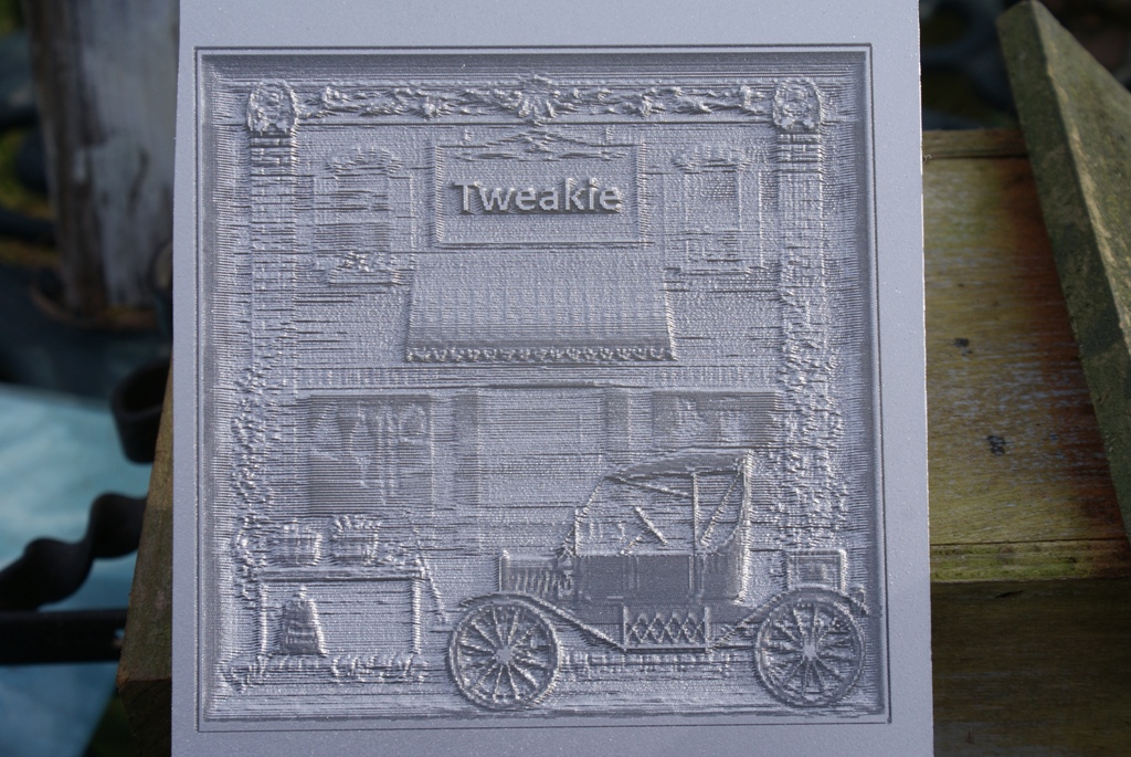

Hi Kirk,
Yes indeed sir, it's the same machine although there have been a few changes and additions. The machine is mainly used for rotary engraving and the laser was just added as an extra but it works as a multi-purpose machine. Check out the pictures etc. on my website for the deja-vu ;)
Sweet image.

One other note, the Aug button can create both 2d and 3d laser engravings, the 3d is
made by using a grey scale depth image, (they can be created by saving a grey scale
image of an STL display). Nothing the Aug button does actually changes Auggies
operation, it does all the things it needs to do in the GCode file, so by looking
at the weird additions to your GCode you can get an idea of how the Aug button
works, and how you can do the same things in your own GCode. GCode commands
are available to load binary image data , vary power for it, adjust the power in
stages related to depth for multi-pass 3d work, and to reset the variables that
control such things. Its kinda like Mach3's P words for laser power on/off,
but on steroids. Take note that for engravings the Gcode is loading a data file
that is the same name as the Gcode file. The data file is just a binary format of
a normal grey scale image.

Thanks to YNN for posting the depth map image on his website - I had to give it a try.
:), I have a few of those hanging about..

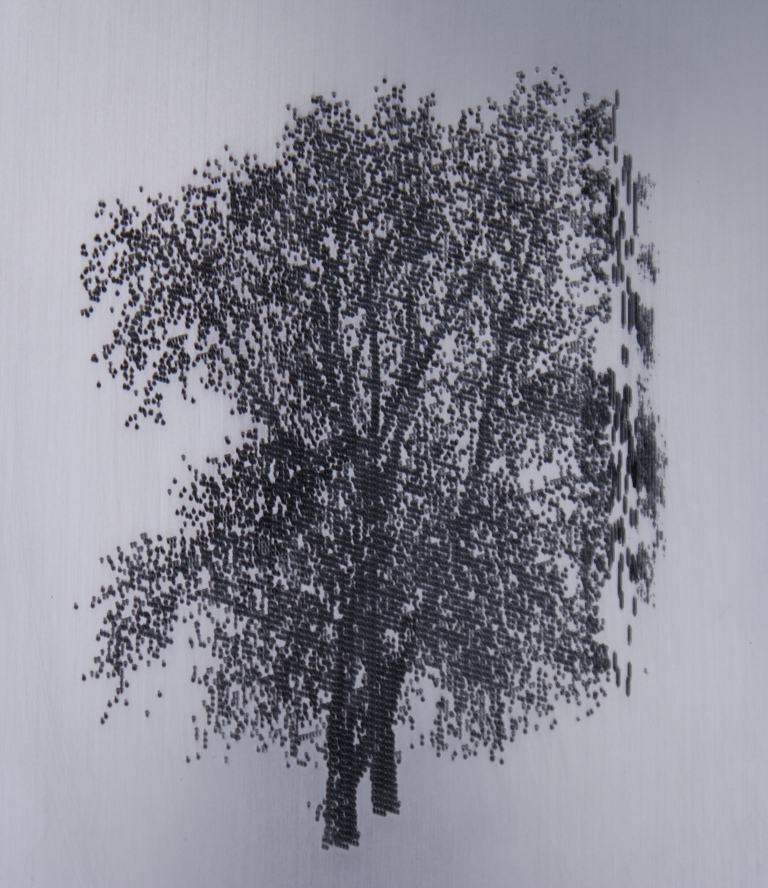

Now you have to use a bit of imagination here because this result is really not very good (still learning) but I thought it may be of interest.
This image was produced using Auggie and an Impact Electromagnet.
Well, I have to say its pretty good. The patterns seem almost random, but from any distance the effect is very good. Was this done witht he laser PWM output? , or just
a binary ouput?
a binary ouput?
That was just using the binary data from the PWM output (I am still working on the magnet driver which will convert the PWM to impact weight).
I was wondering if the pwm would work for an impact.. seems it does,. :)
Impact magnet operation is definitely possible with Auggie but axis velocity has to be a lot slower than with laser.
Although the cost of diode lasers is constantly falling an impact magnet set-up is relatively cheap and it makes a remarkably good job on binary materials (such as granite). Who knows, it may give Auggie an appeal to an entirely different group of users.
