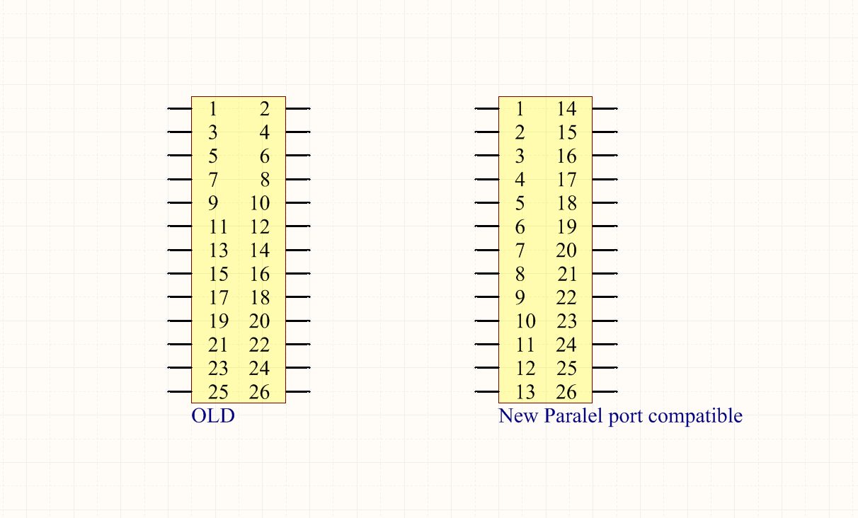

>>>>> On PoKeys57C NC version 1.1 ribbon cable connection is not compatible e with parallel port. However New PoKeys57C NC v1.2 hardware which is available now has parallel port compatible e pinout.<<<
I assume this is a hardware change? Not something that can be reconfigured in software? I want to hook my 57CNC to my G540 so It would appear I need to swap a few wires around to make it fly. Do You have a recommended crossover schematic?
Thanks....
borisz
Posts: 3
Joined: Mon Dec 21, 2015 10:21 am
Re: Auggie Released in Alpha Today.
Post by borisz »
Hi!
Please check attached picture. You should connect 1 to 1, 2 to 2, 3 to 3 etc...
joemac05
Posts: 25
Joined: Mon Sep 13, 2010 5:48 pm
Post by joemac05 »
Thank you sir!
