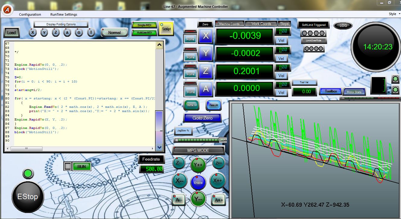

to go along with Arts recent Constant Velocity training video here is a square plotted at incremental angles, I was testing waveform consistency and that the pencil plotter tracked well at various feeds & cv settings.
https://www.youtube.com/watch?v=fKp5jbWVzUE
My code; run from the script window:
sleep(5); //gives me some time to get to the machine to watch.
Engine.RapidTo(0, 0, .2); //X,Y,Z start position
block("MotionStill");   // wait for it to get there
Z=0;
for(i = 0; i < 90; i = i + 10)
startang=i/2;
for( x = startang; x < (2 * (Const.PI))+startang; x += (Const.PI/2) )
&nbsp; {
&nbsp; &nbsp; &nbsp; Engine.FeedTo( 2 * math.cos(x), 2 * math.sin(x), Z, A );
&nbsp; &nbsp; &nbsp; print("X:= " + 2 * math.cos(x),"Y:= " + 2 * math.sin(x));
&nbsp; }
Engine.RapidTo(X, Y, .2);
Then this is a typical log file output, the X & Y are from my script print() function.
the Line : Vel:- , Accel:- &nbsp;-- Commanded - are from Auggies data stream using the current settings from my setup.

Ya-Nvr-No
Posts: 188
Re: Auggie Early posts
Post by Ya-Nvr-No »
Easier for me to create in degrees; &nbsp;;D
Z=0;
start_ang=math.degtorad (0);
inc_ang=math.degtorad (60);
fullpath=360/inc_ang;
acrossflats=1.5;
toflat=(acrossflats/2);
print(start_ang);
print(inc_ang);
print(fullpath);
for( x = start_ang; x < ((2 * Const.PI)+(Const.PI/fullpath)); x += inc_ang)
&nbsp; {
&nbsp; &nbsp; &nbsp; Engine.FeedTo( toflat * math.cos(x), toflat * math.sin(x), Z, A );
&nbsp; }
Engine.RapidTo(0, 0, .5);
8)
Note: MotionStill is a command that waits till the coordinates have been reached, pauses slightly then continues.
Even thou cv is on and radius is set to .01" in this next code example it acts more like exact stop mode.
&nbsp; {
&nbsp; &nbsp; &nbsp; block("MotionStill");
&nbsp; }
If i was having any more fun, Art would be charging me. ;)

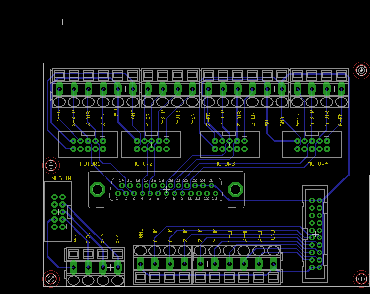

GlennD
Posts: 80
Post by GlennD »
Which pin are you using for the PWM output?
Looking at it pin 22 looks like the most logical.
Just making sure.
Glenn
Glen:
&nbsp; Unknown as yet, motion is done, but IO is yet to be implemented..next few weeks will tell...
GlennD
Posts: 80
Post by GlennD »
Thanks for the reply.
Look like with the free eagle i am out of room anyway, so will have to be a second board.
I should have the gantry moving on Wednesday, yea for vacation time.
Still not sure if i am going to run my G540 or the Chinese stepper drives, hence the configuration.
