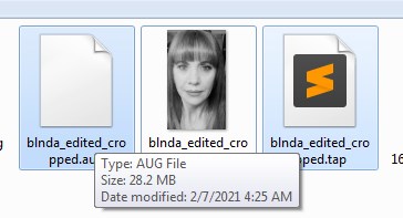

What i figure out is :
the .TAP file are line by line coordonates to engrave , nothing special
but Auggie generate a second file .AUG who store entire photo information like
all pixels " depends of size of you pic to engrave" and also  the value of that pixel
in 8 bit " i think" . In time of laser travel , on each pixel the laser will fire
with the power equal with that pixel value. I assume Art limit the pixel value at 100
or made the conversion 1*100/256 because pokeys will know only 0 to 100  . He know how is programmed.
If you will see , on any pic the .AUG file will have different size in close relation
with the pic size.
I can not tell how .AUG file are encoded , only Art know that and can be any language , even one
invented by him.
But the principle i think is not different . Art can correct me where i'm wrong . I'm a user like you are  :)

All True. And good explanation. Auggie has a pixel data for each pixel and scales it from 0 -100.
Then a formula is applied.  Output = (PixelValue * ( current feedrate / commanded feedrate))) * (power/100);
  If the current coordinate is not over a pixel, the PixelValue is zero.
Your PWM gets a command from 0 - 100, which gives you a PWM output. The voltage is actually always 5 volts during
on time and the frequency is always 400hz if set for that. But the average voltage is then 5vdc * ( OUTPUT/100);
  So if 50% is commanded, you should have 2.5volts.
  Most laser are full power on the PWM input when its 5vdc and go from there to zero. Many , like my sinrad need 1% as a tickle
voltage. It turns the laser on for 1-4us at 2khz which is my base PWM frequency.
You can explain please . Become interesting .
So basicaly can be way acurate result if i convert my photo before to generate with AUGS
on 100 pixels/cm asuming the min step is 0.1 to detect pixel value.
Or the detect is dependent of my setting . As example if i set like is default
0.2 step , that mean on 1cm of photo the aug will take 50 pixel informations?
That info should very useful , because can be developed a standard formula for any photo size with
perfect scan and maybe result.
Usualy i use low frequency for engrave , below 300Hz.
Bobby
Re: Understanding Laser Power Output
Bobby:
  Yes, that is correct. The system uses the # of motor steps as compared to photo size.
So the pixel to be burned is  (((currentpositionSteps - startofimageSteps) / length of image in Steps) * #ofpixelsinline)
as to what pixel will be used for power.
  Power will then be  (Current1msspeed / FullFeedrate1msStepRate)  * (powerslider% or spindleRate%) = PWM%
This is done every 1ms as to position and power. You can literally make sine waves over an image
and only the image will burn , and in a sinewave raster.

ArtF wrote: Bobby:
Hi Art.
So in that case the PWM should be strict in 1000 multiple otherwise can search the info of pixel between
and will ignore probably. I dont think i folow you with .....
And about sine waves you mean , white sine waves over a photo , right?
Bobby
Bobby:
  By sine waves I only meant one could do graphs of x,y sine waves as a raster and the image would appear.
It doesnt matter how the motion occurs, as long as the head is moving in G1, and inside the bounds of the
image the laser will at pixel burn rate.
  As to the 1ms rate of update, thats simply how the Pokeys works, I send it the motion for the next 1ms
and the power for the next 1ms. If you cross 10 pixels in 1ms, you will get the average power of those
10 pixels.
