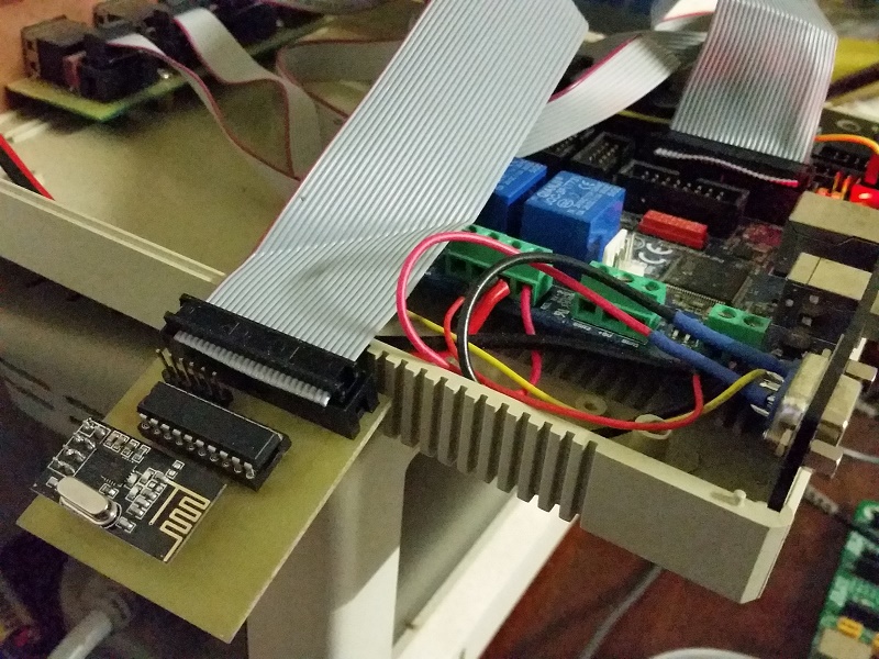

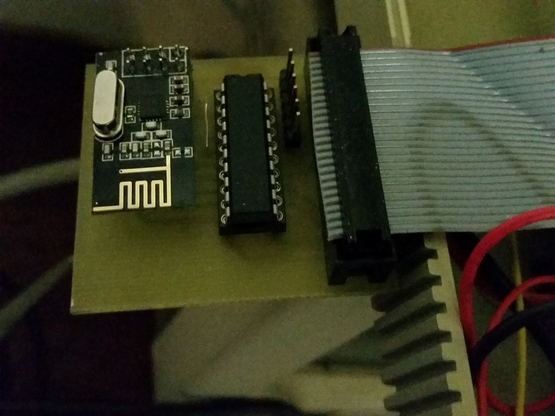

parts arrived for pokeys end . its behaving perfectly on the bench .
decided to calibrate the mpg to match the 100 indents per turn it has . its now set that 1 click is 0.1mm on slow and 1.0 mm on fast. will see how that works out in real life.
still waiting for lipo battery and usb charge manager to finish the job
auggie with mpg

just tried it out on the k40 , it works just like a bought one !
0.1 mm steps @ 900mm/m is ideal for positioning the laser , 1.0 mm steps @1800mm/m is way too fast for the k40 bed .
0.01 might be needed for touch off on the mill .
i have set the mpg up to have 3 axis's, each can have its own steps/mm setting stored in eeprom , with a built in setup menu.

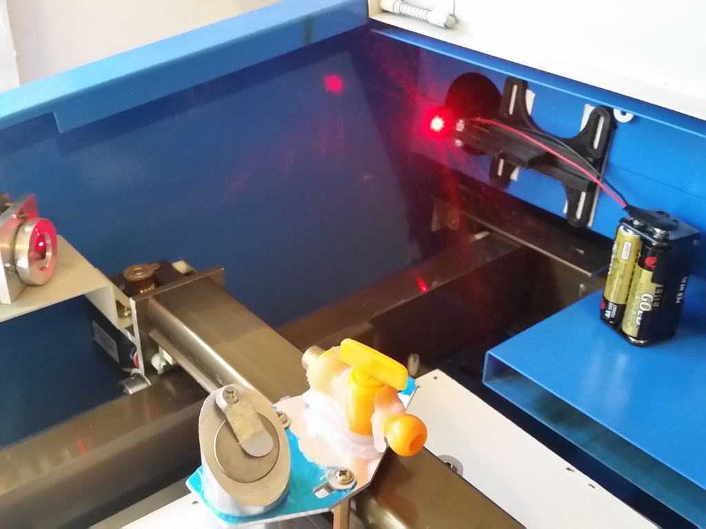

main reason behind this project was to make zeroing laser to the work easier . unfortunately just noticed that the laser test fire button is inoperative when mpg mode active , kinda defeats the purpose . defeat snatched out of the hands of victory.
now I need to build a red dot system too, unless anyone has some bright ideas

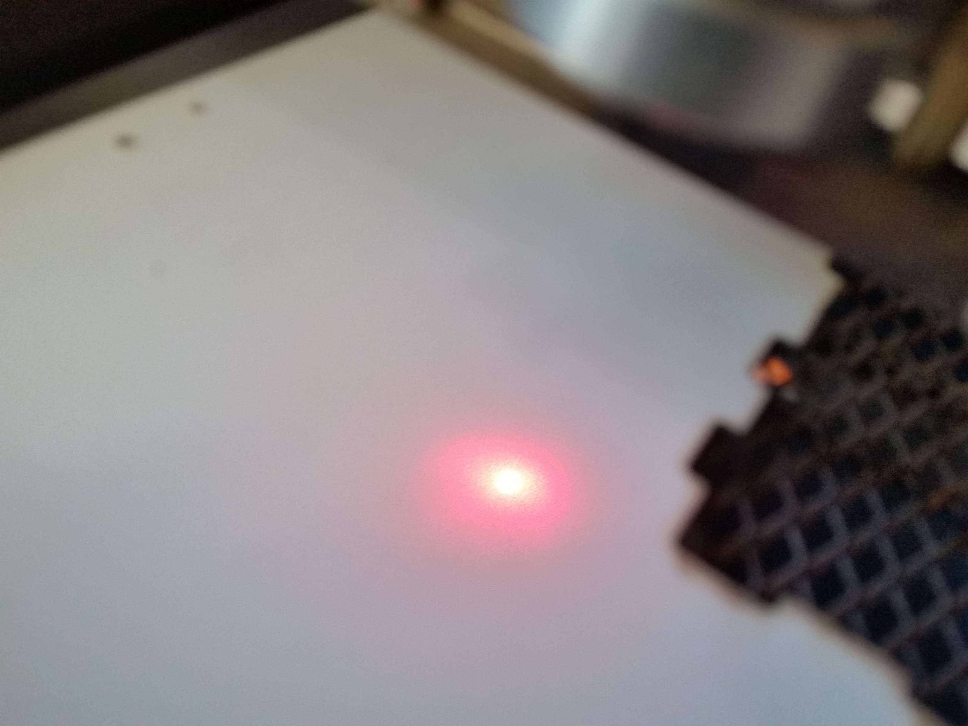

built one of these as a test , it works nicely but manually
https://www.thingiverse.com/thing:2560096
the pictures don't do it justice the dot is really small and sharp ,easily defined .
now for a automatic depoloyment system.

one benefit of the visible loc laser is it makes mirror alignment dead easy.
