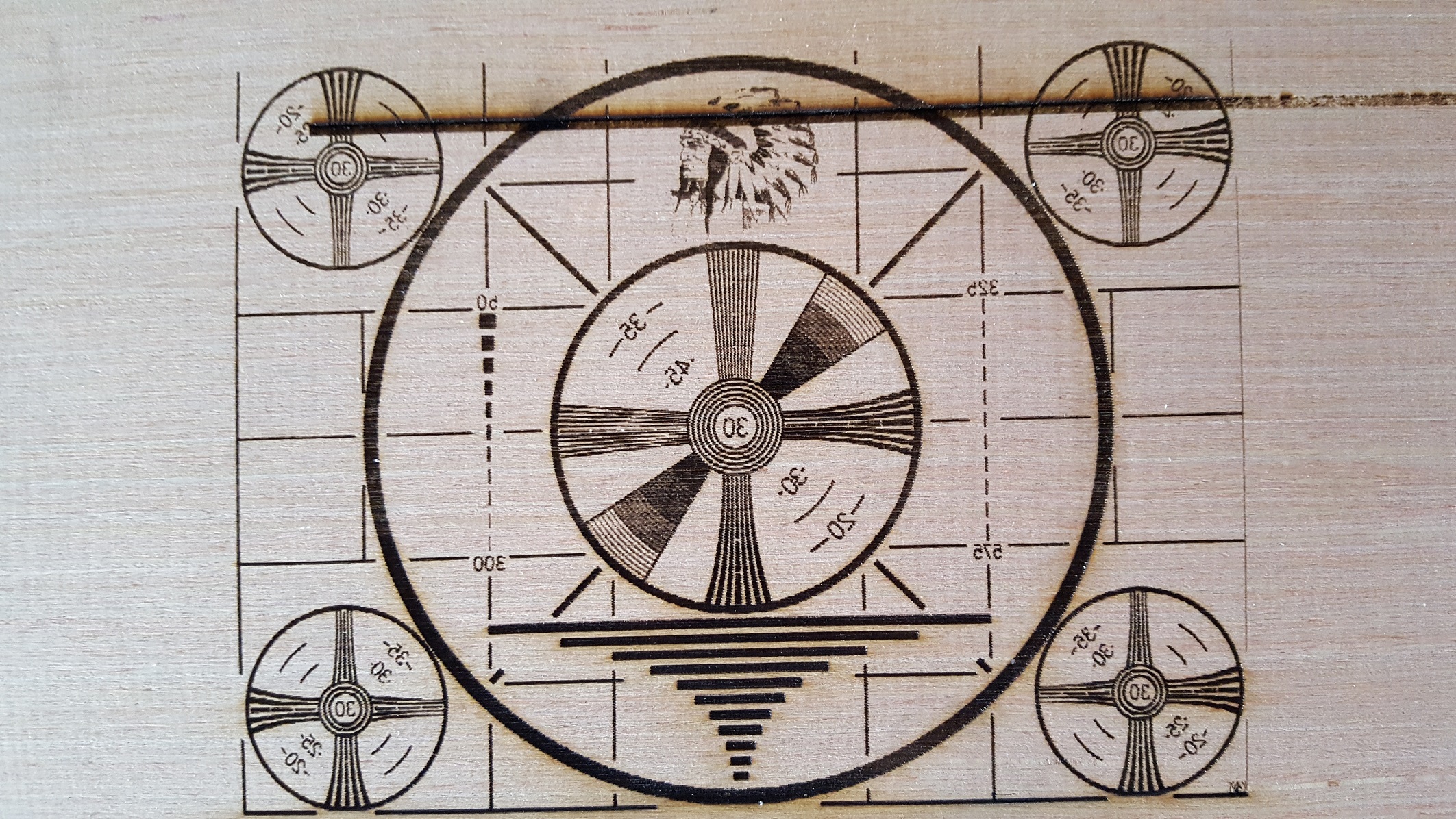

I used stock settings in Augs, I only set the output size to 150 in X.
Started at 47% laser power then put it down to 28% on the laser power after a little bit of running.
Not sure if it picks up the changes I am guessing it does because it didn't seem to be burning as much.
I had 2000 in the feed rate but it sure seems slow. Run time 50 minutes
Every once in a while the motors makes a noise and it kind of jumps but as you can see it didn't appear to loose steps.
I cant rule out the laptop it wanted to do more updates.
Glenn
The extra line in the photo is because this was a scrap piece of wood that I was testing an LO-R5/RDworks with.
Glenn

Awesome...
First laser image other than my own. Good quality as well. So it seems your fine at 1ms control, since I can see 4 grey
levels in there, ( and thats all there is in that image.). This means your laser is running a fast PWM just fine. If 28% did
that at 2000, you can probably do 6000 easy at 90%..
The system shoots that selected 28% only when the axis is doing 2000feedrate you selected. And it is realtime, it adjusts as
you do.
Small steps though.., great job, I appreciate the confirmation, this photo shows a lot about how the
process can work. TTL can be left on, and PWM will control on/off fine.
you do.
Thx Glen,
