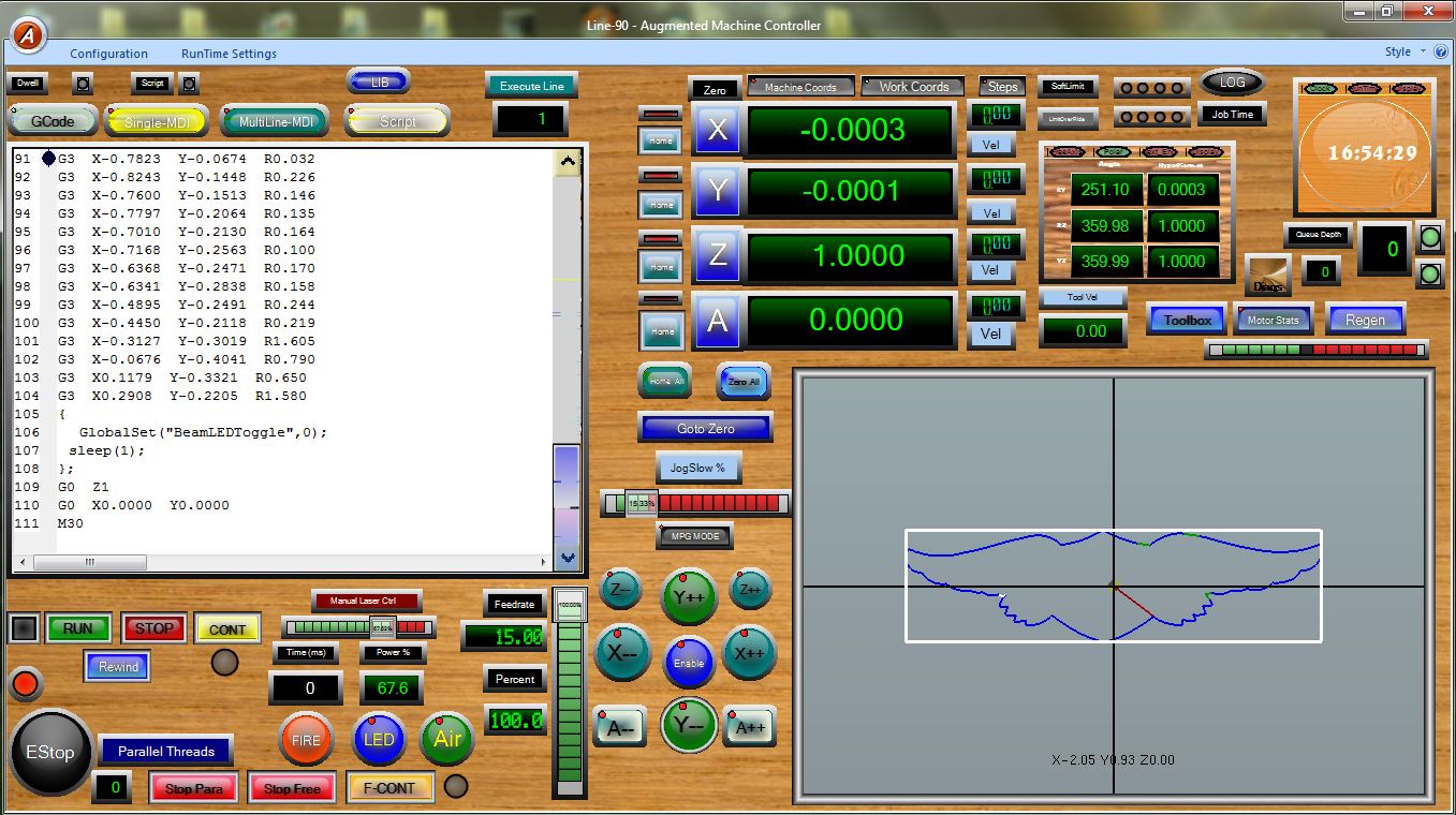

here is real short video of auggie running a SpiroGraph, shows on the paper the led red beam I use for testing and alignment. :o
running at 2300 inches per minute in X and 700 inches per minute in Y
https://youtu.be/g1uzHxJrlKs

Another quick video of the cylinder raising turning on the led test beam and showing the outlining of the Harley wings.
You might beable to see the reed prox switch on the air cylinder I'd like to see if I can determine position of LED lift station.
Gcode script inserts
GlobalSet("BeamLEDToggle",1);//sets the button state, that toggle raises the cylinder and then turns on the red led.
GlobalSet("BeamLEDToggle",0);//sets the button state, that toggle lowers the cylinder and then turns off the red led.
then as an EStop safety I added the commands in the "Library SystemCallBacks" to toggle the button states to off, turning off the laser library controls if they might have be set on.
global OnDisable = function()
GlobalSet("AirBlowToggle",0);
print( "--System -- System Disabled.");
https://www.youtube.com/watch?v=KEoRbCoDFdE

And heres a video showing the Jerk settings and how they affect "my" system,
said hat way because your numbers will be very different.
But as you can see, the axis accel are set too high for them without
jerk limits, this allows for very fast acceleration after the initial SCurve.
The only thing changed in each run is jerk limit, this shows that
to tune the system, you really tune two things, accel, by setting it high enough
to allow fast takeoffs, an the jerk to set the takeoffs smoothness. The lower the jerk,
the smoother the motion, and the lower the speed average. The first 2-3 runs do not hit
1100 inches/min, the rest all do, tuning Auggie is selecting that which works best..
https://www.youtube.com/watch?v=s7lWyoA ... e=youtu.be

there was a very noticeable effect between each setting 500 to 5000 big differences then a small amount then bang bang last one 150000 looked good
