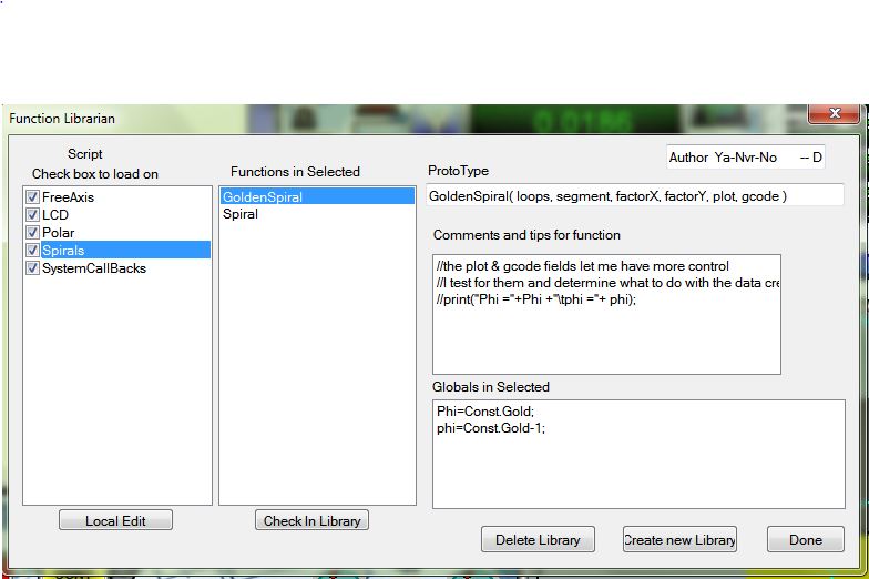

This is where we hope to deposit and grow a vast resource of Library functions.
Remember all library's have to be in the "Script folder" and the library name has to be found as the "Script" name the "folder" it is in and the "header line" must have all the same name.

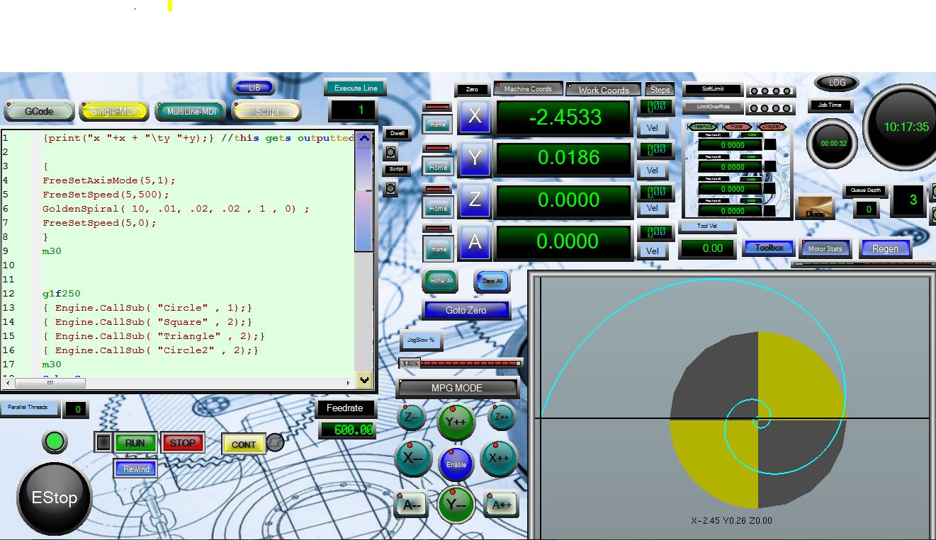

here tested in the MultiLine-MDI fold, I use the #5 pokies axis as a spindle turn it on and sets the velocity to 500 * steps per unit.
FreeSetAxisMode(5,1);
FreeSetSpeed(5,500);
GoldenSpiral( 10, .01, .02, .02 , 1 , 0) ;
FreeSetSpeed(5,0);
m30

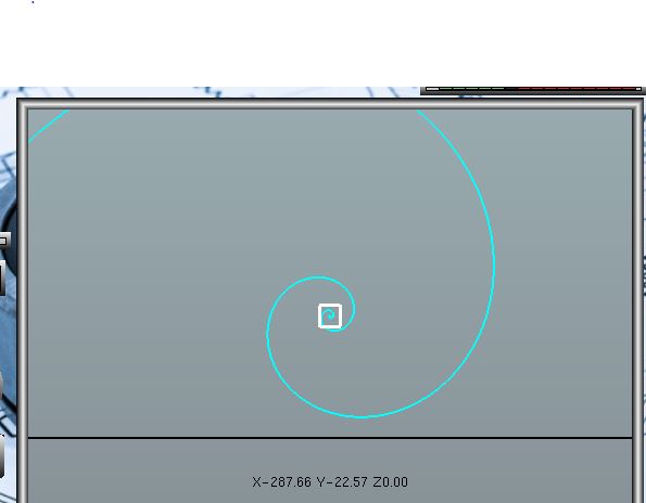

The images are from the above code. I only controlled the GoldenSpiral for the additional control but wanted you to see how passing info to a function can then be used for condition statements.
and the last image was from my original test, notice you don't have to pass the conditions as they are set by default.
GoldenSpiral( 10, .1, .01, .01 ) ;
The bonus here is you can checkout a library script make changes, hit run then go test it while its still checked out. If all works and your happy check it back in. (note: watch the toolpath display for messages of errors and go to log to see what line the issue was on)
1:14:373  error (32) parse error, expecting `'(''
in this case it was a typo on line 32 of my library script

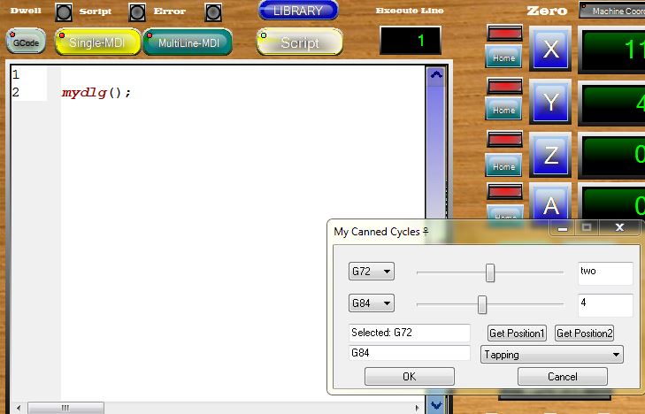

Starting testing on a new feature called Dialogs
shows how to use textboxes, tables, buttons, sliders, drop downs, and how they all can interact.
DialogsTest.zip
(1.48 KiB) Downloaded 363 times
