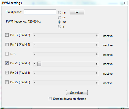

Hardest part was getting the pin number. I apparently wanted badly to use 20 as the pin number. To bad the Pokeys value was staring me in the face the whole time.  :P

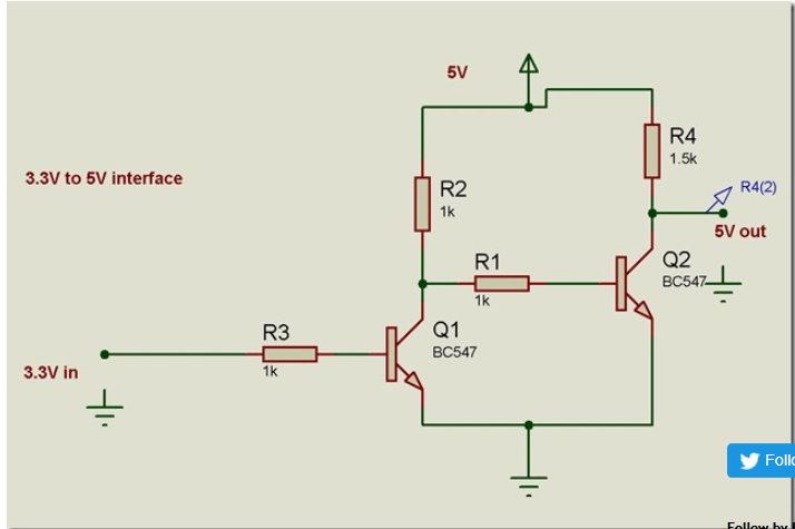

I am using a couple of MPS2222A NPN transistor to get the volts from 3.3v at 100% to 5v at 100%
Circuit attached that I followed.  All of this is not in a running machine yet but works on the bench.

Edit: The setting show on the PWM page in Pokeys gave a 2.55 volt reading at 50% and appears to be very linear.
