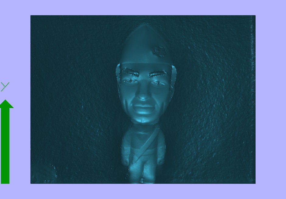

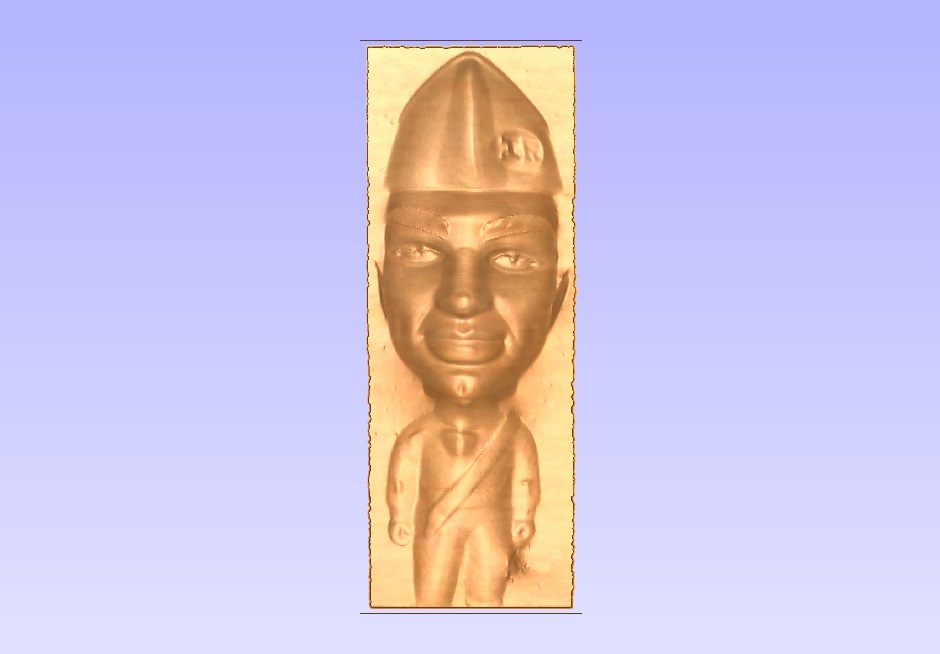

hi art did not see your reply did some playing with a black back ground so much better the area around what I did images off is single colour and flat.
I will add images of result from cut 3D
a is same settings as before as a negative, 3 is image
Re: WebCam Data
lol.. Those look cool..

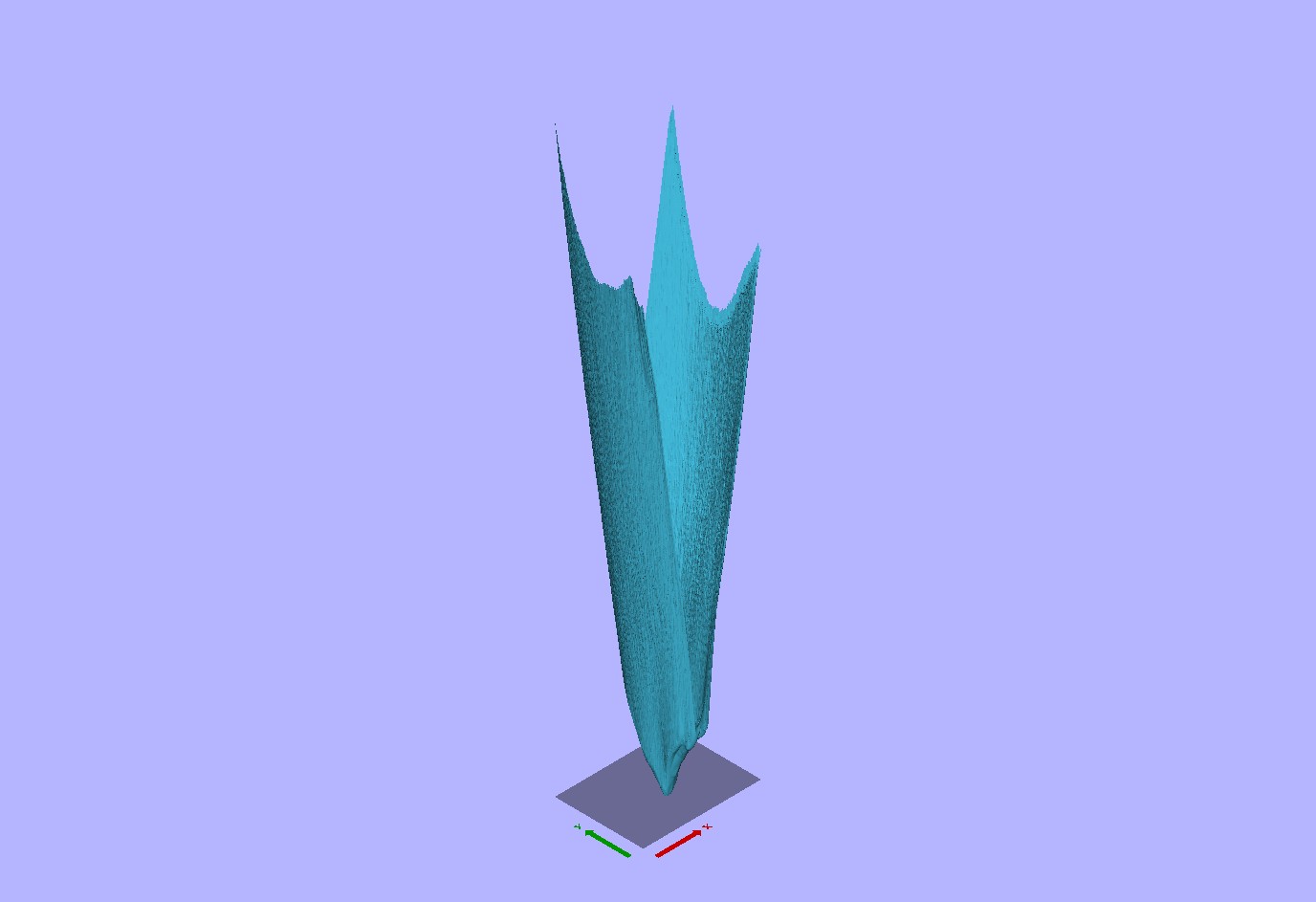

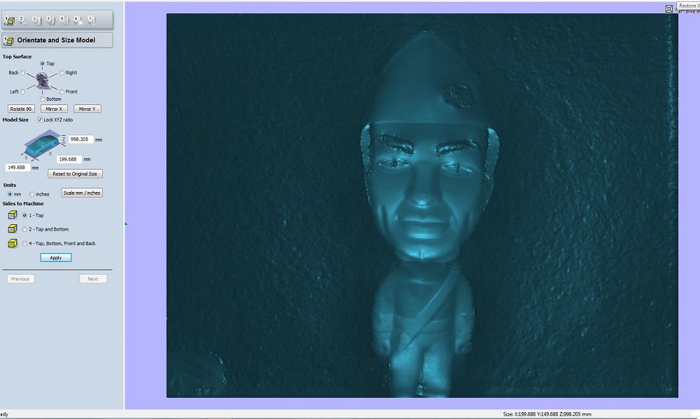

I have run in to a big problem the X and Y are the same as the aspect size but Z is coming out as just over 3 meter in depth I change x to 200 it goes down to 1 M
Re: WebCam Data
  Wow, those are pulling out nicely.. just lower your scale slider, it should lower back to a reasonabel pull, I aim for about 150 as a good scale.. but it varies from data to data set..

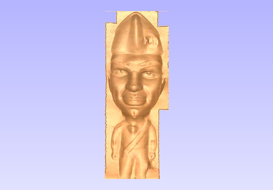

Hi art moving the slider down to 1 leaves not a very good image, having it set to 2.5 is a lot better but it has a 80 mm curve ever negative or image it`s all the same.
so the scale of negative to image is good
but the curve is way to much the whole image will be curved cutting the side of helps a little bit.
I have tried a flat black back ground it make`s it worse bigger curve.
A flat white back ground is better, between black and white is 200 mm
it would be good if you can reduce the Gradient scale so if its at 10 it would be 1/4 or less of what it is now but keeping the image just as good or have it how it was in the last version I tried the one on your site had barely any curve to wear there was a flat back ground sorry to be a pain
picks 1 is negative, 1 on gradient scale pick 2 is negative, 2.5 on gradient scale, picks 1a, 2a is image same setting`s
threshold is 0.1, zero noise gradients is un ticked, ambient correction same, fullres resolution is 176 x 144 yuy2--format 2
