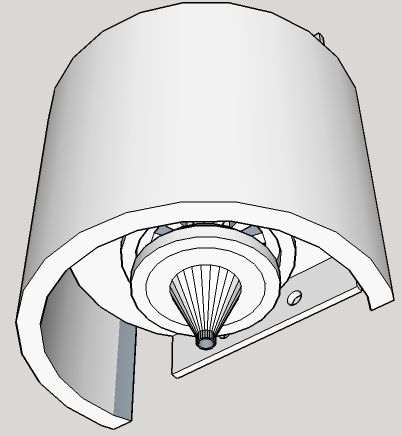

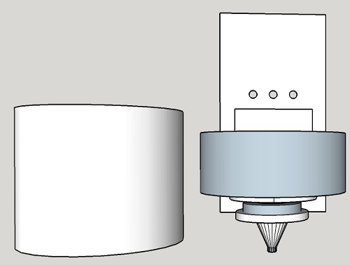

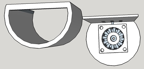

This is how I think I will make the head and heat sink for my laser
