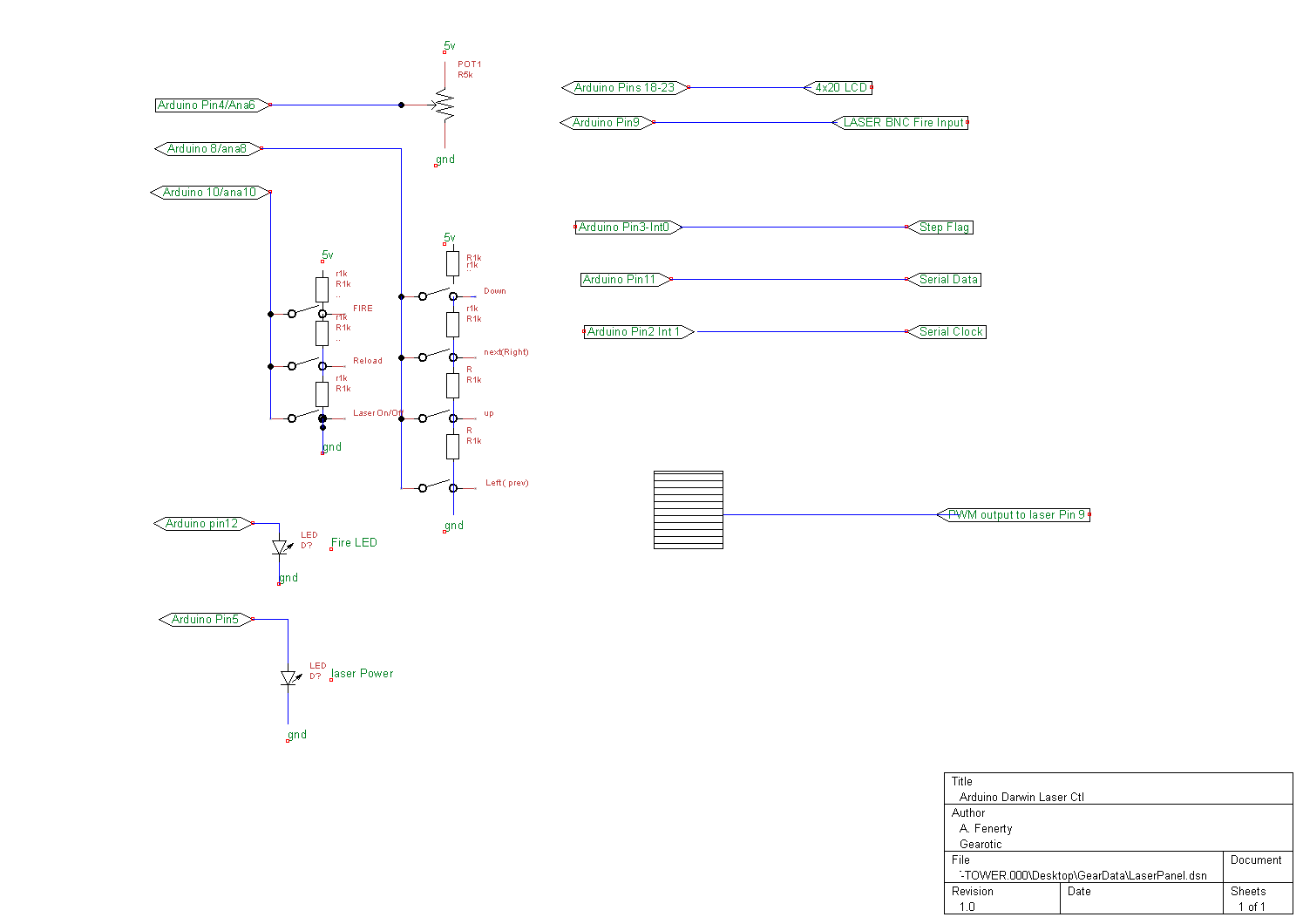

My problem was simply to get laser power to a laser, but at the same time I had to control a very accurate
tickle pulse, Perhaps software could have done it all, but it occured to me that these things called arduino's
may be able to help and make the solution to my problem acceptable for other problems.
I may as well admit now that this was my first arduino project, and my first arduino program. So dont expect
any fancy programming skills to be shown. BUT, the fact I could code this arduino very quicky to do what its doing
should clue you in that you could do such a project to use the same data for many other things. (Or just simply
copy my code and build a laser panel..should you have a laser. :) )

A leonardo is about 20 bucks each. The total laser panel as I built mine, comprises
1) Leonardo : $21.00 (Yun: $79.00)
2) 6 buttons : $2.00 total
3) 1 led ring button for fire: $2.00
4) about 6 1k resistors $1.00 ( 10k or even 100k resistors should work fine.)
5) 4x20 LCD display $6.00
6) 5k pot for laser power control
7) A box to put it in..
I built my box from scrap wood, and used plexi on the front as a faceplate. So the whole things is worth about $30.00
or so without wiress and around a hundred with. ( Although chinese Yun's on ebay are abotu 13.00 each.. dont know

Since all that was fairly new to me, I decided this panel I was building had to have a diagnostics mode where I could
dial up a pulse count, power level, and set a frequency , and then, by pressing a flashing button I could shoot that
exact amount of energy at that frequency to measure accurately laser's affects on various materials. This is all much
too complex to do from a printer port accurately...so enter the arduino. Never having used one before, I had heard it should
have enough power to do what I needed done. BUT , I really dont want to redo my breakout board on my robotic arm, so it
was decided to build an arduino that simply hooked to 3 spots on the cnc's breakout baord. From those pins we'd make
sure the tickle was accurate, and photos could be engraved as well as vectors..

What the arduino does internally::
Well, as the video in the last post shows the panel itself,before building one we just need
to know what its doing internally. Let me point out that the point here is to make a device that can take
power and fire commands from mach4 with a time dependency that allows a laser or impactor or whatever
to do its job. There's a lot of microprocessors available to do that kind of thing, TI's launchpad,
Arduino's, beagleboards..etc, and I woudlnt rule out building another panel with another micro at
some point. Hopefully by that point more a few of us will be getting commands from Darwin.
The software in the arduino isnt very complex, as my first arduino experiment you can imagine that
it wont be up to a knowledgable arduino programmers level. One of my hopes here is we attract such
people or we learn together how to do this better. Also worth noting is that while it was important
to me to have a diagnostics panel at the machine for testing and calibrating future engravings to the
material at hand, you may not want a diagnostics mode at all, and if so, just a simple arduino with
no box, buttons or LCD display would work fine, the program would simply require a bit of recoding
and you could hot glue the arduino into your cnc control box to permanently control your laser power
with no interaction. Point is.. there's lots of room for altering what we're doing here.
So.. that having been said, whatever controller we use, (a leonardo in this case) has the
primary job of supplying PWM to the laser. Synrads require ( as do many others) a 5khz base
tickle frequency at 1us. The leonardo has a complex timer chip in it with envelope outputs, this allows
us to program that chip to do 5khz pwn with 1us pulses as tickles.
To make any specific pulse longer than 1us ( up to the full 200us of the 5khz period..)
you simple change a register. In our case thats OCR1A , a register that sets the duty
cycle of the pwm. this is all really hardware so its very accurate and controllable.
So we then need to change it on the fly. SO I turned on an interrupt that the timer can generate
at the beginning of every period. In that interrupt call, we calculate based on current conditions
what length (duty cycle) this upcoming pulse should be. If we leave it at 1us, the laser will
not fire, but from 3.5us to 199us the laser will fire fully for that time frame. This then is what
we consider varying power, in reality the power is always at 100% but at varying lengths of time.
As the video shows,I didnt want the laser to fire all the time. SO a second interrupt is hooked up
to the StepFlag output of Darwin which gives a pulse whenever a step pulse is put out to any motor.
We have then, two interrupts going on so far, a timer interrupt that triggers at the start of each pwm
pulse, and a Step interrupt that happens whenever a step is taken. Now the diag mode has a fire button
which when pressed fires off a set number of pulses depending on what one selects for count.
So in NGrave mode, the interrupt on the step flag reloads the pulse count( usually set at one) and
internally presses the button. This makes it fire one pulse. As the CNC unit moves, each pulse
resets the counter to its setpoint and tells it to fire. The laser fires once and does nothing until the
next step pulse. Youd set higher pulse count numbers to cut materials and can use frequency and pulse count
settings on the panel to control charring or overburn in various materials.
So that leaves us with just needing a way to get the power of each shot. For that Darwin now has a clock
and a data output. When Darwin sees your in Laser mode, it will constantly send a stream of power
data, if the spindle is off it sends zero's.. if spindle is on it sends the last SWord.. ( 0-100%),
and if a photo is linked to Darwin, it sends the grey scale of the photo point in the spot
the axis is at currently..otherwise zero. The Data clock runs at full kernal speed, so 30khz on my system,
so to be sure the arduino doesnt miss it, it uses another interrupt. This means we have 3 interrupts
running constantly in the arduino to sync output to whatever Darwin is doing. This leaves most of the
complexity on the PC side in Darwin. If not doing a photo, Darwin calculates a TOF(Time of flight)
for your vector line, calculating a power level for each set of steps to maintain a level amount of power
throughout your motions.
So thats it really, not very complex, and from a programming standpoint not very hard to implement
so far. Ive cut many photo's and each is an interesting lesson in power vs speed vs output. :)
Ill post the arduino code here later this week, Im happy to help as well if anyone has questions
about how this all works, or has ideas for other ways to make it all work better.

That makes a lot more sense to me now. I never did more than a set of digitalOn/DigitalOff and sleep for a few us to get the pulse. I never fooled around with the OCR1A register.
How about posting a snippet of code that does just the tickle so I can try it for myself while I wait for the rest of it?
Hi Sky:
TO do that Im using a PWM library for the leonardo..but.. it was set to do only phase correct
PWM, in that mode if you change duty on the fly it creates a double pulse... so I modified the
library by changing the control bit to be FastPWM.. So if you use the library the following code
will allow one to control the PWM duty cycle on a pulse by pulse basis.
(I include the PWM library as the one I modified). Ive modified a coupdl fo the system files for
this project.. so just be aware when I post a library it may or may not match with the Arduino libraries
as released.
#define PulsePin 9
setup()
bool timeron = SetPinFrequency( PulsePin, 5000 ); //set pulsepin to 5Khz, modified for fast pwm mode
//this turns on the timer interrupt so that duty cycle can be set pulse by pulse..
TIMSK1 |= (1 << TOIE1); // enable timer overflow interrupt, we'll use this one for firing the laser if a fire is called for.
//this is the slow way of setting the pwm duty cycle..
pwmWrite( PulsePin, 16); //set for 1us for laser tickle , never go below this and tickle will be all good.
//this is a decalaration of an interrupt to be called at the start of every PWM period..
ISR(TIMER1_OVF_vect)
//I keep track of the PWM periods as a way of coordinating power in other code
cnt++;
Duty = FireLaser(); //find the next power level..
OCR1A = Duty; //this is the fast way fo changing the upcoming duty cycle period.

I dont normally draw schematics, so forgive the poor quality. Here is the wiring of the laser
panel, as you can see its pretty simple, just a few buttons, an led and a few wires. Not shown is the
5vdc and 0vdc wires connected to a breakout baord or external 5vdc power supply. You also need to hook
the negative of the 5vdc t0 the ground of the breakout board..
(Schematic Modified Oct 1/2014)

do you think it might be "safer" to put 47k pull down resistors on your analog button reading pins ? . I'm assuming you have weak pullpowns turned on but a noise spike on the fire button could be nasty.
Hi Richard:
Noise spikes typically have very little current capability behind them, but with 1k to ground as worst case
button press we get about 5 ma in normal operation, the pin will only source about 50 ma I think.. so even if the voltage
on a noise spike got to 50 volts, you'd still be at max about 50ma and even then for so small a period that actual power
dissipation would be too small to care about. Induction of enough power to hurt the arduino would be near impossible
on the button lines, so 1k is likely more than enough. Feel free though to use pretty much any resistance you like as
its truly not critical in this type of circuit. Its more about the ratio than the actual values.. I would worry about too high
a value making the circuit a bit more susceptible to noise.
(All just my opinion of course, I make no pretence at an engineering degree. :-) ). All that having been said, those are
the reason I picked those values, and since you ( or anyone) may know better than I, please use any values you might
calculate and let us know. Id worry on 47K though ( if used on all pins ) that youd then max out at around 200K for one of the
button presses and with that low a current flow noise could give wrong indications. ( 4.7K perhaps though)
The reason I state ratio's are more important than values is simply the code gets easier if all values are the same.

So too high a value could in theory make the buttons a bit less responsive or error prone, and with a fire button as one
of the buttons in the loop I figured Id keep it as reliably set as I could in terms of returned analogue count.
