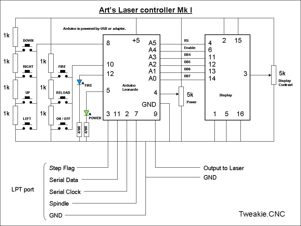

If it?s any assistance to others that follow with this project I have redrawn Art?s circuit diagram to show the interconnections and pin numbers shown on my Leonardo.
EDIT Circuit diagram updated to include series resistors for LED's

Wow.. Thanks Tweakie, that looks awesome...
Thanks Art.

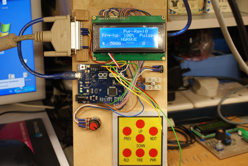

Well I have built it but I can't get it to work - no laser output pulses (except for the tickle pulse ?) :'(
It's got to be something really silly that I am doing wrong but so far it is eluding me. ;D

Tweakie:
Wow, thats looking good. Ok, lets debug it one step at a time and see where
Ive screwed you up..
Lets get diosga running, its the easiest test just so we know all else is running..
Test 1 for any panel: Does it fire in Diags mode?
1) Set to Diags, set count to 1000, ( 1/5th second).
2) Run button LED should now flash ( if box has one.. :)
3) Pressing fire should count down , PWM should go to power set by the pot.. 100% for test
4) did laser fire during count?
Ok course, being Tweakie you may already know the pwm firing section works, I ask the above
only so future new users will see an initial test responce..
Second test, NGrave mode. For this Darwin and Mach4 must be setup correctly.
This you will know if the following is true.
StepFlag pulses everytime any motor does a step. Doesnt matter what motor..
Serial Flag also pulses every time motion occurs. This doesnt match step by step,
when a waypoint is sent to Darwin, the serial clock will pulse 16 times each time
changing the state of the Serial data on each pulse...
Test: Set Darwin to Laser mode in the diags menu of mach4 under darwin. This turns on
the Laser outputs. Ensure Serial clk, serial data and Step flag are enabled and on proper pins.
Setup a PWM spindle in Mach3 and darwin, set it to frequency controlled in Darwins config at 25hz
what you set the frequency to doesnt actually matter in Darwins config, the diags setup in Mach4 will also
ask a frequency and Darwin will fill in the rigth hardware frequency then.
So in MAch4's diags menu setup for Darwin turn on PWM Spindle. Set it to 50hz. In Mach4, set the spindle range
to 0 min and 100max. Set Motor max rev at bottom of tab to 100. (all this is for power scaling).
Execute a S100F1000 in the MDI, then press the SpindleOn button on the screen or execture an M3.
The lcd in the panel should now show 100 in the REM: in the upper rigth corner indicating its getting
a spindle power of 100 currently. It wont shoot till it moves, but the power should show up as 100%
Lets trouble shoot from there.. :)

everything working fine for me art I just need to change the pot to a 5K instead of the 10k I have.
pin 9 output is around 2.5 to 3 v so its just half of what it is meant to be
Doesnt work that way.. Pin 9 is a PWM signal, so if its set to 50% you should read 2.5volts or so.. if set to 90% you should see abotu 5 volts. Changing the pot would do nothing to the voltage. 100meg or 100K..doesnt matter, it just tells the arduino what timing for the PWM to use. So while a scope is what should be used to look at pin9, you can use voltage , just consider it a voltage of 0 - 5 volts in 100 increments of the power pot ( in the case of diags mode when firing..).
ok there is something wrong then, the 2.5 - 3v is with darwin set at m3 s100 and pot at 100% the arduino scope I am using does have volts and pwm I will check again just to be sure I am correct
In Diags mode, at 100% and CW selected as count, ( constant wave), you should get between 4-5vc measured on pin9.. a pwm of 200us in period, and with no fire command you should see about 1us pulses, that go to about 190us pulses at full power..
Generally though, if you see the voltage go up quite a bit when you press fire, then its probably working fine..
